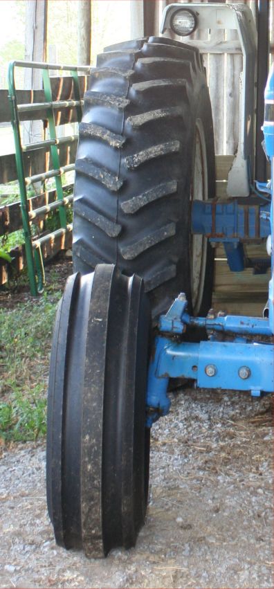

No worries there friend, look at the tred on those tires:
No way I'm replacing them until I have to, even if I had the money I'm way too tight. I will however be careful with them. Like a dog with 3 legs, you learn how to get around in your situation as if it were normal. That caution will likely serve me well in other areas as well.

   / Breaking in my new toys... from Yeehaw! to Uh oh! #64
Spivey,
The first number is the section width, the second number is the wheel diameter. (The steel part) So, a 16.9 - 30 is 16.9 wide and is mounted on a 30 inch wheel. The overall height, you have to look up. Can't determine from the numbers. They do try and keep the tires all about the same height (about, not exact) for the same wheel size. So an 14.9-30 and a 16.9-30 are only about 1/2" difference in overall diameter.

I used to put 4x4 but was repremanded in the fact that the tire sizes aren't the same, so it's not a true 4x4. So I use the PC correct term of front wheel assist or FWA for short.

jb, I figured it was something like that. At least it makes sense even if you can't get exact dim's from the numbers.
sandman, FWA DUH!!! :rolleyes: I knew that one, if I'd seen it in an ad for a tractor, FWA I would have known it. I think the caps help too! I was trying to figure it in context and nothing made sense. I was thinking, filled with air?? But that didn't make sense. So now I'm curious, why would FWA make a difference in me doing anything with my tires relative to the BB being too close?
   / Breaking in my new toys... from Yeehaw! to Uh oh! #67
Nothing, being concerned with a different tire size only if you had FWA, in that the tires need to rotate at the same ratio as the opposing axle. If someone changed out the rears and didn't change the fronts, you would have excess strain on the driveline.
There isn't anything wrong with your tires, other than not having any hours or miles on them!
Get busy and wear them at least past the "****" on them.

HA! Cracked me up on that one!! :D The dealer put the new tires on the front, and I mean brand new, "****" and all when they rolled it off the trailer. Rears weren't far off. One of the first things I did was drive it 2.5 miles down the road to show my papaw. I wore off a ton of rubber on the road down and back compared to anything I do on the farm. Those things will last a long freaking time driving around on my soft grass, :) but I'll do my best to show some "respectable" wear. I guess this is the equivalent of the dork in school with the shiney white tennis shoes huh? No one will take me seriously until I put some hours on those suckers. :D
By the way, got a wild hair and actually checked my manual. They do list 18.4-34's in the manual for my tractor, but they are the largest size listed. :D 1,080 lbs loaded.
