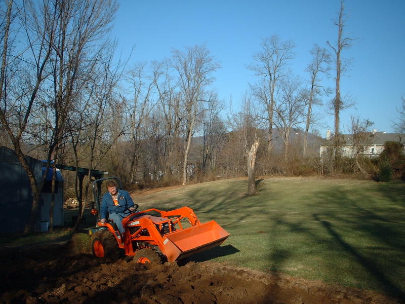

Mine is the Lienbach #19 which is a 1-12.
After mounting it on the 3pt it was just as matter of centering and off to plowing/w3tcompact/icons/smile.gif But if I hadnt moved my wheels in last summer i would of had to do it to make sure the plow fell to just the inside of the rear tire.
The plowing was great but with all the rocks up here I dont think the tractor would of handled a 1-14. Man I didnt realize how big some of them rocks was till after we got that much needed rain/w3tcompact/icons/smile.gif

   / Breaking in new plow #14
Devildog
You have some guts posting pics of YOU on your tractor /w3tcompact/icons/tongue.gif
I don't have the courage (or the photogenics) for that.
I'd prefer to show the good side of me and my tractor, and that is the tractor /w3tcompact/icons/laugh.gif

#15
LMAO@ Neil
Neil when the better half snapped them pictures, I was LMAO cause it looked like an elephant on a mosquito (LOL)/w3tcompact/icons/laugh.gif
