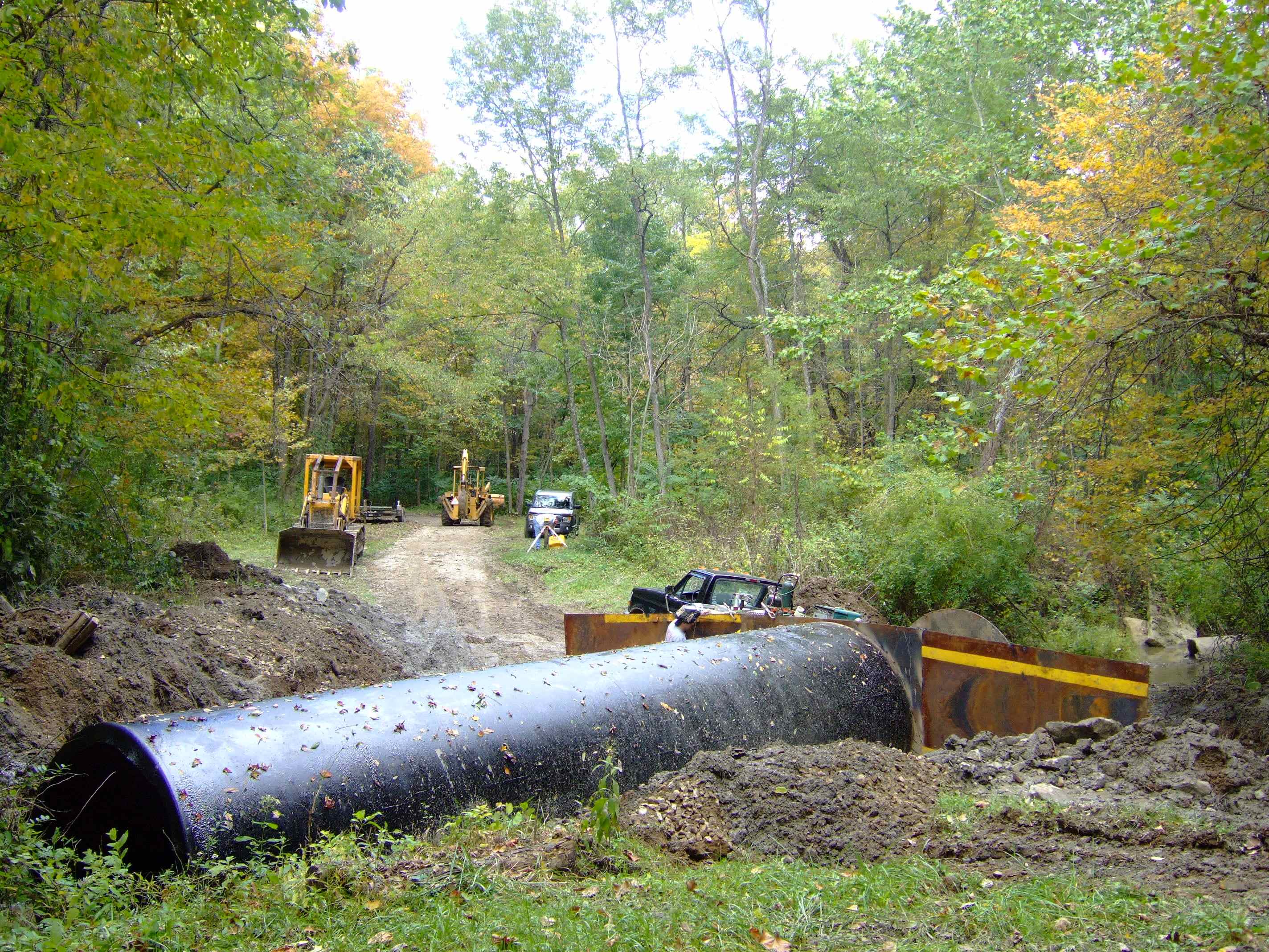

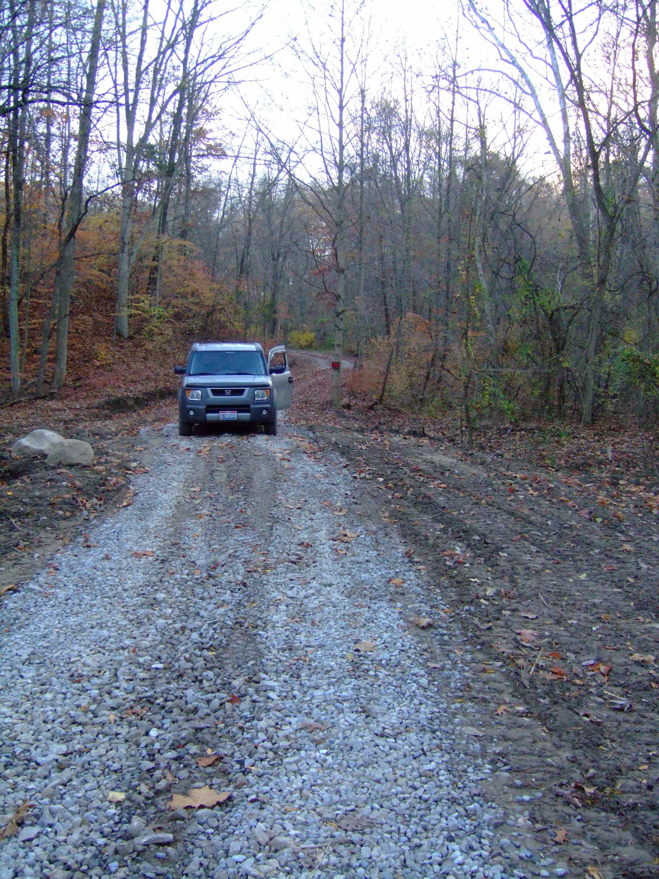

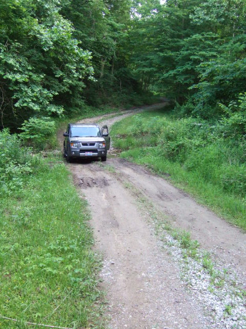

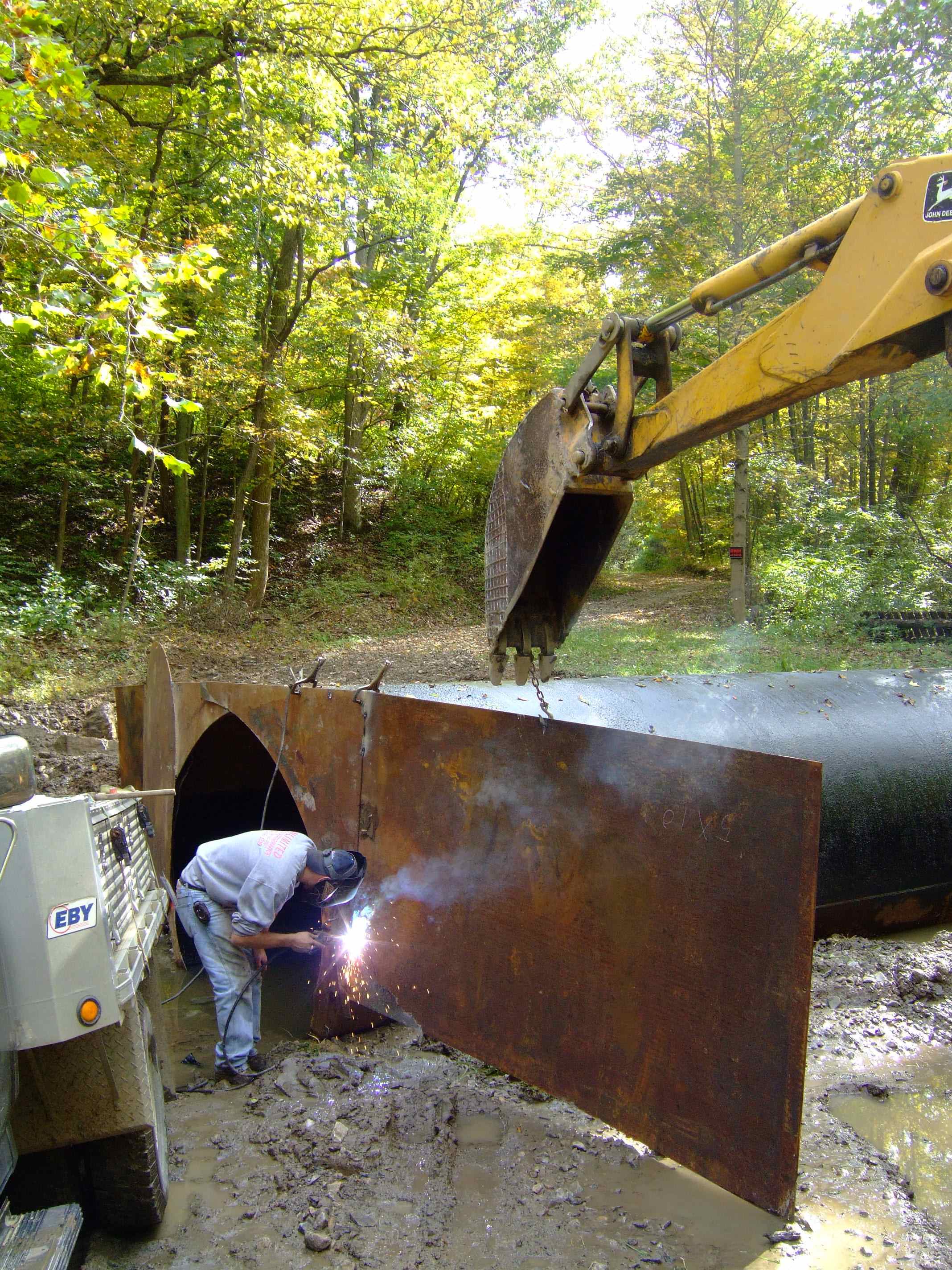

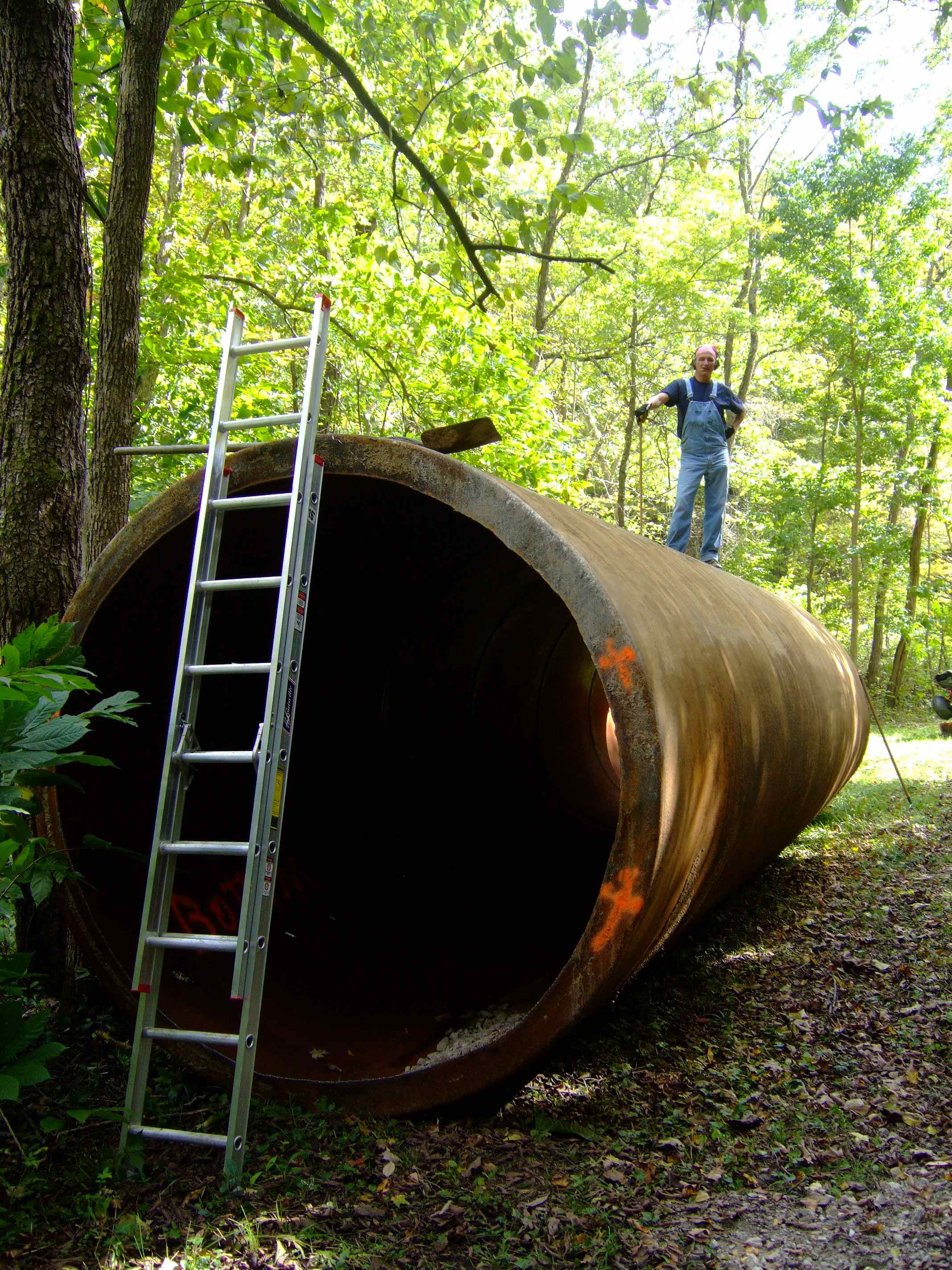

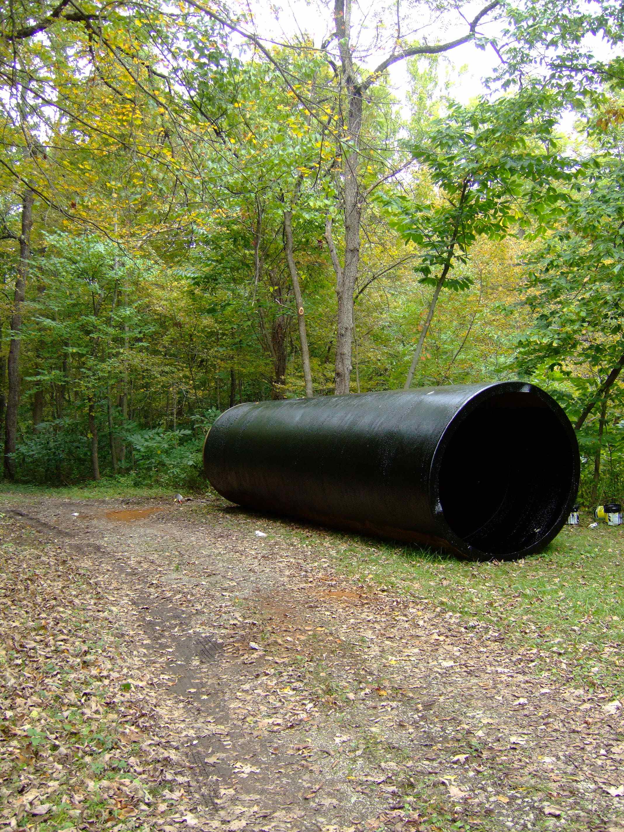

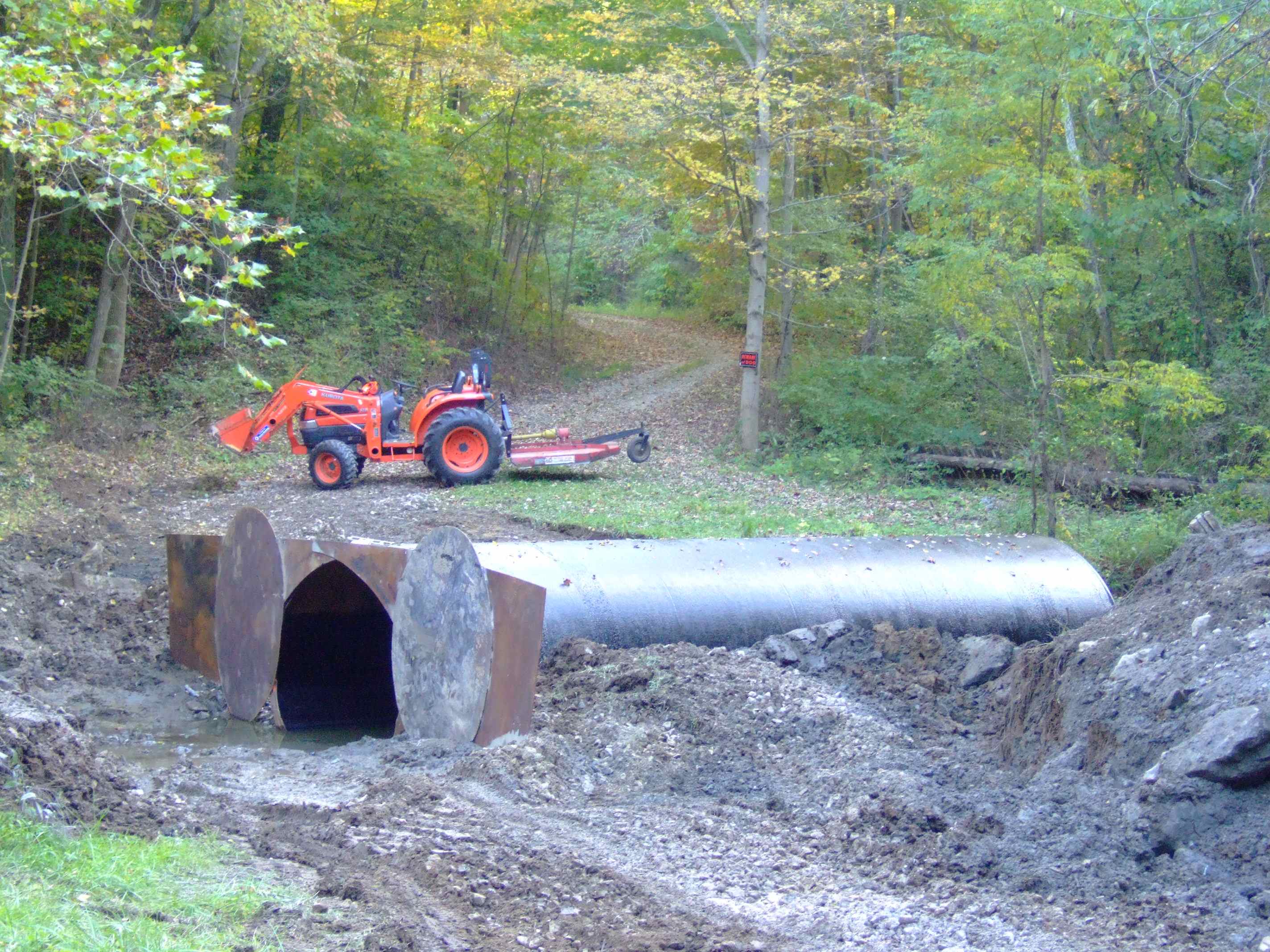

I had a very similar challenge at my place. After a couple years of hand wringing and talking to many many people I went with a reclaimed fuel tank. 8 foot diameter takes a large amount of water. Here are some pictures. My creek gets up like yours does and goes back down, but yours carries more water and gets much wider. Maybe you could get by with a pair of 8 footers... but you'd have to dig a channel so all water goes through and they would not over top.
I don't know what the PA code people would say about their use. Mine is out of sight and would not cause any damage if they'd back up/dam up. It was a bunch cheaper that concrete. And a bridge is ever more.

The existing ford is in good condition with a solid bottom and approaches. The water depth May-October is typically 3-5" and can be crossed by car. November-April varies more, perhaps 12" on average. Still passable with a truck, but I do not like to cross during freezing weather and then letting a vehicle sit. At one time (sometime prior to 1939, based on old aerial imagery) there was a dam or some other structure spanning the creek near the ford/bridge site. There are two railroad ties in the bank at two locations, one near the ford. As a general rule of thumb, if the water level is over the railroad tie, then we usually don't cross.
