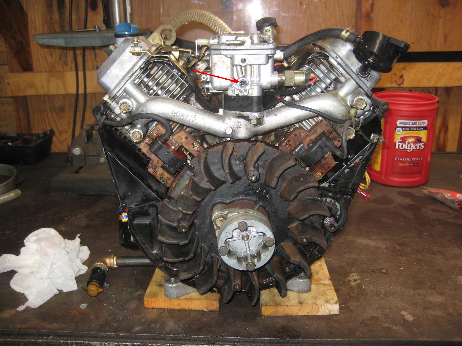

I worked on one that the welch plug in the back of the carb had fallen out. It would only run with the choke on and smoked badly. Red arrow in pic points to the missing plug.
