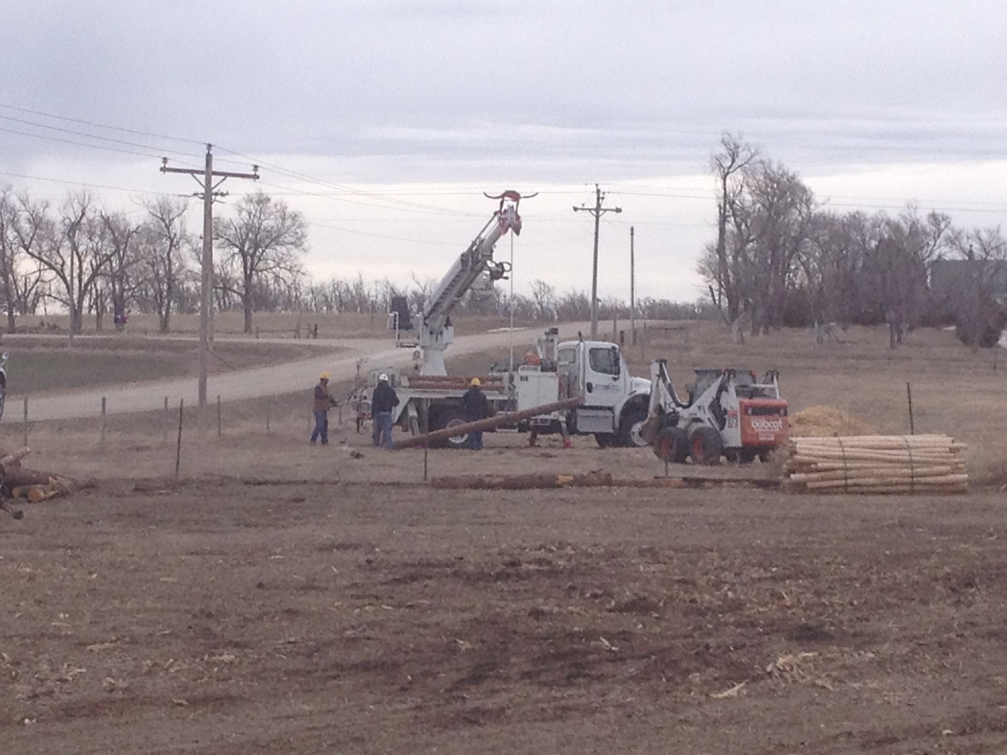

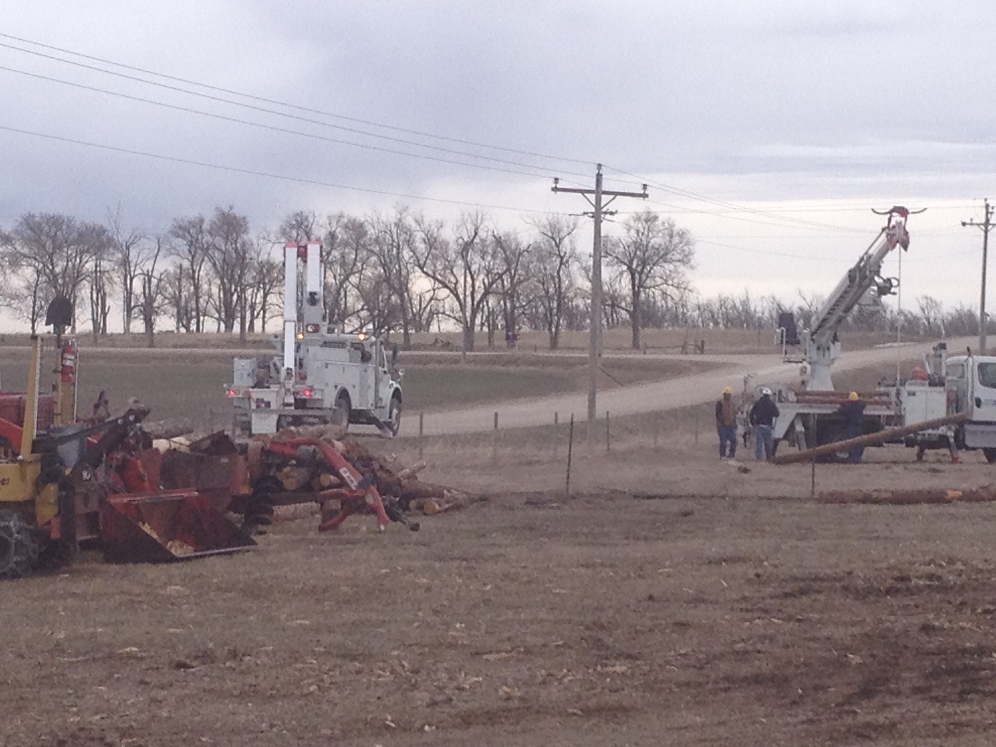

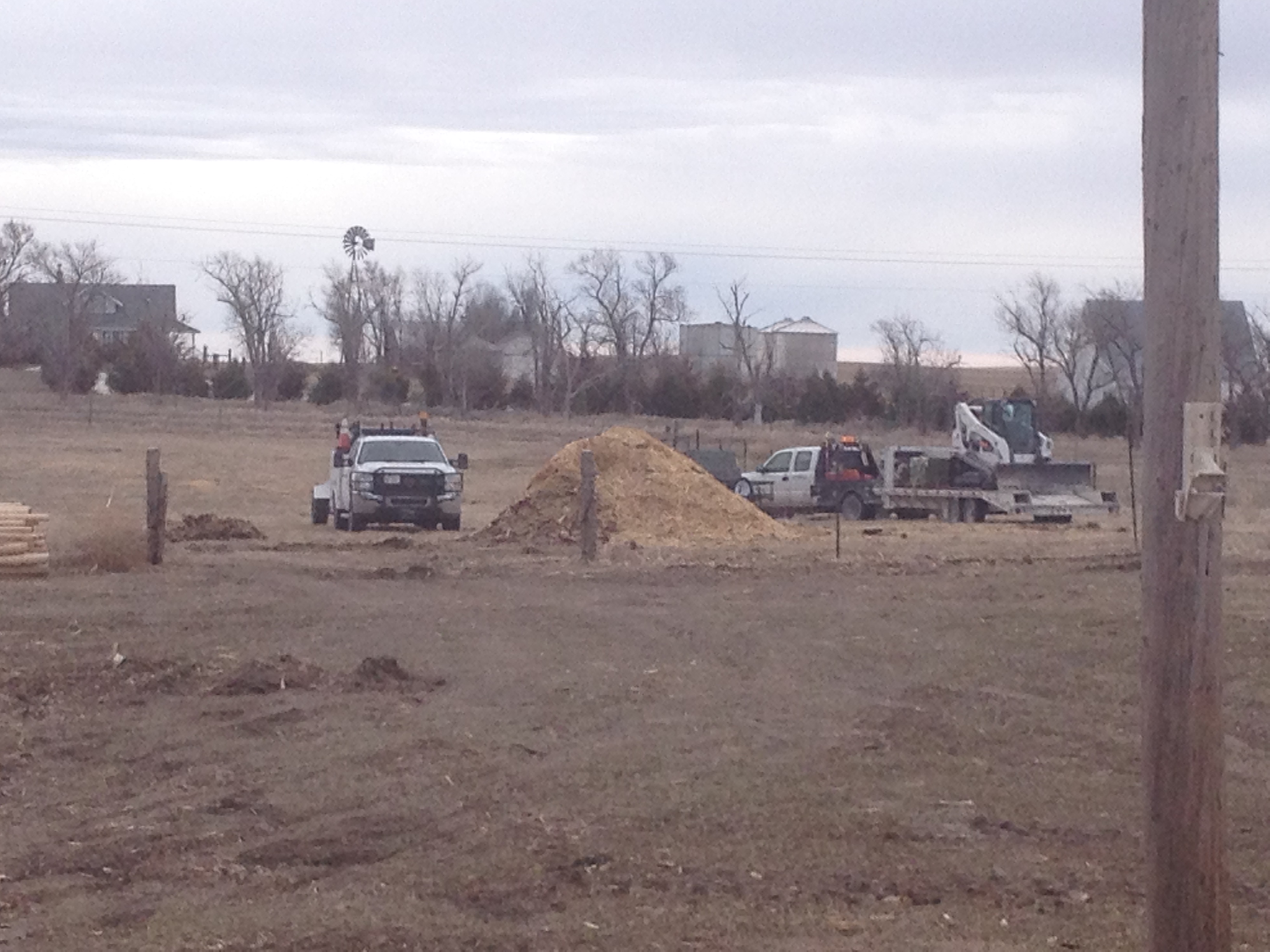

Today is a day I have looked forward to for many years. The crew arrived to bring in 3 phase power for the building I plan to put up later this year. I'm really looking forward to having 3 phase as it seems I find all sorts of things I need to buy but they are always 3 phase so I have to pass. The main purpose of the power is to run a large electric hammermill to resize wood chips. NEw service requires a 10 year contract for a monthly access fee of $30. That gave me 180 ft from the pole, any further and it costs more. Here are the pics of the crew.
View attachment 459269View attachment 459270View attachment 459271
