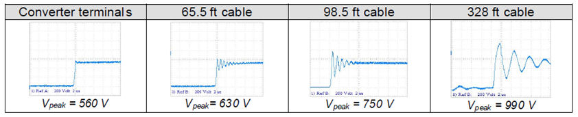

"Motors are rated to withstand voltage magnification caused by harmonic distortion of the motor current. However, when the same motor is connected to VFDs, the motor and its insulation can be subjected to a repetitive stresses from voltage pulses caused by harmonic distortion that can seriously damage the motor or its insulation rating degradation, causing catastrophic failure in a short period of time. Even if such failure does not happen quickly, the pulses will eventually degrade the system and reduce the potential lifespan of the motor. This is due, in part, to the odd-order voltage produced by a VFD, and not the typical sinusoidal wave that is normally provided from a power utility. As a result, when motors are connected to VFDs, they will experience repeating voltage pulses. Those voltage pulses may, under certain circumstances, be magnified as they reach the motor terminals. For example, in tests under actual operating conditions, a 460 volt motor supplied by voltage from a VFD has been empirically measured with pulses as high as 1200 volts, in contrast with the 620-660 volt level measured in the absence of magnification. "
While the statement above is true, it is also not applicable in a number of ways. Small motors (under 10 hp) do not suffer from many of the effects described. Primarily they operate at much lower currents, greatly minimizing the effects described. In particular the high voltage effects are mostly related to the wiring to the motor. If the wiring between the VFD and motor is short, the effects are minimal. See the attached graphic for a 460 volt motor. Again in small motors the causation is also minimal due to low currents.
I work on applications utilizing VFDs of all sizes, and the problems described are virtually non existent with small motors. The biggest problem is when running at reduced speeds, the internal fan does not sufficiently cool the motor if it is at load, which can result in overheating.

^ What he said!! :thumbsup: My understanding is that it's the first winding of the motor that sees the spike (reflected wave) and is subjected to the risk of insulation breakdown. Besides keeping cable runs short, you can also:
-Use drive rated ("inverter duty") motors. (My understanding is the first motor winding insulation is beefed up, and they can handle the reduced cooling effects better if running at a slower speed) -Or,
Use a special terminator box (e.g. Allen Bradley 1204 terminator) at the motor that protects the motor from seeing this spike .
Use a filter on the output of the drive (check drive manufacturer recommendations / type).
