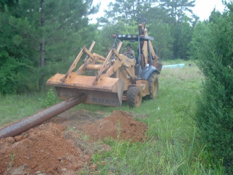

The backhoe made easy work of getting the pipe in the hole, but getting it aligned with the drill bit was a little tricky. One guy in the hole giving directions to the operator while adjusting the pipe by inches.

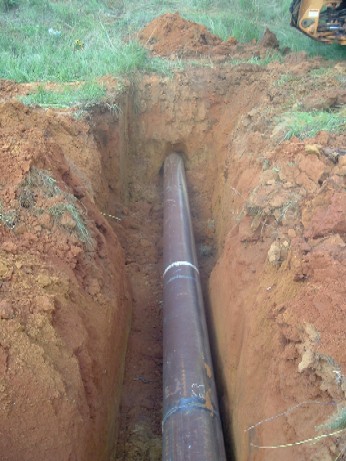

Here it is sliding into it's new home.
