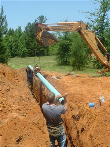

Here's 160 ft of pipe ready to go in. Or as soon as they finish their little chat. /forums/images/graemlins/grin.gif

The white bucket is full of a type of chlorine. About every hundred feet, they tossed in half a cup of the powder.
From what I'm told, it's much stronger then pool stuff, it's a white powder, and it kills all the bacteria that might be in the pipes.
When I finish installing the pipe, they will preasure it up with a 2 inch opening in the end to let the air escape. Then they will seal it up and take a sample to test it. If it passes the test, I can drink it. If not, then they will add more chlorine until it does pass.

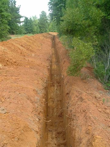

I kind of got distracted from this project for a bit, but now it's time to get back on it.
When it gets too hot out for building, I get on the backhoe and spend an hour or so digging my trench. Even sitting under the canopy, it gets too hot and I have to hide inside for a bit.

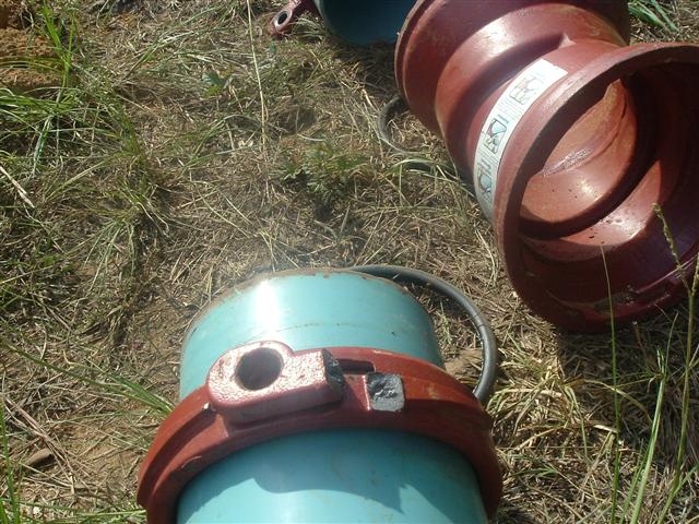

The location of were the water line was brought in dictated using a 22 1/2 degree fitting. To install it, you lubricate the o-rings and slide the pipe in. Then you hit the tabs lightly with a hammer to compress the locking ring until the two tabs are close enought to pull together with the bolt.
The first side went together real easy. The other side didn't.
As you can see in the picture, there was an air gap in the tab just were it would be the weekest.
