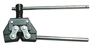

Got a fist size rock stuck between the chain and sprocket on my snowblower tonight and broke the chain. I would have thought that the shear pin would have gone first but it didn't. Tractor Supply had the chain in stock (10' more than twice what I need). It's 60h chain and it came with a master link but I would rather rivet the chain back on. Does anyone have a good suggestion for a breaker (was looking at a Koch). I have a breaker for motorcycle chains that just isn't quite large enough but it will push the pins out then drive them back in. I assume that the Koch breaker will not push the pin back in since it's a different style. I wouldn't mind a riveting tool but have used a hammer to peen the end of the pin. Here's an image of the Koch breaker.
If you go to the web sites of the companies who actually manufacturer the roller chain, they strongly advise against doing the hammer peening to retain the pin. They want the center of the pin deformed to displace the pin material out over the plate if you really want a chain with no master link.

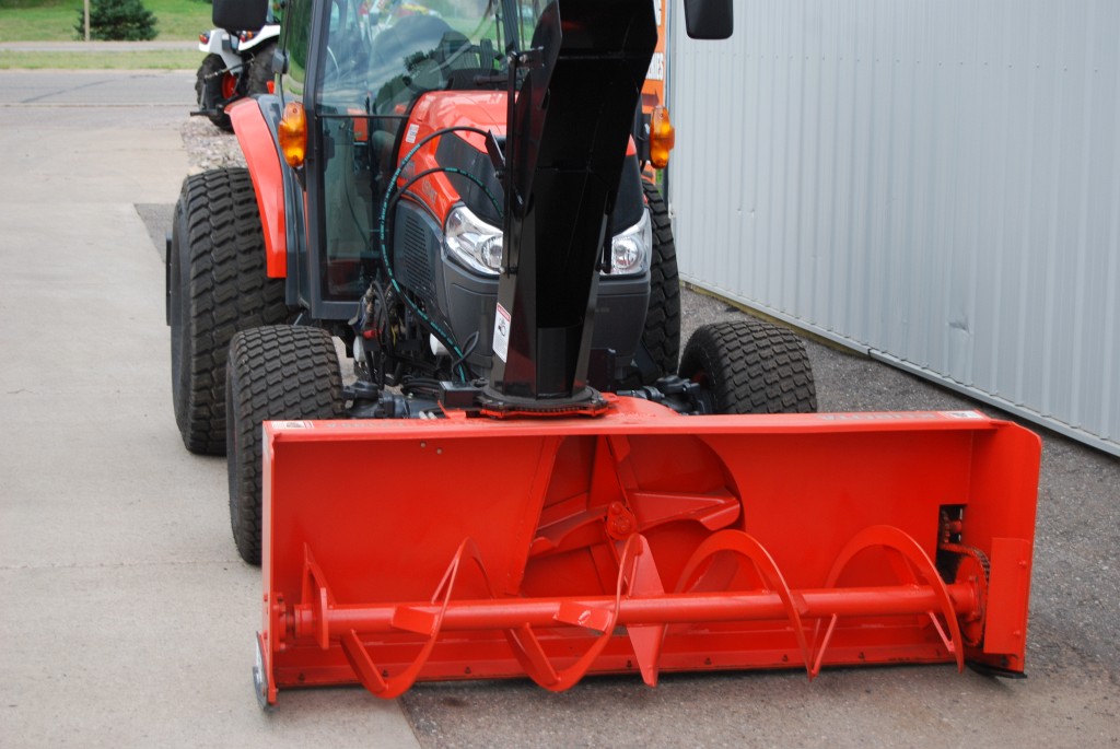

The shear bolts are just fine. Every fall I make sure by removing them and checking that things aren't rusted. The plate in front of the sprocket protects against things hitting it from the front, like running into something. But the blower counts on the auger to pull anything to the center of the blower towards the fan. The speed at which the chain is moving is not my concern. It's the fact that frozen dirt collects where the chain goes through the opening at the behind the auger. There's a metal plate below the chain behind the back of the snowblower. I don't have a good picture of it (this is just one I found on the internet). That plate acts like a shelf. A small amount of snow goes through the opening and most ends up on the ground but the heavy wet snow (and any mud or gravel) can end up on that shelf. If enough of it gets caught there it could cause the spring clip to wear. I don't think it'll be a huge problem but I'll keep an eye on it. Unlike the aluminum case on a motorcycle if the chain breaks or looses the master I don't see much of anything that can get damaged. Plus, as you said, the chain is moving at a much lower speed which would reduce the chance of damage as well.

Kubota parts list shows a part number for a "connecting link". The Kubota price worked out to be twice what a generic 60H chain cost ($50 something for the chain and $5 for the link). If the replacement didn't have a master link it would be real pain as both the auger and the drive shaft would need to be removed as I don't think the side plate can be removed. The sprocket hides the 4 bolts on the flange bearing enough so getting a hand in there to hold the nuts is all but impossible. Then there's not enough room to get the chain around the end of the auger unless it's removed. I've never taken the drive sprocket shaft off but I'm guessing that the gear box may need to be loosened to slide it over. When assembling in a factory it wouldn't be a problem but, replacing it in a shop, it would add at least an hour to the job. I'm sure my concerns of wearing down the master link clip are unfounded. Sometimes you just find a way that works for a different application and like transfer the technique but just make extra work for nothing. Also after looking at the lack of oil on the pins I like the idea of soaking it in oil over the summer.
