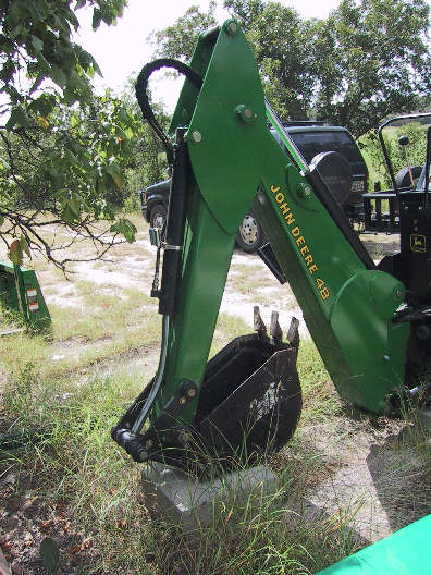

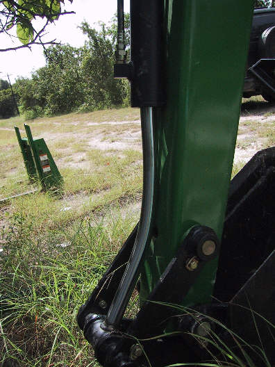

hi db4700 bent my same cylinder on my bush hog back hoe
called my dealer he said the cylinder would be about 100. dollars and is easy to change the whole set up would be about 400. dollars waiting for it to arive will let you know how it goes
i'm looking for a spanner wrench to remove retaining nut bent mine on a huge stump also

I think that the real cause of it was that the cylinder rods were not properly hardened during heat treatment when the rod was being manufactured. Seems like many JD 48 owners had this problem, that I could see from looking at the TBN archives. It is amazing that JD did not put out a notice on this, I guess it is cheaper to pay them out as they happen and some they probably get the user to pay for. If it had not been for TBN and it's archives I would not have seen this trend. Just another benefit of having this site....
/ Broke my BH #23
The problem was that the factory put in the wrong pressure relief valve.

If its just the ram bent take it to a hydraulics shop, i used to be a machinist at one and we kept all sizes of ram on hand and made replacements and also custom cylinders takes about 2 hours and at a cost of 35 dollars and hour.
/ Broke my BH #25
Take the cyl off, dissassemble the rod cap so as to remove the rod (if you can). You can purchase piston rod stock allready chromed from baileynet.com but you must know the length and diameter. bring the old rod and new material to a machine shop to machine threads and shoulder on piston end then cut bushed end off old and weld on to new. buy a seal kit if necessary and reassemble. Cost - machine shop $60.oo rod and cap seals $20.oo. The machine shop will give you the sizes of the rod, rod seal, and cap seal in both metric and american measurements for ordering purposes. good luck
/ Broke my BH #26
John Deere is fixing the backhoe under warranty so they just ordered a new cylinder and replaced it. Now they are waiting for the relief valve soi they can finish the job. They are also supposed to be fixing the cruise control which never worked. I had gotten so used to using the tractor that the two weeks that it has been in the shop has totally messed up my routine and I have had to improvise to get things done that would have been simple with the tractor. I hope to get it back this week.
