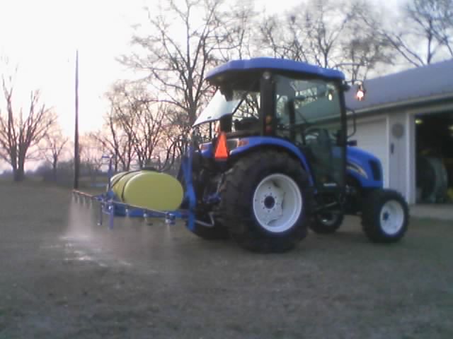

I just bought a new sprayer for my tractor. Last night I thought I'd give it a try and see how it works. Not 5 minutes after taking this picture, I raised the sprayer up and broke my back glass into a billion pieces.:mad::( I'm not quite sure if the center link hit the glass or something on the attachment. Nothing was damaged on the sprayer, but there was a small chip in the paint on the center link. If it was that, I feel that NH needs to redesign a little.
I went to the dealer this morning. The cost hasn't made it to the price book yet. I do have insurance, so it'll cost me $200.00.
Be warned, you with TC40 & 45's, it's **** to get all those pieces of glass out of the cab!
Go ahead and let me have it. I probably should have know better.

Now that the glass is out of the way.. raise it again and see what hit it.
If it was the 3pt a-frame.. i think the toplink may be adjusted too short.. looks like a bit of an angle on that sprayer inthe pic, as if it is already leaning back a good ways.. when lifted.. I'll be it is at a pretty decent angle.. etc...

I had the window open to be able to switch the sprayer on and off. I am now going to invest in a electric switch, so that I can control it inside. The window was open when it broke.
Mad Dog,
I will post when I get details. With the window gone, I can't really tell what hit. Dealer said we would give it a careful look when we get new glass back in.
It could have been the center link. My brother has a TC29 and he broke that tool box (behind the seat) when he raised up all the way. It was the link that crushed it.
How know's. I'll find out soon enough I guess.

I have to congratulate you on not jumping on the opportunity to sue NH for a design flaw, but having the cojones to admit that having the window open when using the sprayer is something that falls into the category of things the operator needs to watch carefully. Lots of people in today's world would be shouting for their lawyer and trying to figure out how to get the most money out of NH.
   / Broke my @#$% Window!
#9
Well...um..thanks? haha I know it's my fault. The thought of sueing NH never entered my mind. But it does seem to me they could design the 3 point to not make contact with anything above it, ya know? Like I said before, it has hit a tool box and now a window. What's next? The back of my head? hahaha Just kiddin'! I love this tractor and all NH"s I've ever been on. Wouldn't have any other!
