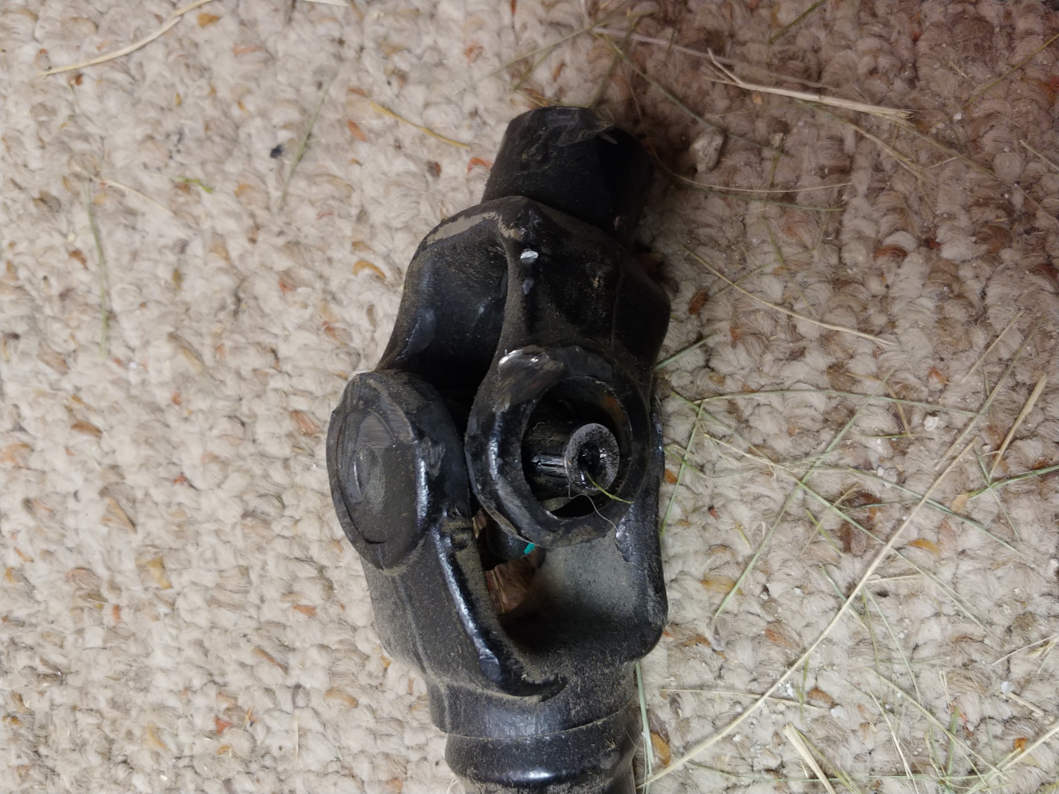

Well, that didnt take long - new 2038R with 32 hours on it.
Put it in H/was driving down to the neighbors on asphalt to move some decorative rock for our subdivision sign landscaping. Got about half way down the hill, appx 1/4 mile from his place to mine.
In 2wd with loader and deck on tractor. Something failed internally in drive line. I am guessing it was the front end but not sure.

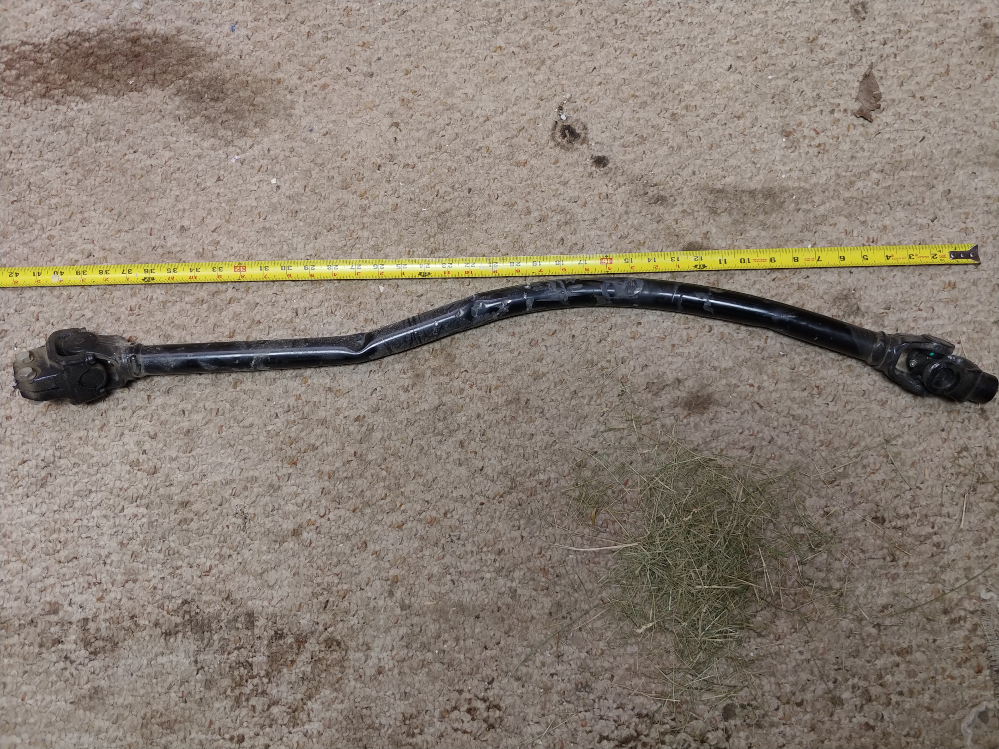

Basically from WOT pedal mashed in H to an abrupt stop like a roller coaster at the end of the ride, sounds include high pitched whine and then a loud pop. That was the drive shaft breaking from the transmission to the front end. Thankfully I was wearing my seat belt as i think it would have likely shot me over the hood like a catapult.

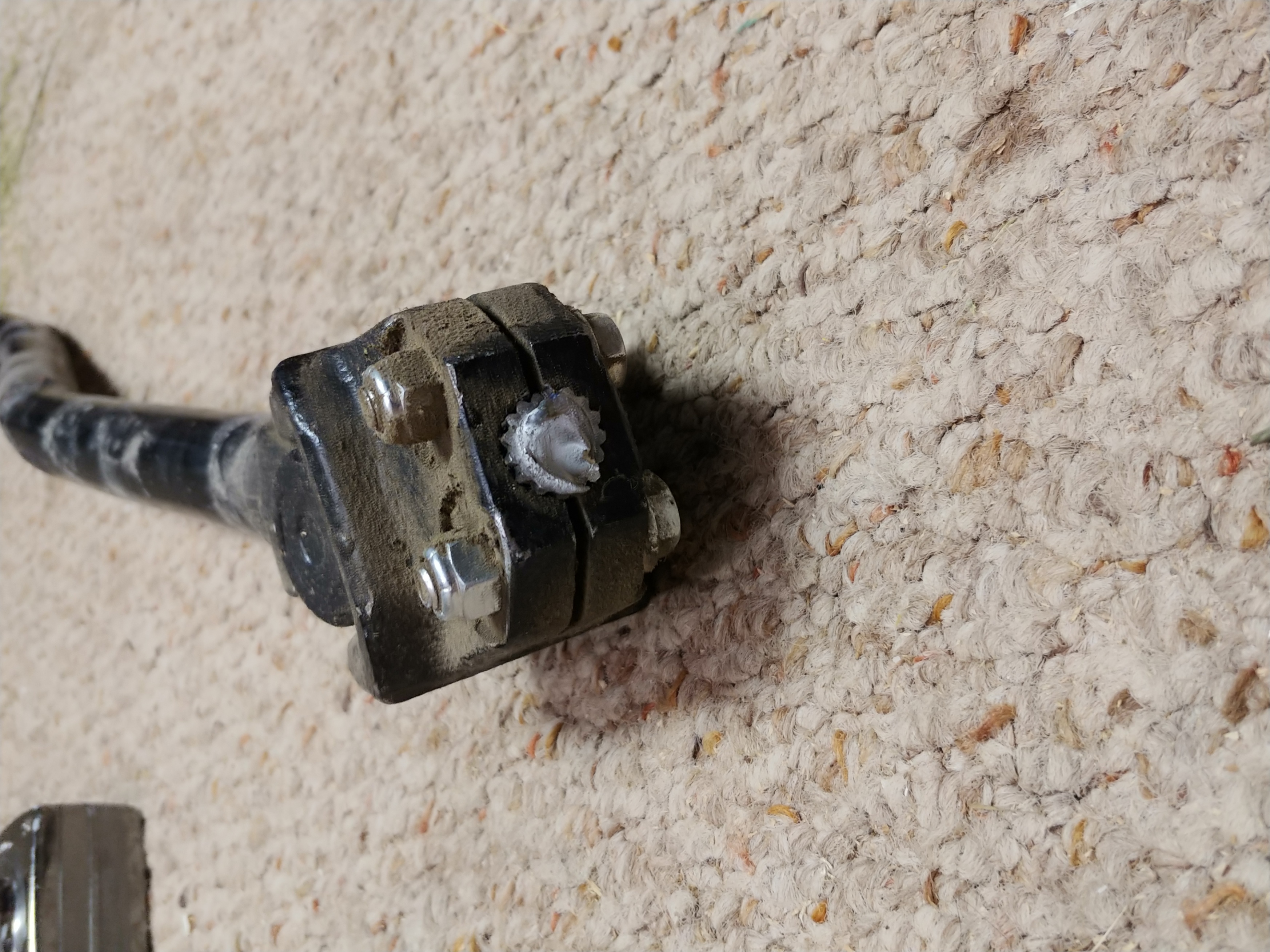

It popped the hydro into N and started to freewheel so i braked of course, reduced engine speed and listened for noises. Nothing strange so went on down the hill to move the rocks. Its wet and to keep from tearing up the neighbors yard anymore than I needed I put it in 4wd, it did not work. We have BIG storms coming in so we got the gravel/landscaping done and i came home and put in the barn at dark. I got up Sat Morn and checked and the drive shaft was bent into a curve laying on top of the mower deck. One end that bolts onto a shaft not sure if its the out put of the trannie i didnt pay attention when i removed the shaft - about a 3/4" small shaft is twisted in two. Also the other end it blew out the U joint.
Its always been very difficult to get into 4wd i just attributed that to new gears and tightness. I also noticed its difficult to get the differential lock to work as well. You have to go fwd/rev to get it to mesh in as well. Who knows........just lucky i guess and thank god for seat belts.

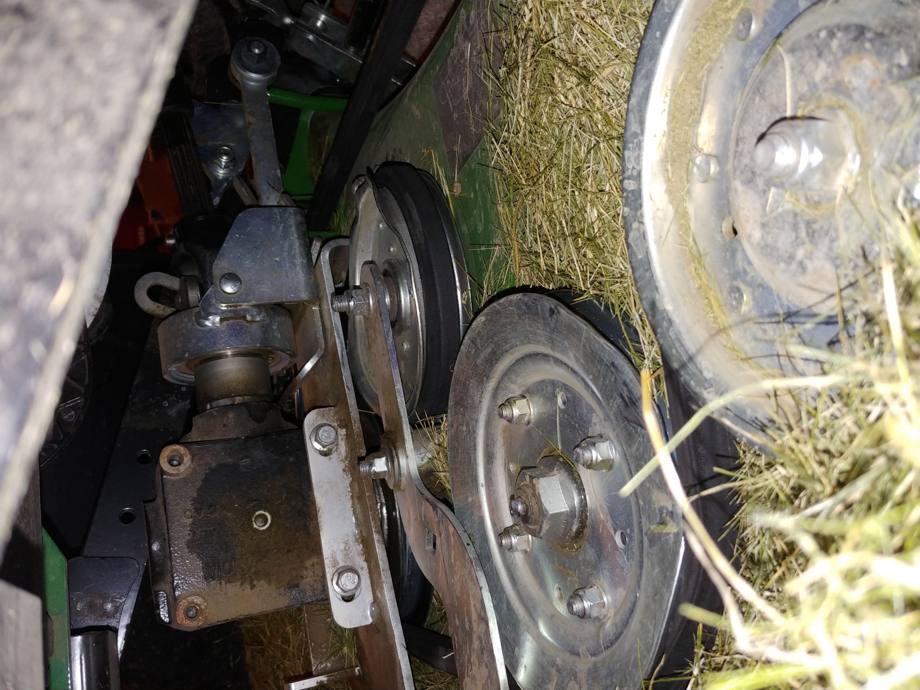

So it made no noises and worked ok until i decided to mow last night. I turned on deck and grind/howl turned off quick. When the drive shaft slammed downward and bent it crushed pulleys/brackets on the mower deck. Yeowza what a deal.
Deere is going to come get it thursday. My wife and I had to push mow 1.5 acres yest wow that was quite a joy. Im too old for that !!! Trying to get parts for an older deere rider my kids have and get it going to use until the 2038R is fixed.
I guess i am just lucky to have such odd things happen. They already had to replace the noisy gearbox on the 72 quick connect belly mower I hope this is the last of the gremlins.
I didnt see anything on the internet regarding anything like this so guessing its a rare/odd thing. I always seem to get that type of stuff vs something common.

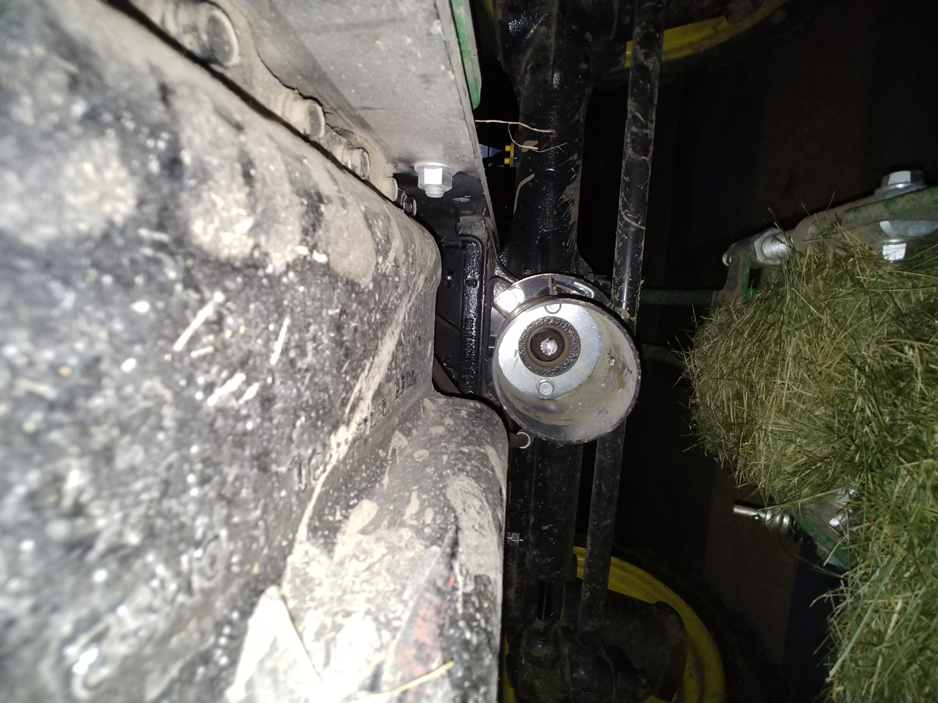

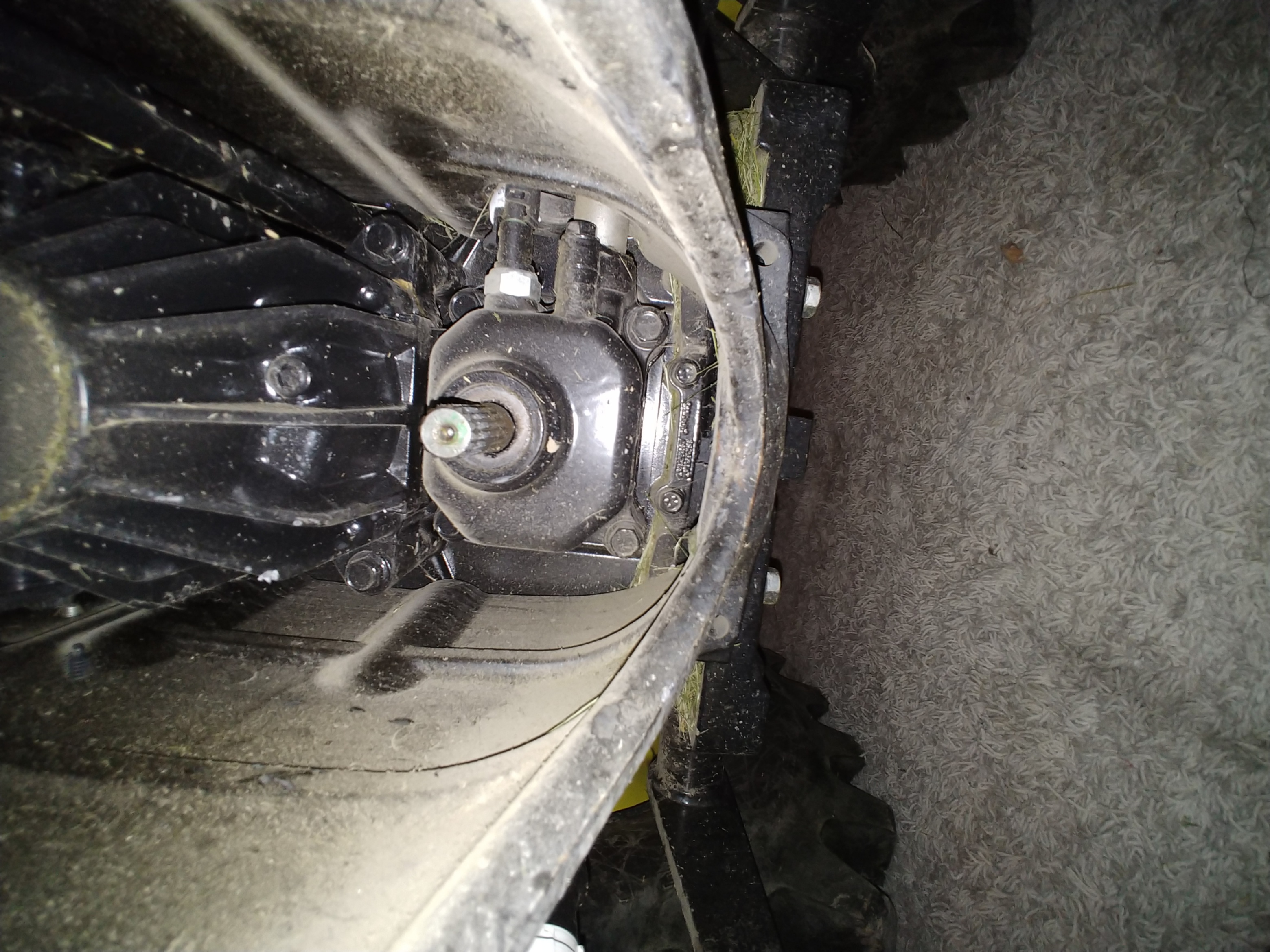

correct its the output shaft from the trannie ( drive shaft ) whatever u want to call it that runs to the front end
I have pix i just went out and took them, will have them shortly they are uploading to my email then i can put them on here and you can name/call them whatever you want i call them broken ;-)
View attachment 606764 View attachment 606765View attachment 606766
Looks like something internal to the front axle failed, the shaft you showed is the weakest link and possibly just a result of the front axle failure. Definitely NOT operator error but crappy build.

If he was not in 4x4, why would the shaft fail?

I'll bet the broken front axle drive shaft tangled with the mower drive shaft and damaged it. Then when the mower was used the damage showed up.
Bad metal? Manufacturing defect? From the other posts, I gather that shaft is rotating all the time whether it's being driven by the transmission or not. If it was bad from the factory, it may have just let go from the rotational forces. That would explain why everything else still worked, drive, hydraulics, etc. The MMM may have worked also if it hadn't been whomped on by the flailing shaft.

other notes..........the MMM has never been off and its the quickconnect that you drive on and it locks into position and there is not really a way i can see the MMM pto shaft would be able to make contact with the Front drive shaft - when i got it the MMM gear box was VERY noisy and deere agreed and replaced it right out the gate. They said they had a couple like that and one also self destructed. The replacement MMM gear box has been normal noise for a gear box.
And you are correct - the front drive shaft rotates at all times, the drive to it is provided by coupling inside the transmission when you engage the 4x4 lever. I have another conversation in here regarding my reviews of the 2038R and i complained months ago that it was stiff and hard to manipulate the lever, its a pull up, push down type T handle that comes up from the floor board/operation station.

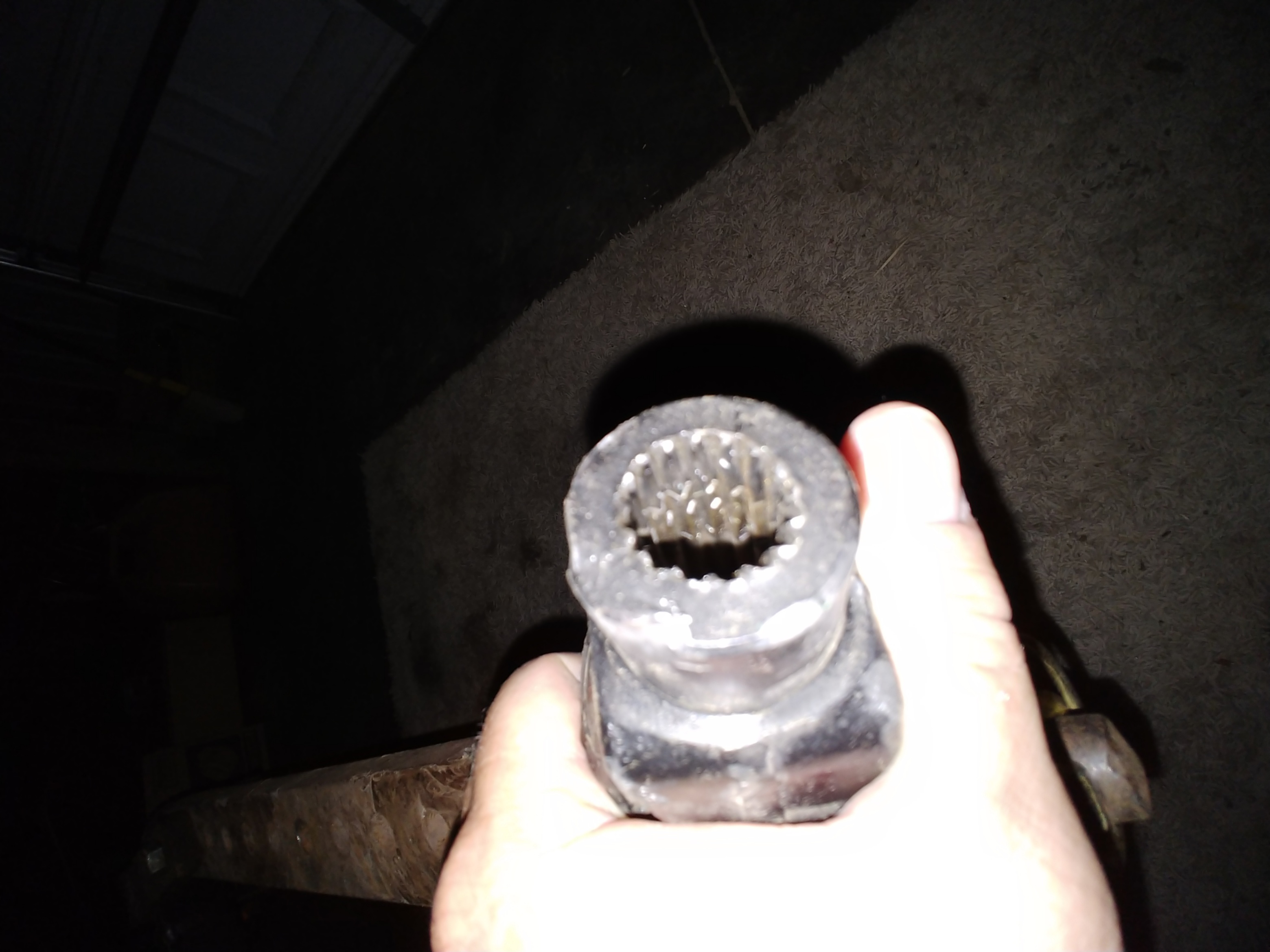

I bet they dont come up with much of anything. I am guessing something bound up and until it breaks this may happen again. The mystery to me is the hydraulic whine that makes me lean to something in the hydro/pump - i will be curious to see if the 4x4 handle is easier to engage and disengage once repaired. Also it does look like there is a little damage to the splines/shaft that comes out of the trannie not sure if it will be repairable by filing out the grooves or if its damaged too much.

With only 36 hours I hope that they replace the shaft if the splines are that bad.
Looks like when the back end of the drive shaft snapped at the tranny (for unknown reasons) when going at road speed and the drive shaft flopped around, then jammed something solid and couldn’t turn anymore.
All that momentum and front tires turning it snapped the shaft at the front axle and almost threw OP over the hood.
