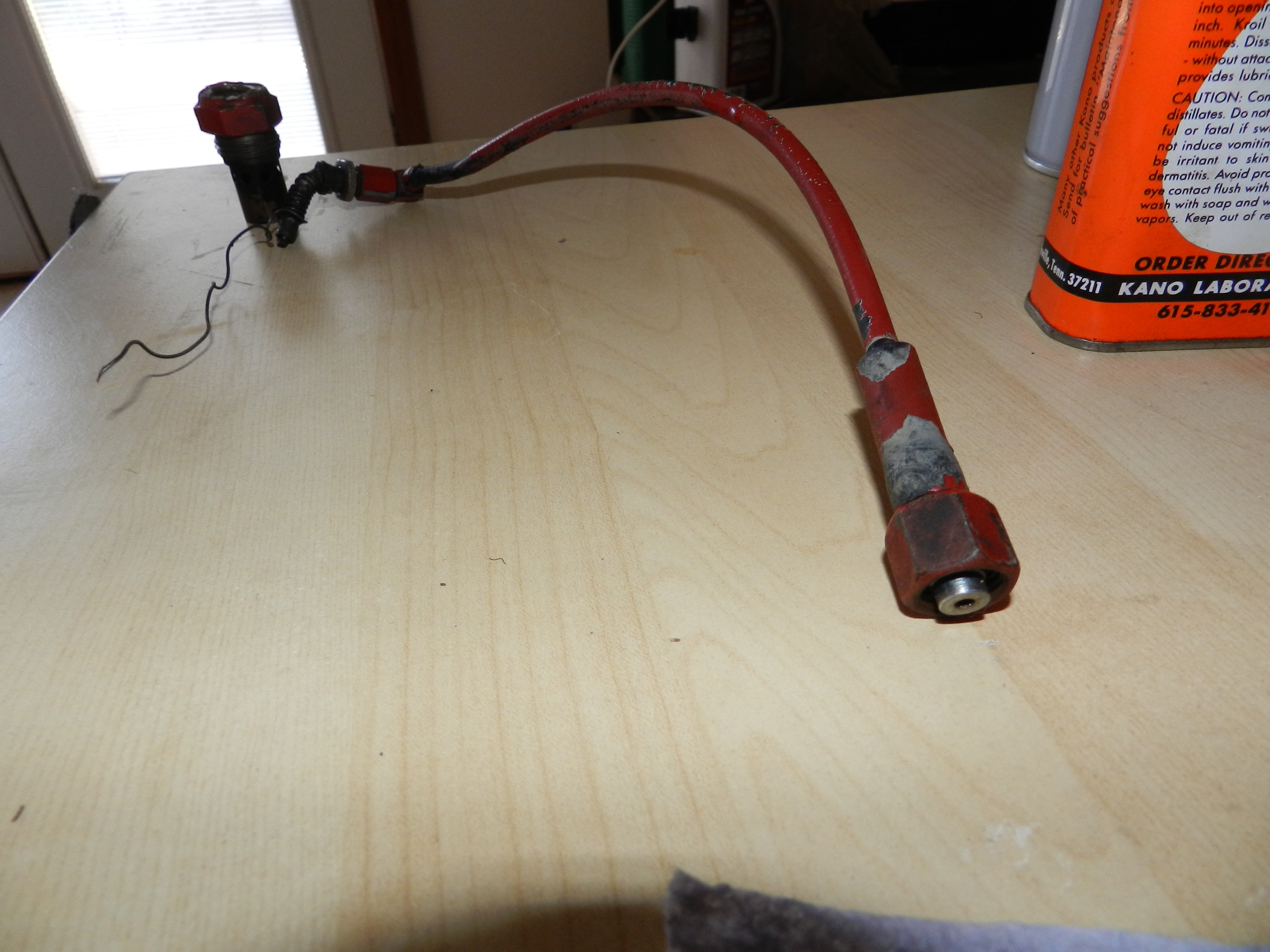

Is it the tee thats broke, or just the line/line fittings? If its just the line and fittings, I would think you could find some really cheap at any tractor/farm store.
It is the line and fittings, but....The end at the tee is a thread not found on most tee's. I am not sure were to find that thread with a hose barb to make my own line , but then comes the outer end.... It has an elbow fitting with a little bitty orifice, an incorporated into that was a blade connector and a wire that went around the fitting and into the intake manifold. I have no idea what that was for.
I will try to get pics.

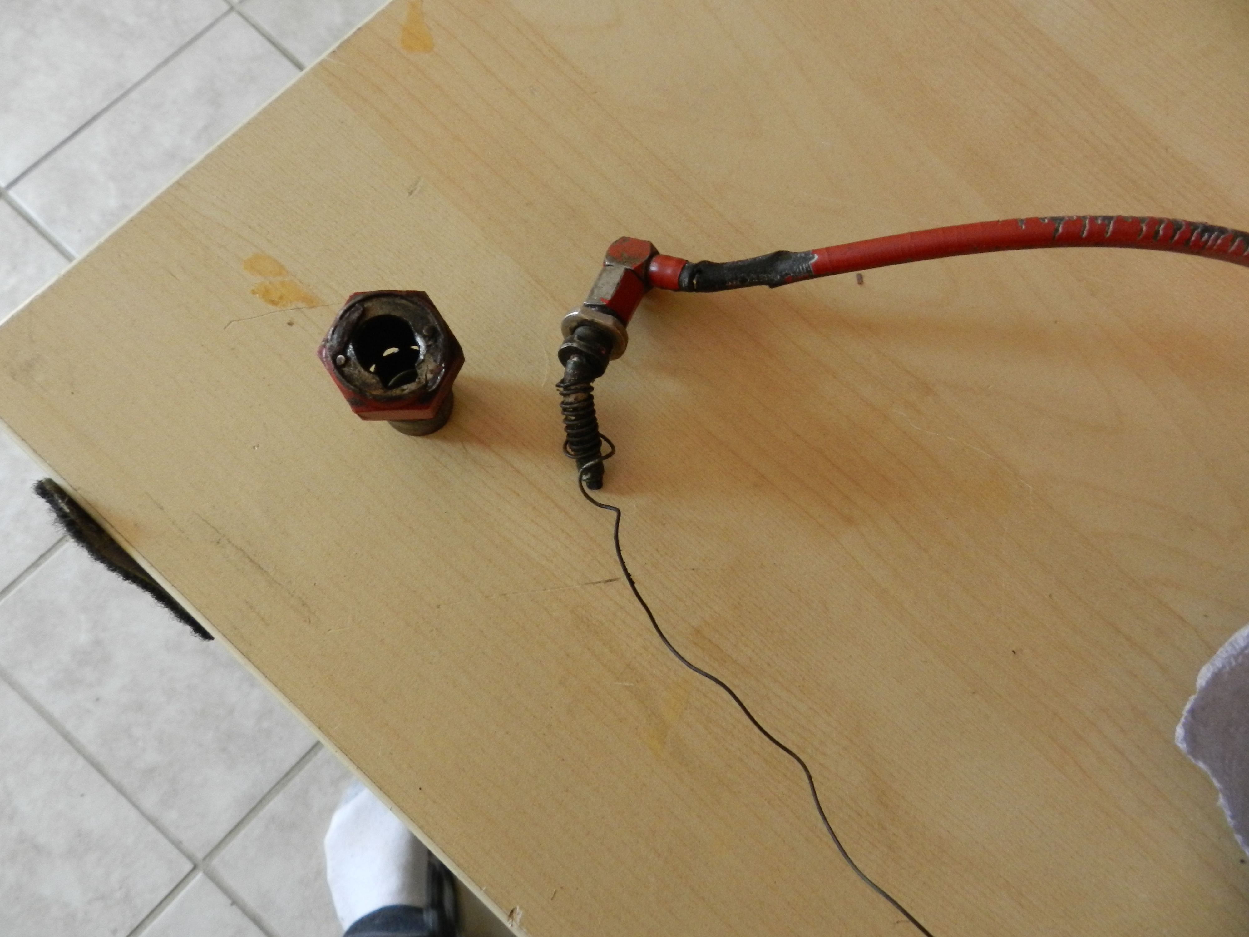

The wire was stretched out some during disassembly.
   / Broken but is it broken? #14

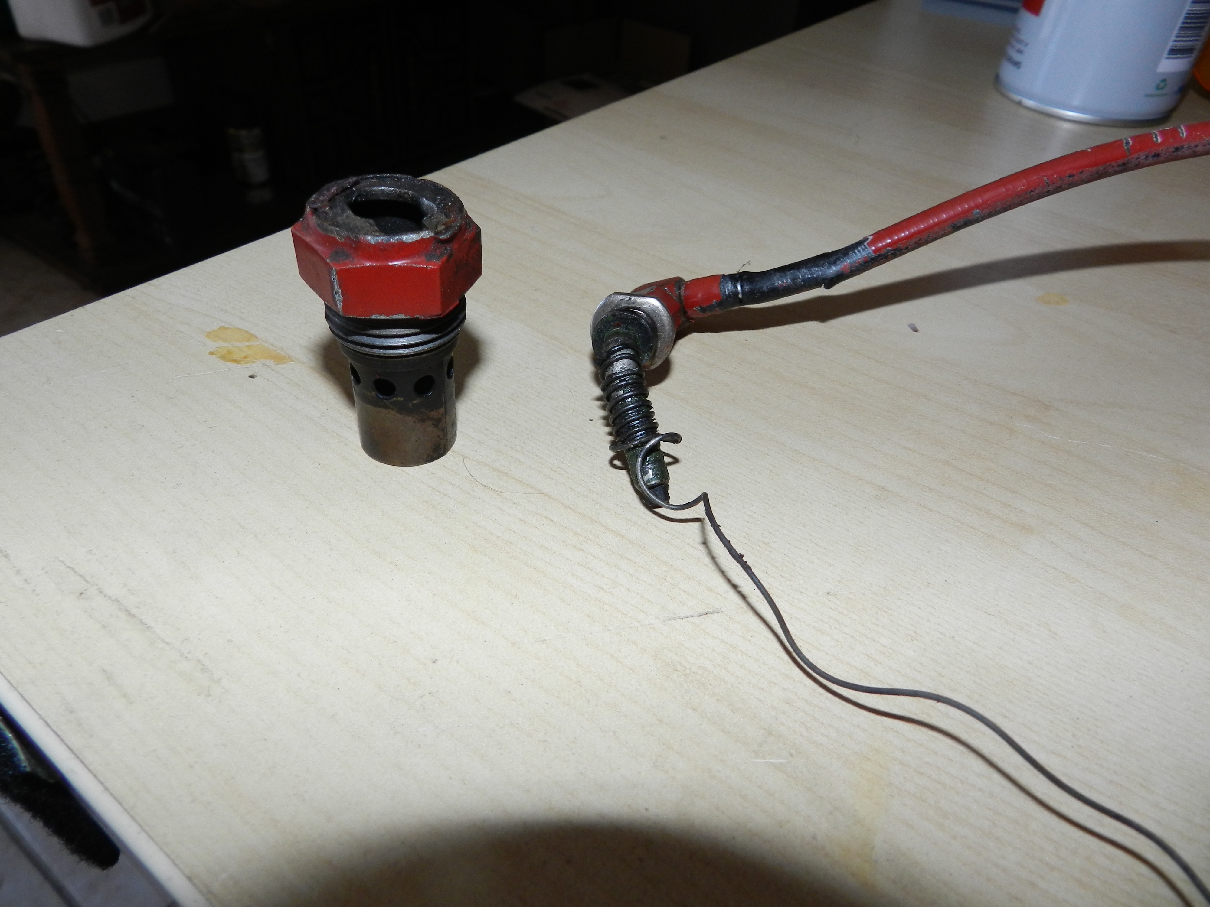

Seems you have broken the Thermostart cold start helper.

THANKS...ALOT!
Thanks to both of you, Agvg and Midniteoyl
It is nice to have friends in far away places.
Part ordered.
Until I get the line fixed, I can plug the intake and the line and run the tractor.

I just looked it up on messicks now that I know what it is.
The glow plug is $58 and the tube is $145.
What did we do before ebay?

I dunno.. But i bet if you msg the ebay seller, he just might have the tube, or know what you need to make your own.
#20
Great idea!
I will give it a try.
