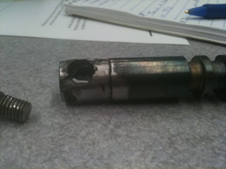

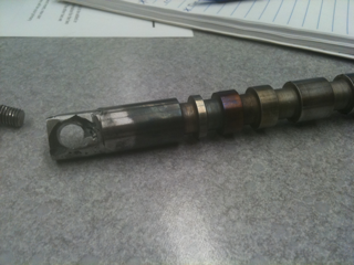

Sorry. Got wrong picture on the last post I made. Here are a couple of the welded spool. It seems to work so far. No leaks yet.
   / Broken Controls Koyker 160 FEL #12
Good deal, and keep those joints lubed.
