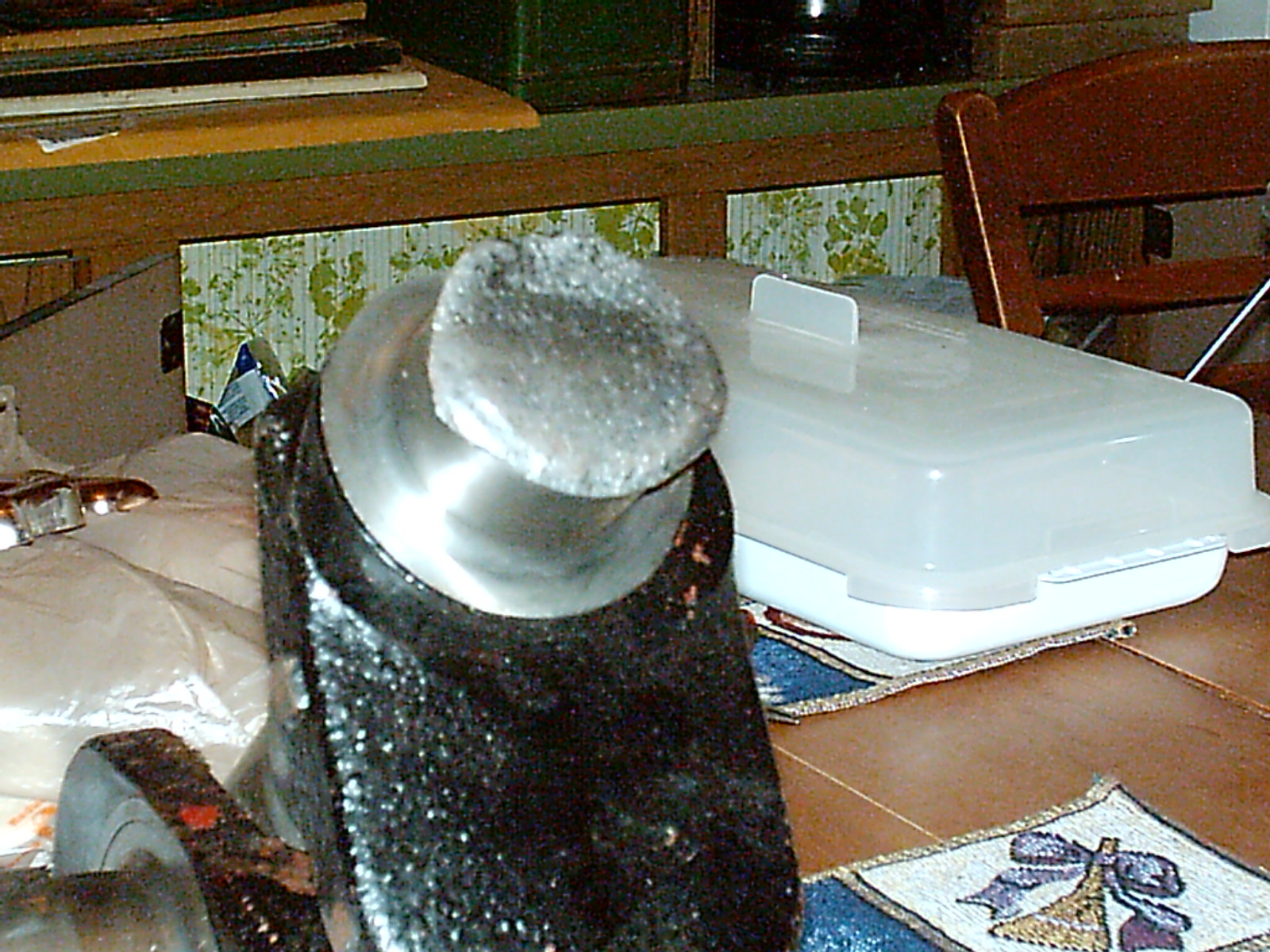

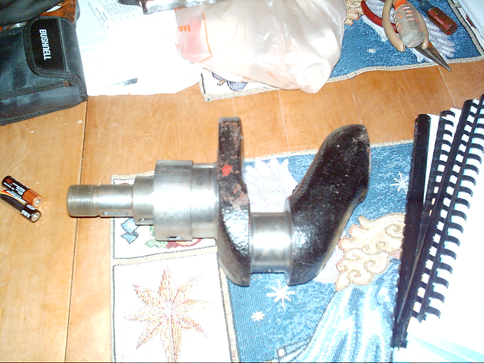

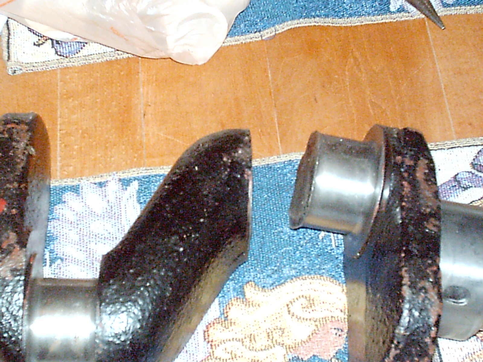

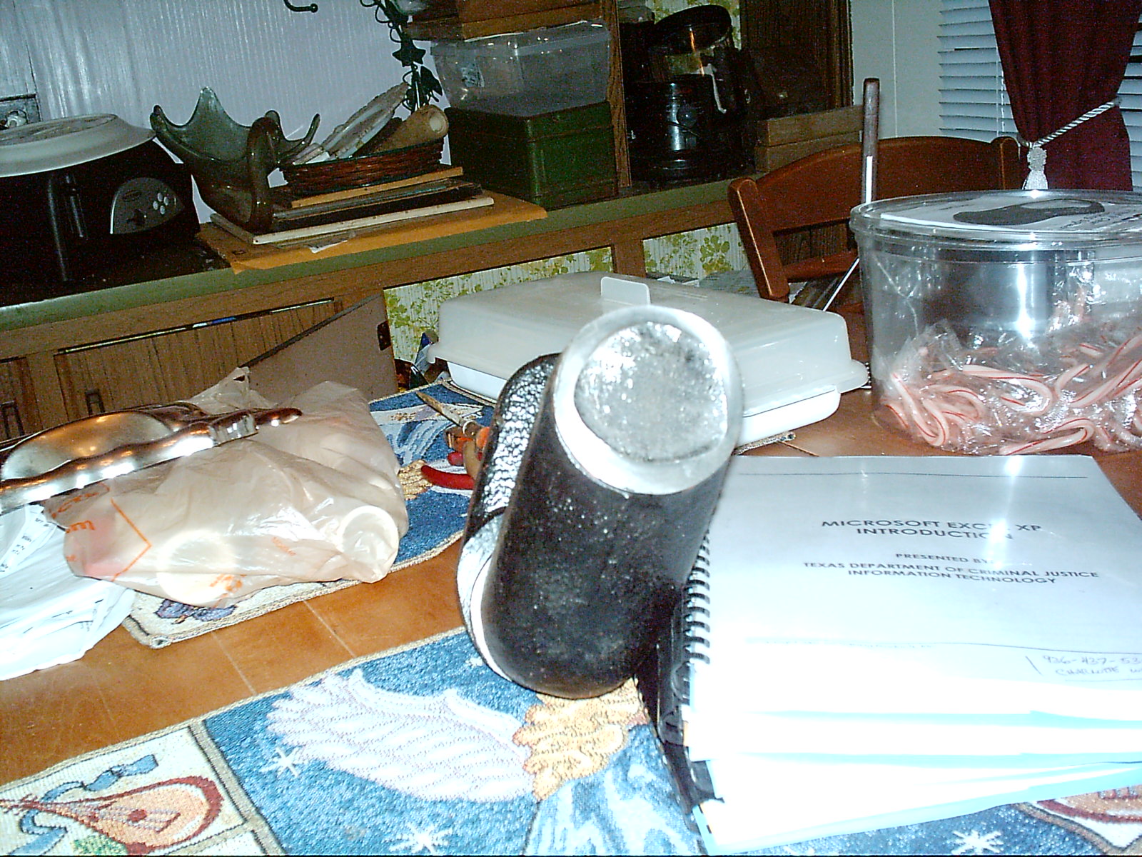

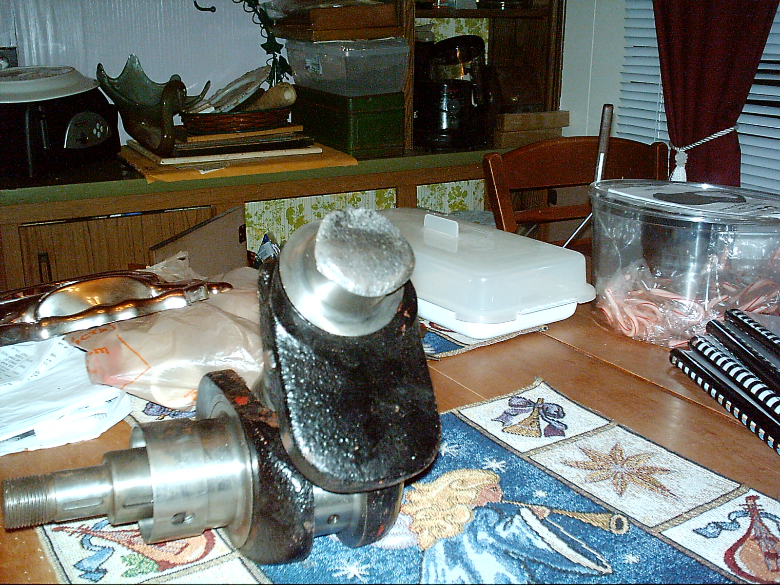

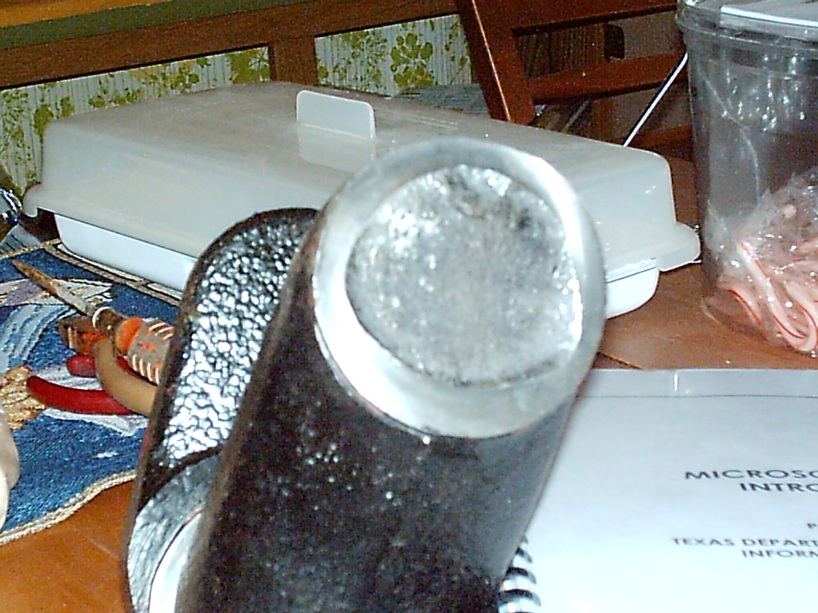

I retrieved the two cranks last night. Here are the photos of the broken crank, which I bought in August. I hope you are able to see the texture of the inside of the break well enough in the photos.
That looks like a crankshaft out of a 2 cyl, I thought you said it was a YM2010. There have been some problems with the aftermarket 2cyl crankshafts.
Danny
/ Broken Crank #28
The break fracture seems very course to me. My thoughts are improper tempering and case hardening???:confused: :confused: :confused:

The photos are not very clear--It wouls sure help diagnosis if we had some really clear pics. I do not mean to be critical, but it is hard to see the grain structure of the metal in a blurry photo. Your kitchen and dining room are in focus though. ;)

Yes, it is a 2 Cylinder YM2210. I mistyped on the original post.
I will see if I can get some clearer pictures tonight.
