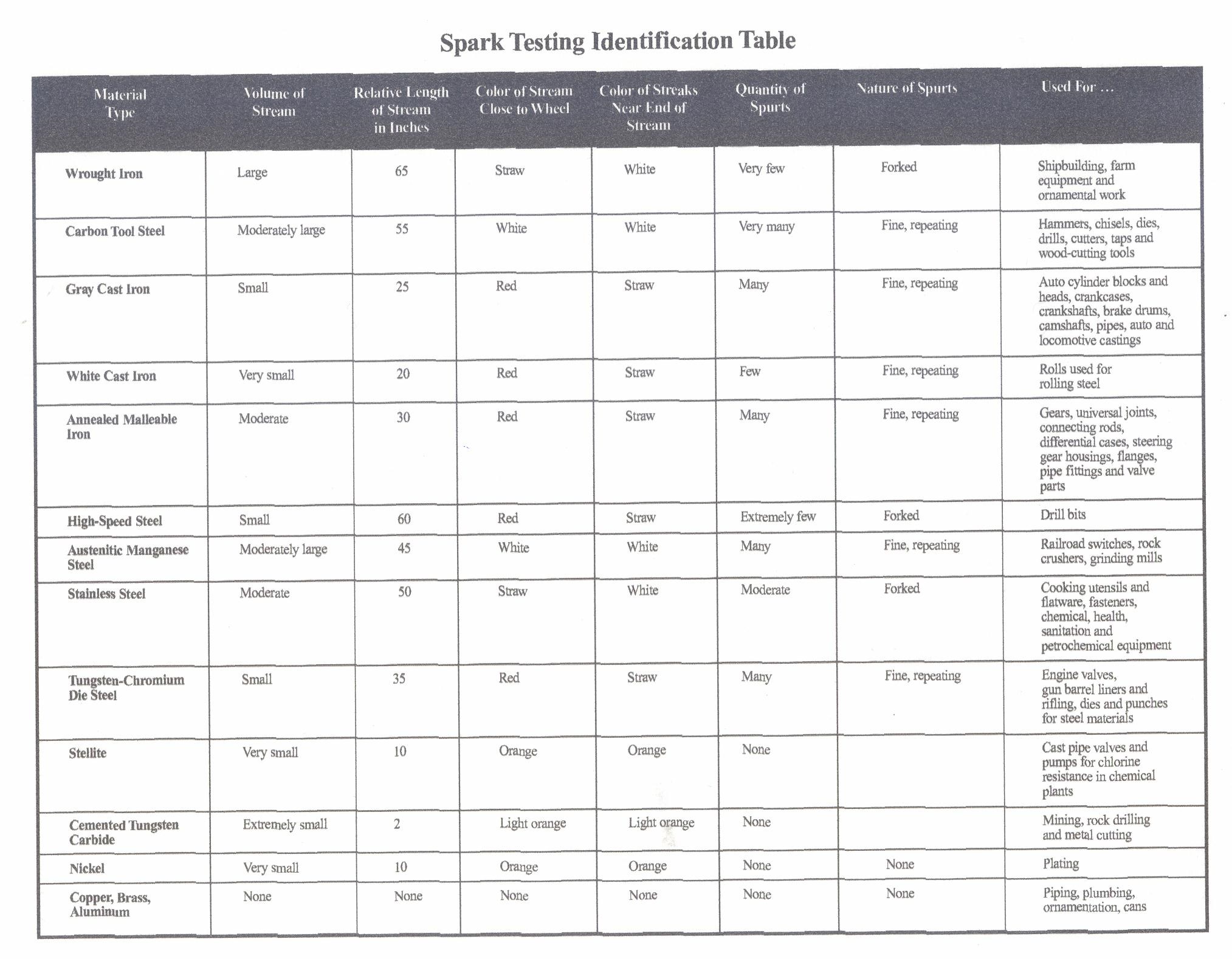

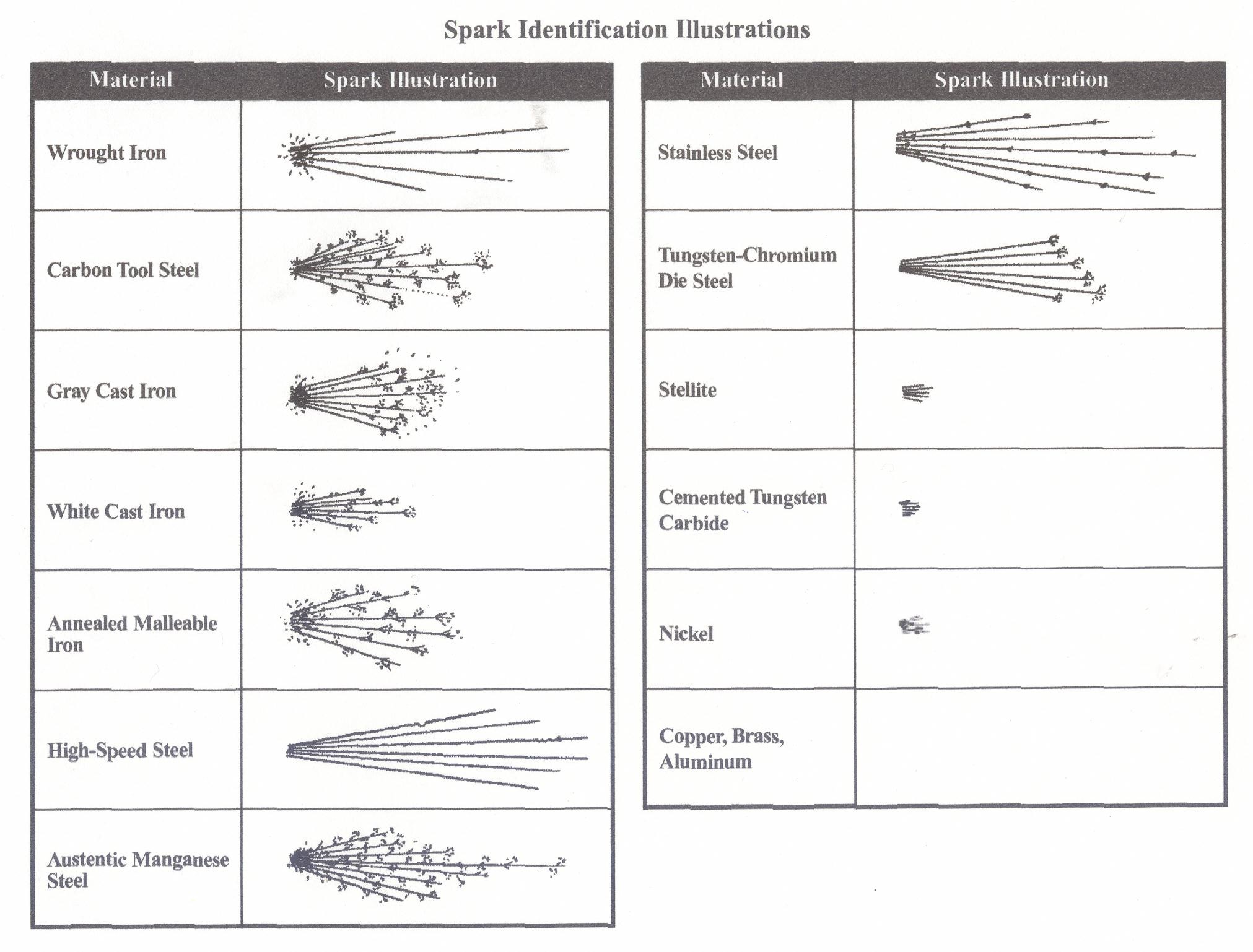

You could always do a spark test to see what kind of metal it is.
