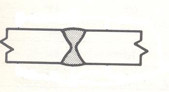

I'm not a pro welder either! But I would grind between 30 to 37 degree bevel all the way around on both pieces. Clamp both pieces to the table, with a small gap. And weld with 1/8-inch 7018.
   / Broken drawbar... chances a 'pro' welder can fix it #12
^^^ What shield arc said. What do you have to lose?
   / Broken drawbar... chances a 'pro' welder can fix it #14
When in doubt.....7018..:thumbsup:

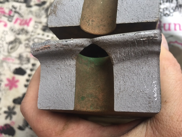

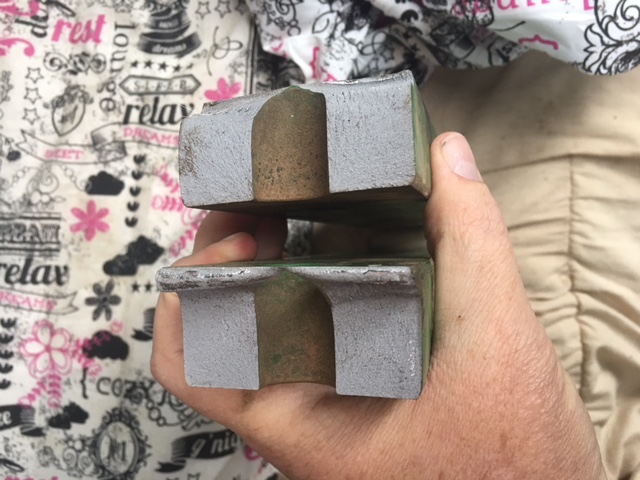

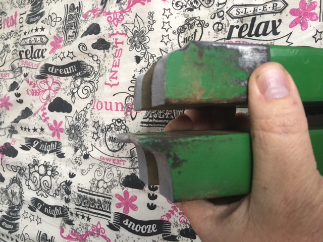

Except one thing, that shouldn't be your "practice weld". Its an easy weld though, just as Shield arc's pic. That can be welded up easily and be stronger than the hole next to it.
Can you post better pics of the surface of the cracks? Not much action on the forum we need something to chew on! :D :thumbsup:

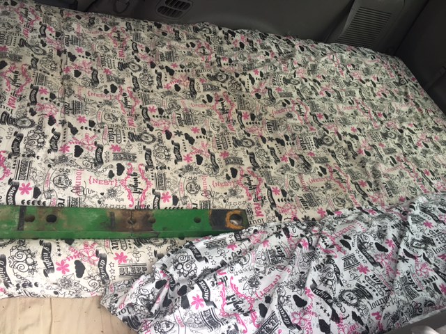

And before you give me grief about the background...
This is an older Toyota Sequoia we use to haul dogs back and forth from KY to IN.
My wife, in her womanly logic, said "I want to get a cover for the dog cushion, that doesn't show dirt. Because it looks so bad."
My logic is "So you chose the ugliest cover you could find, to hide the dirt?!?!?"
