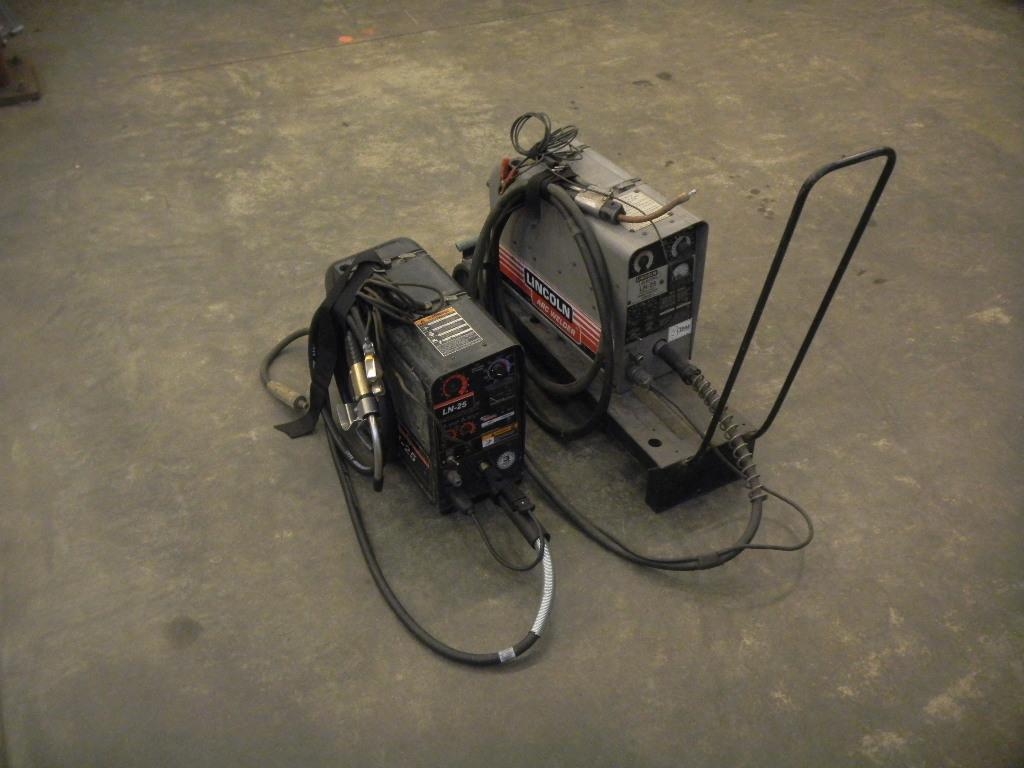

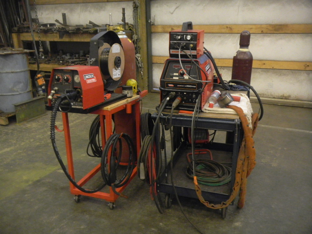

I'm not familiar with any of Everlast multi-process welders. I own a Lincoln multi-process welder, V350-Pro. I just love that welder.
Maybe think about buying Everlast's PowerArc 300. That welder has adjustable hot start, and arc force. Then shop around for a Used LN-25 wire feeder so you could run self shielded flux core wire. And buy a Tig rig for small, and thin material welding.
