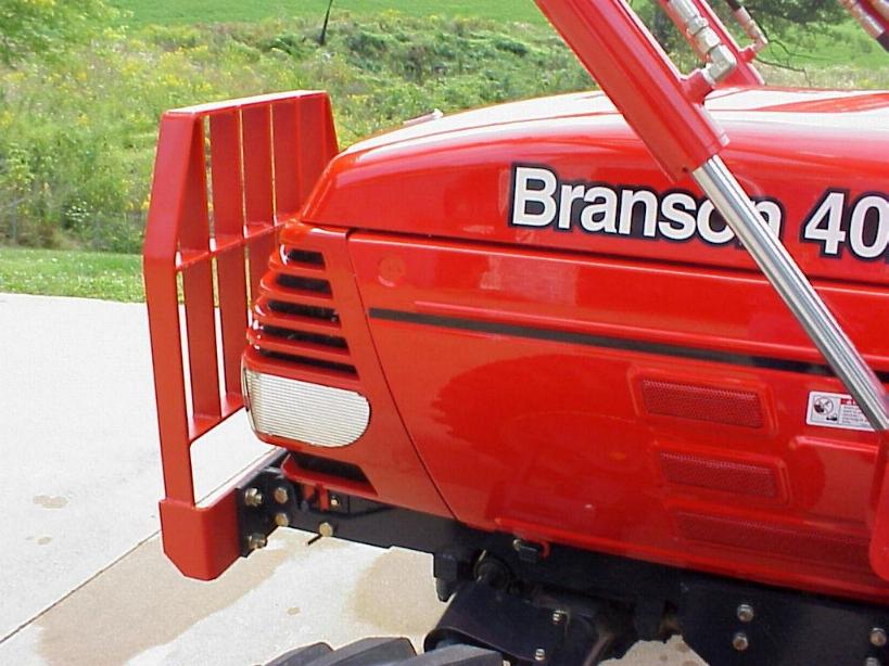

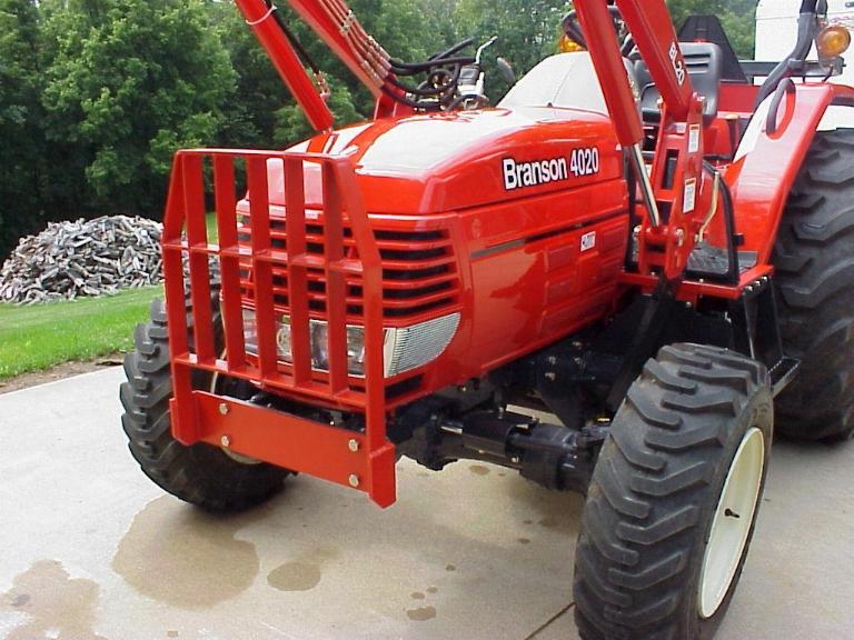

Here's what I did with my guard a couple years back. Made a difference on protection.
