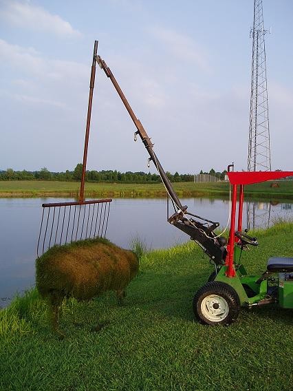

I may have over stressed my machine by doing this but one way or the other whatever I have to do (redesign, reinforce or repair) it must perform this Job. I moved a lot of moss before the roll-over assembly gave way so maybe I’m not asking too much of it. My first hint of something wrong when this weld cracked was a squawking sound while rolling the rake back to me. If I had kept working after this warning my repairs may have taken much longer.

Yes, I have been using the mini-hoe. The first crack did not appear until one year and about 275 hrs.
Mini-hoe work was in the first 100 hours, then light 4 in 1 bucket digging and snow plowing with the PT blade for the next 175 hours.
Cracks were already there at that time, and I had them welded on three different occasions.
More mini-hoe work enlarged the cracks. Once the pin starts to bend, the rollover assembly is doomed, as rotating the part on a bent shaft will continue to brake the welds.
Possibly the thicker new 'tube' will prevent this from occurring again.
