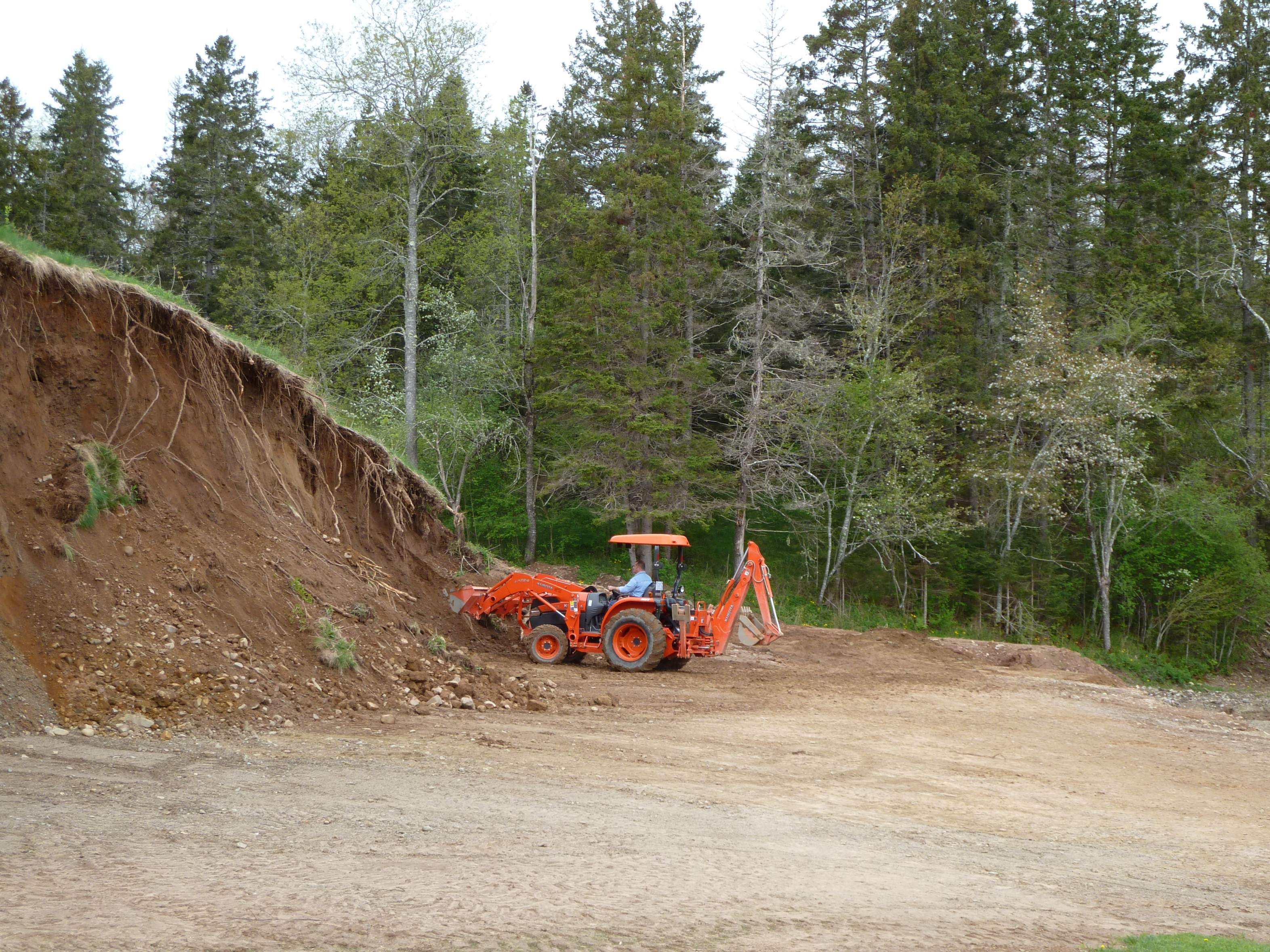

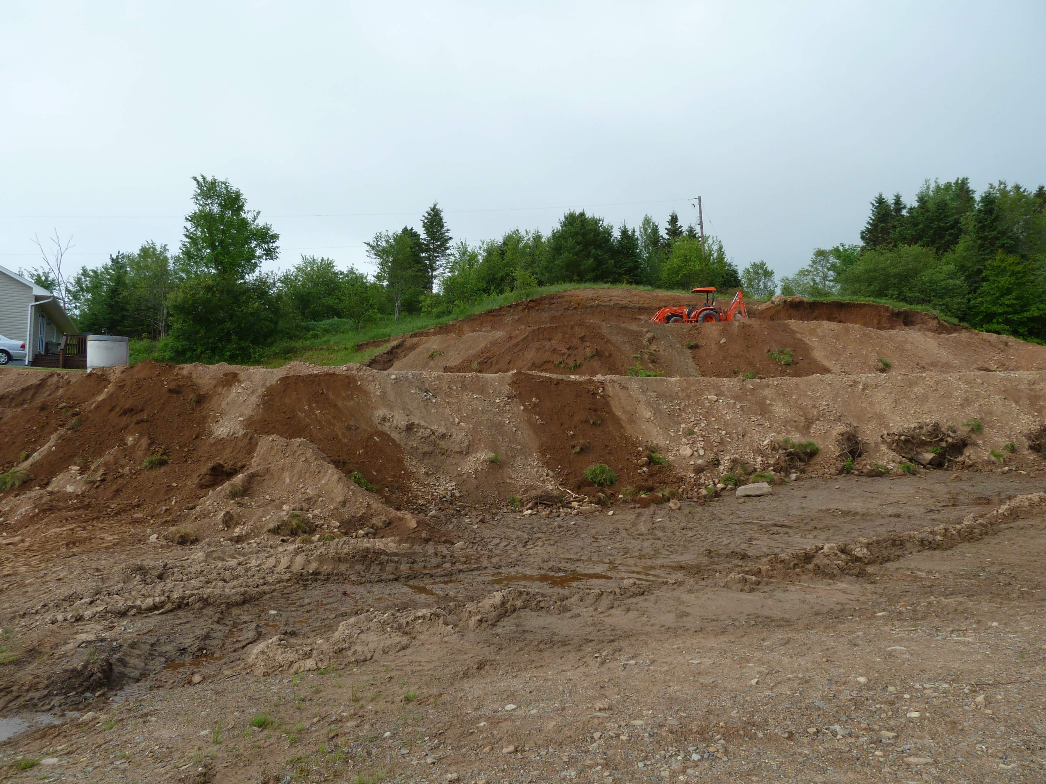

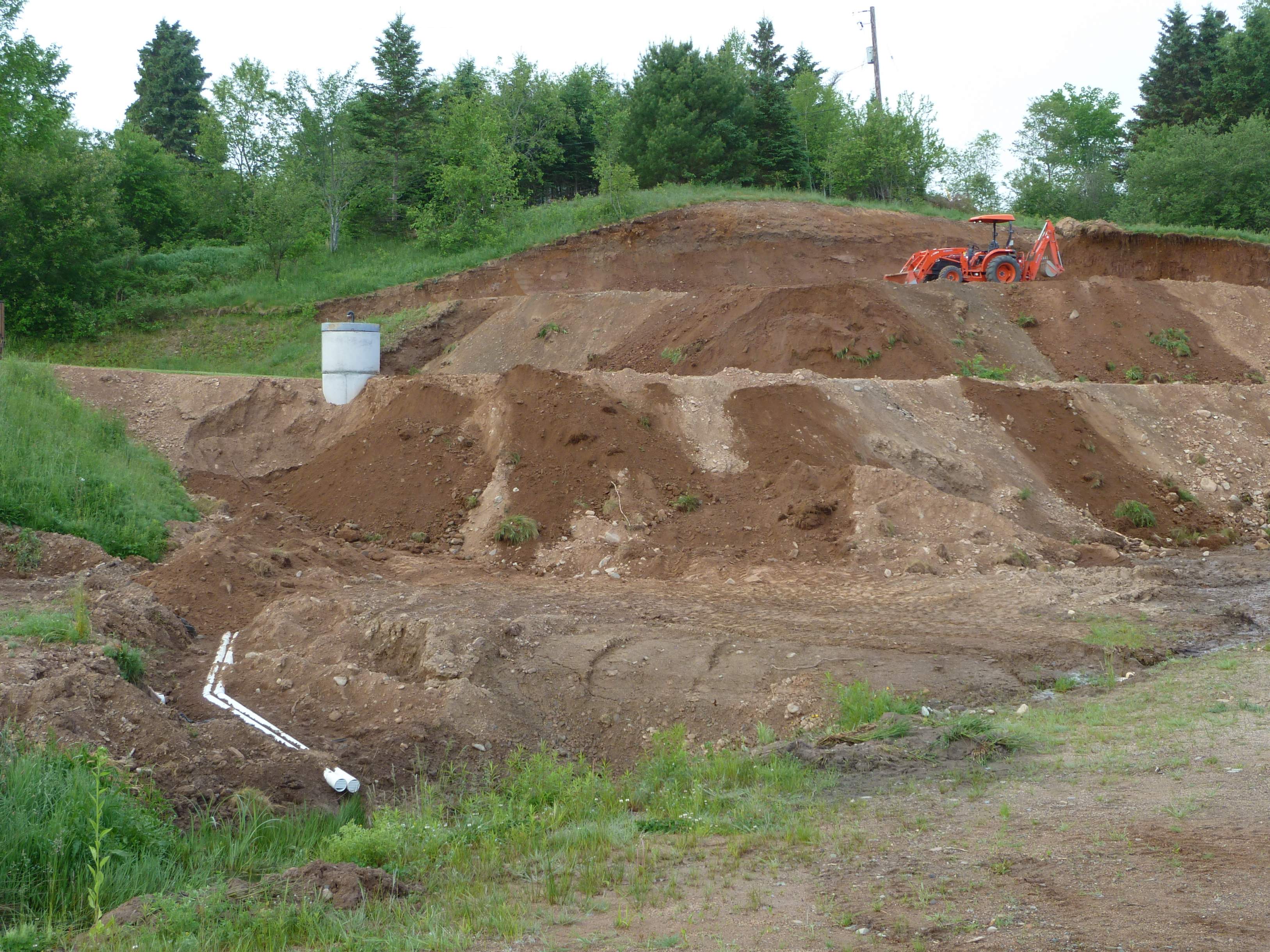

Thanks for the kind words.I only use the tractor to move laundry detergent once a week on laundry day:laughing.The other times I use it to level off my property.I am currently leveling my back yard which is where the bracket broke.I have added a few photos of it.

I have to say there looks to be enough work there for half the members on TBN.;)
   / Broken Mount For LA724 #96
I was wondering how you had accumulated all those hours on a 2010 machine - mystery solved. You are doing civil engineering on a scale that I never would have thought to try.
   / Broken Mount For LA724 #97
Yeah, kcender is now my new hero.:D
   / Broken Mount For LA724 #98
Level it? That's a play ground.
