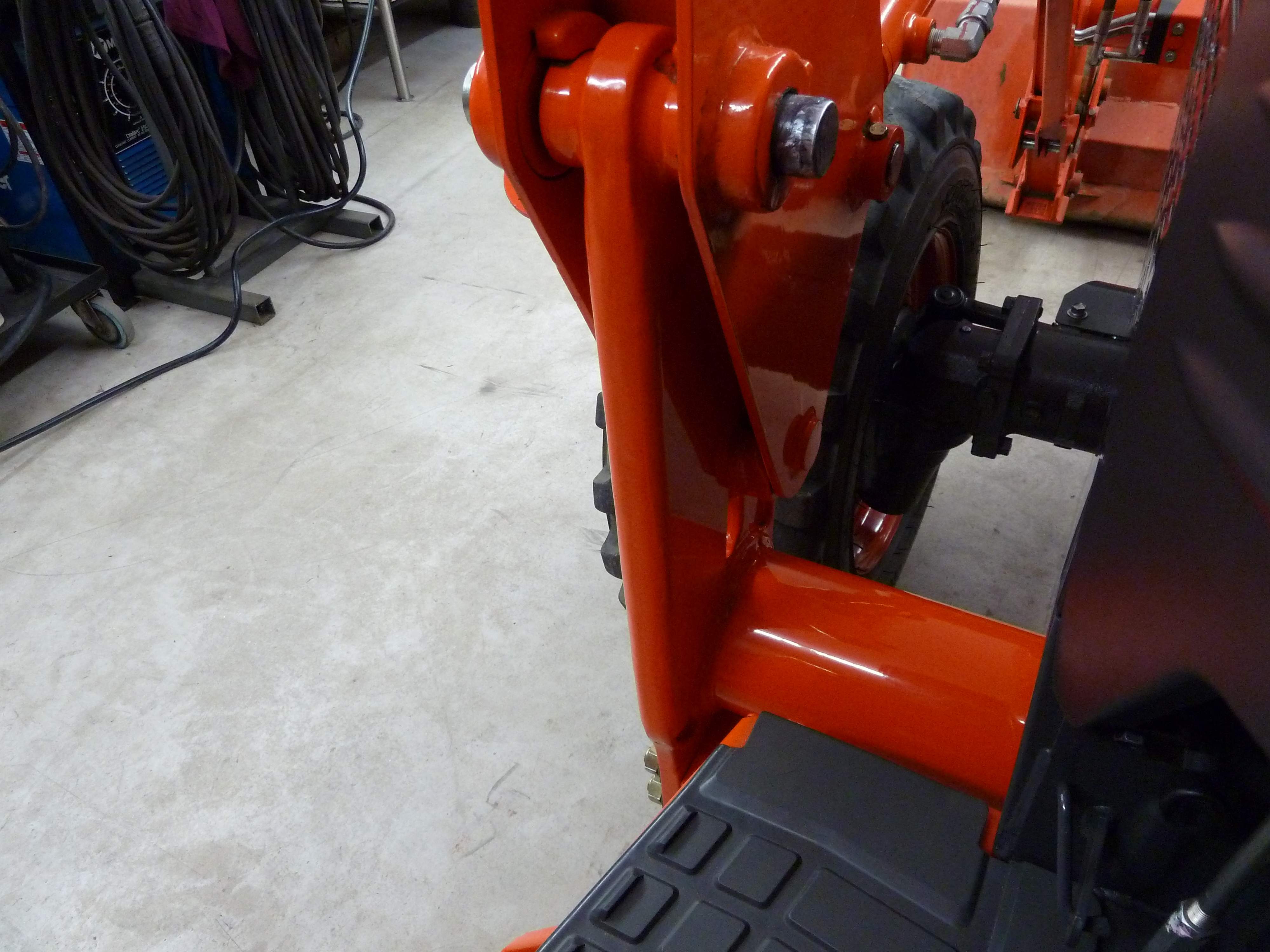

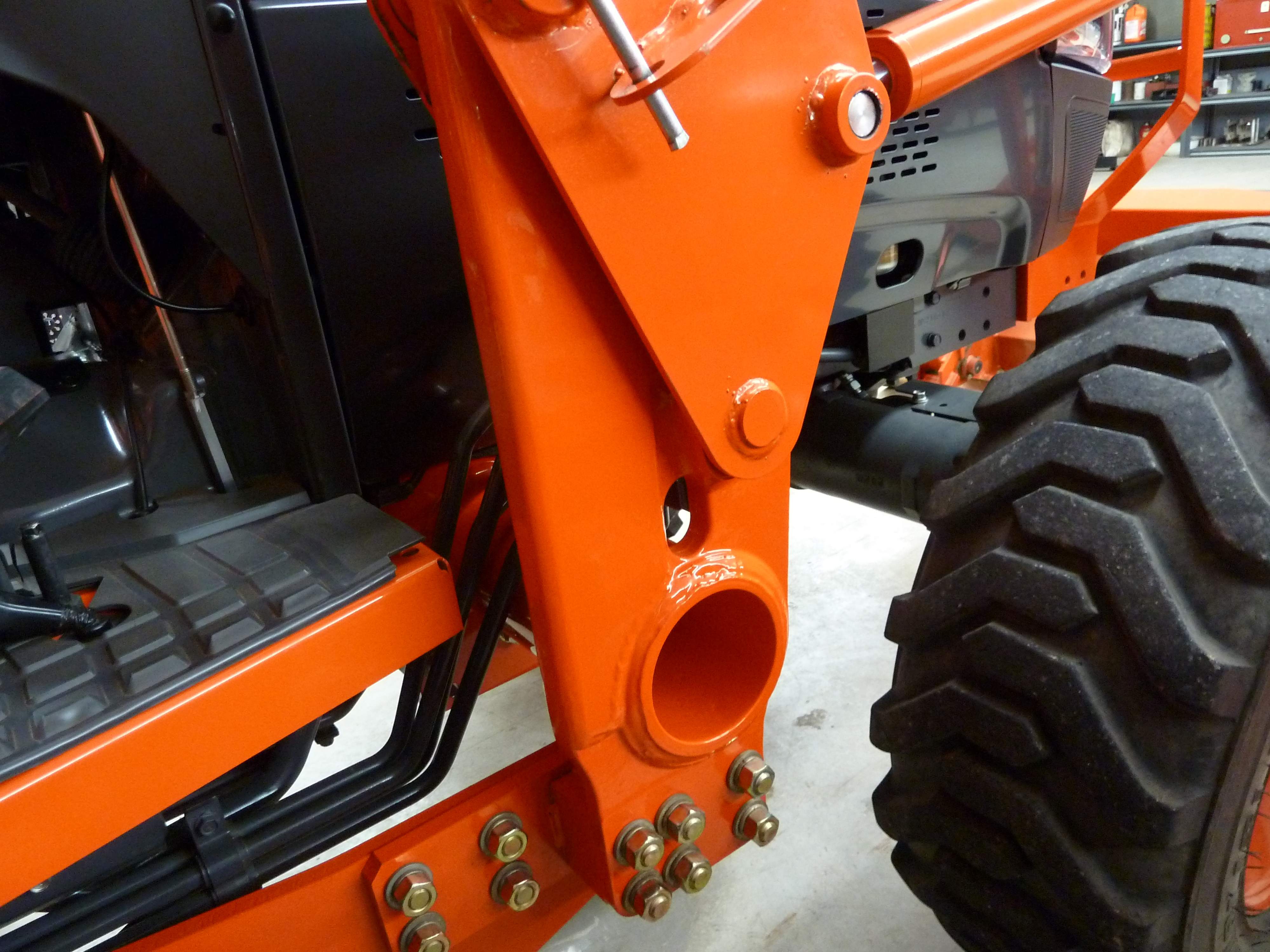

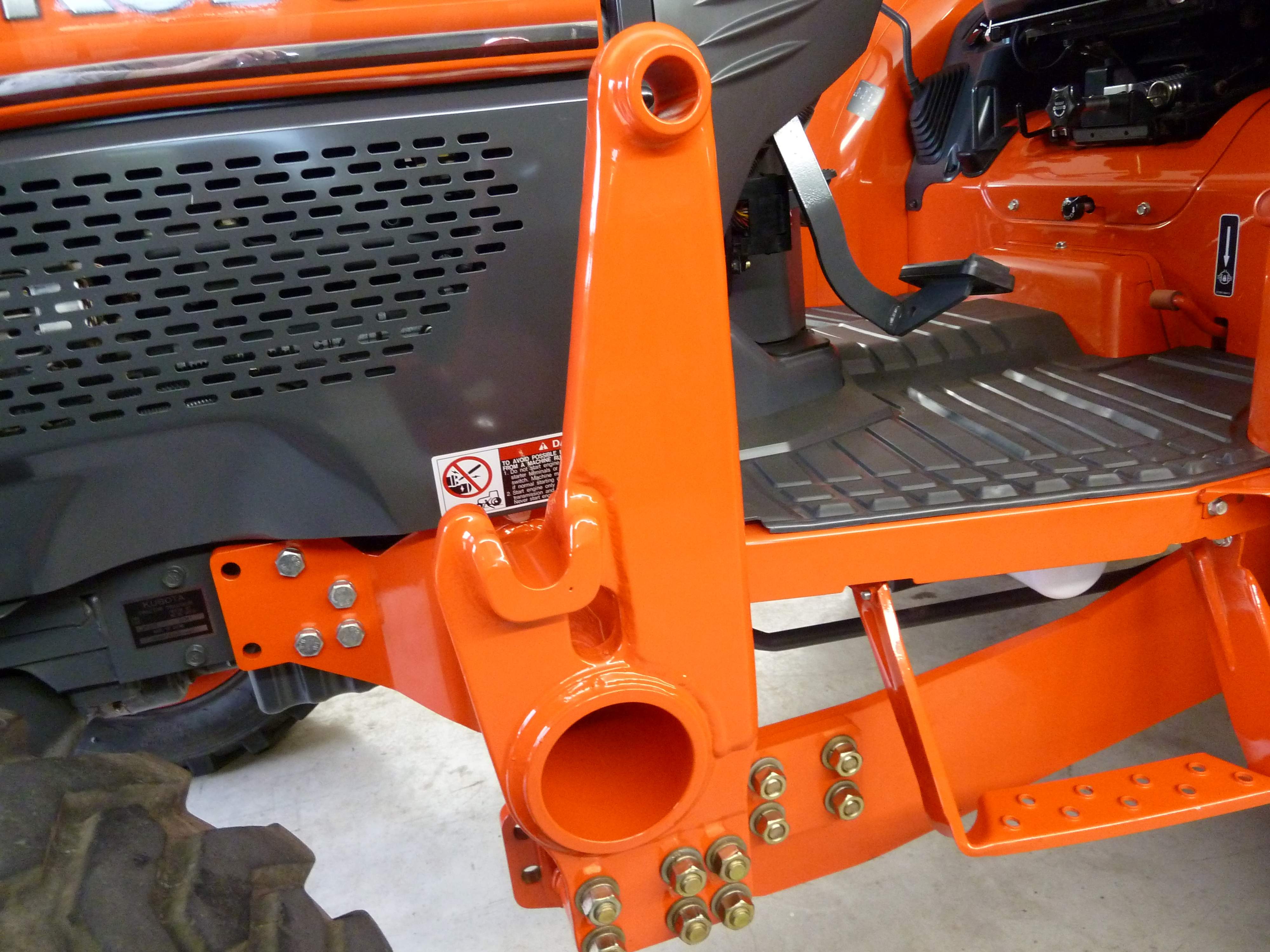

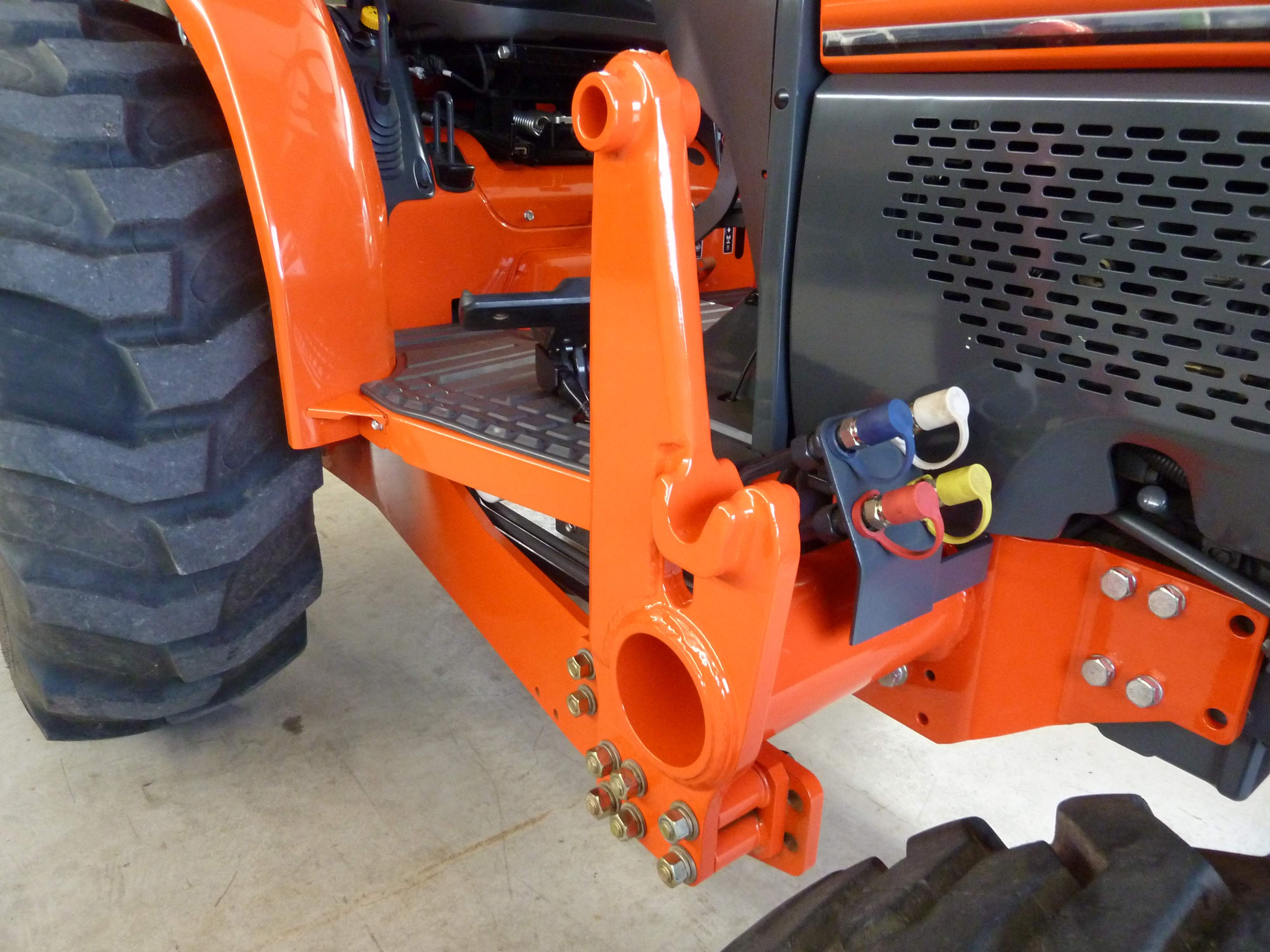

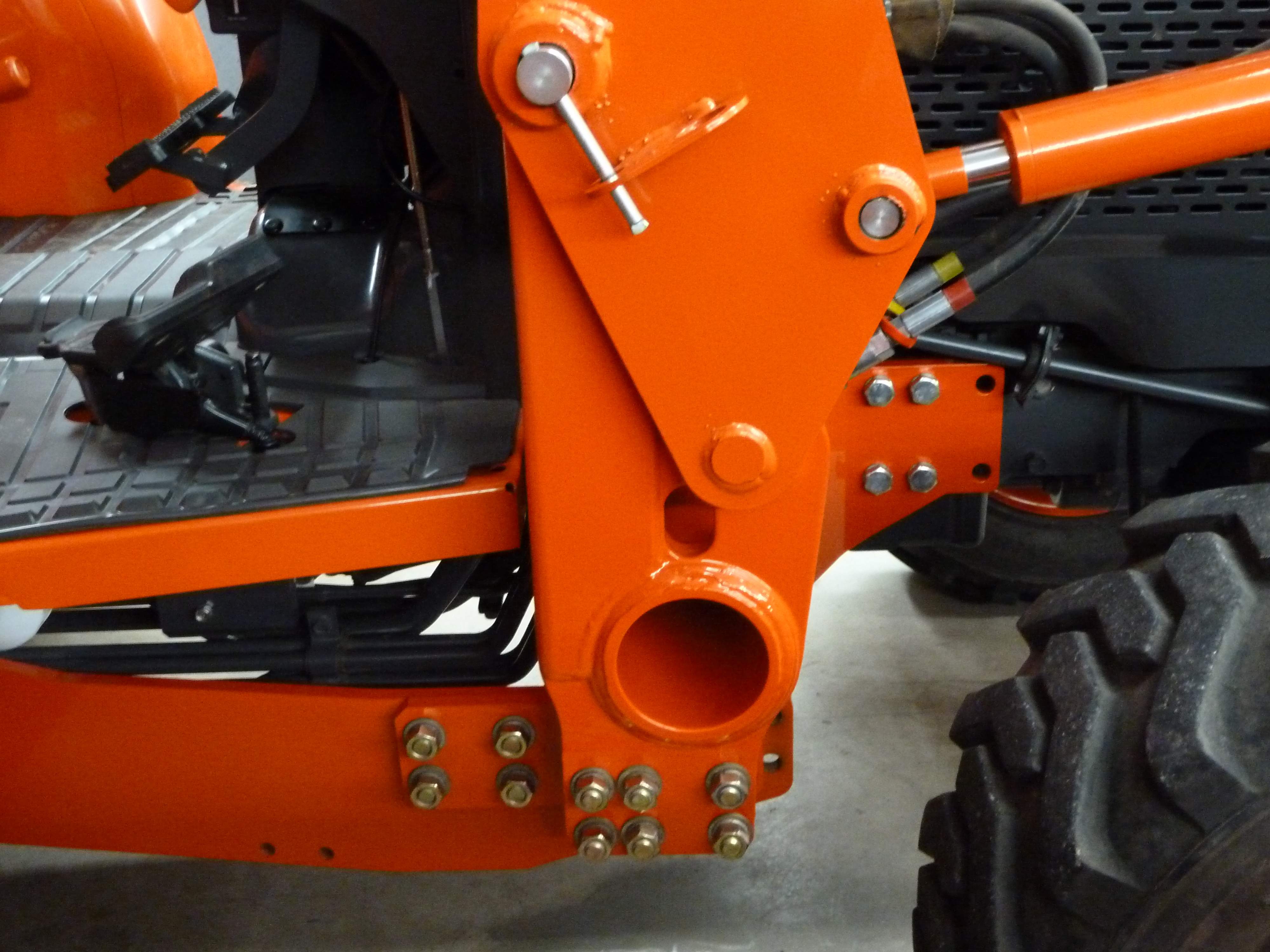

Just got my brackets back from powder coating.It was a bit of a wait but the powder had to be ordered in.The colour is Chevy Orange and matches quite well.The dealer dropped off the brackets and gave me a hand getting them up in place and the bolts started.They could have been installed under warranty but I didn't mind doing it.I torqued all the bolts to 166 pounds as stated in the manual.Thought I would add a few pictures.I added a 1/4" plate to both sides of each bracket which should make them considerably stronger than they were.Time will tell.

First, holy crap your tractor is clean! :thumbsup:
Second, the brackets look great. Chevy orange matches just fine; I wouldn't have known it wasn't Kubota orange if you hadn't posted that it's not.
Third, do you think you'll do anything different, as far as sliding the loader on the ground with the BH, etc.?
   / Broken Mount For LA724 #90
First, I will second the "holy crap your tractor is clean"!:D
Second, I will say that is one of the best looking support bracket addition I have seen in a long time. Maybe it's the paint job but I don't think so it surely looks professional. Thanks for the pictures.
