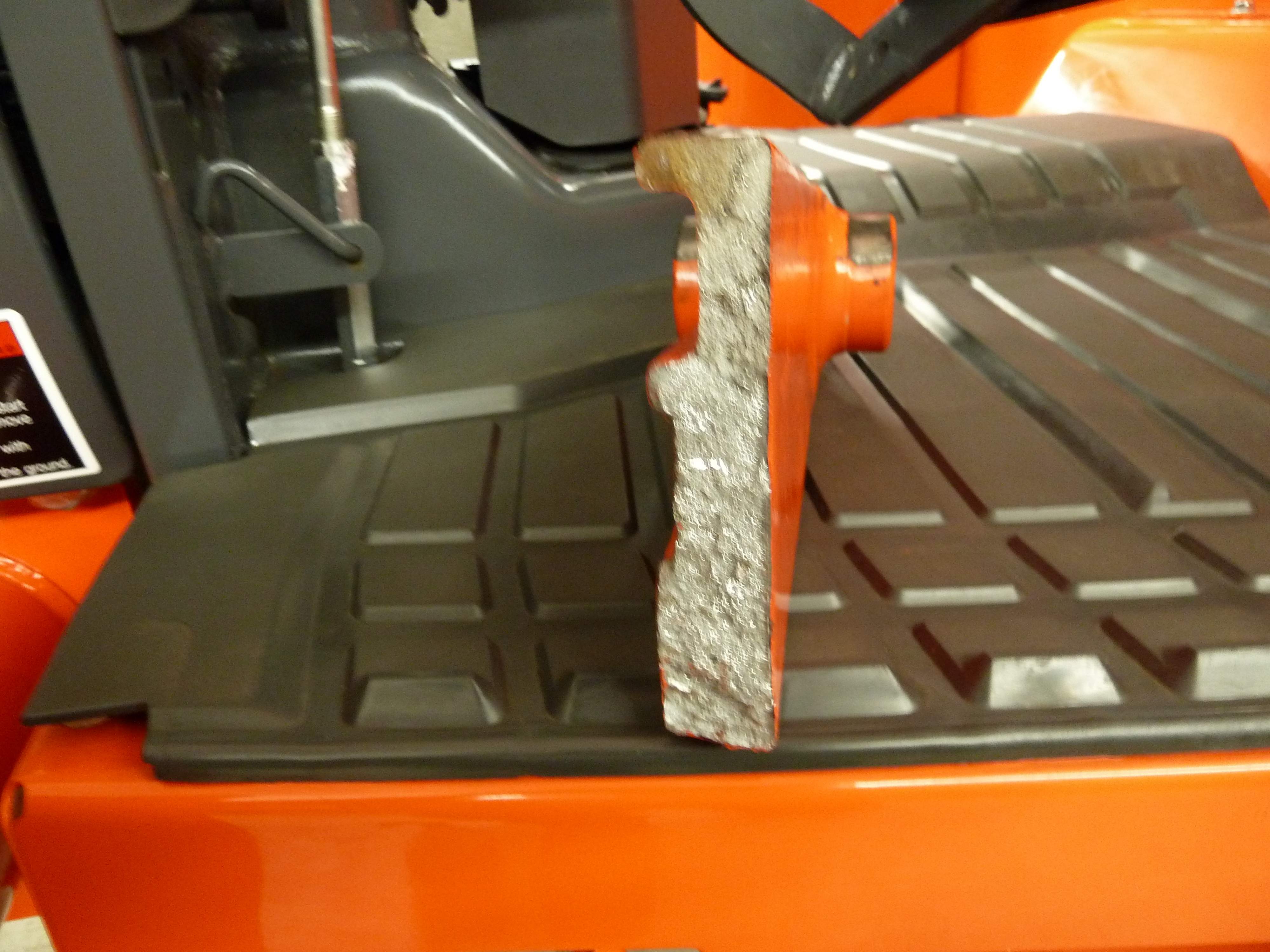

I was using the backhoe and moved the rear of the tractor over to reposition it when I heard a loud snap.I got on the tractor to use the FEL and noticed it was lopsided,looked down and saw the bracket broke clean in two.After going back to the garage I was able to get the loader off.I called the dealer and he said he would come down Saturday to take some pictures and send to Kubota. The loader has a 12 month warranty and the tractor is 15 months old so I am thinking Kubota won't do anything about it after reading other posts on here about similar situations.The tractor has 530 hours on it and most of that is FEL work.I do use it but I don't feel I did anything with the loader that I shouldn't have.When I use the backhoe I lay the FEL bucket flat on the ground so that it will slide when I reposition with the hoe.Maybe moving the tractor around with the hoe is not a good thing to be doing but I thought it was common practice when using the backhoe.After looking at the other bracket I noticed that it has a crack in it as well.You can see from the rust that the broken bracket also had a crack for a while before it broke.I will wait to see what Kubota says but I am thinking I will probably end up welding and reinforcing both brackets.I make my living as a welder so I feel confident in doing this if it is necessary.This incident has kind of left me soured on tractors but that will probably pass with time.I guess tractors are not industrial machines like a real backhoe and are only made to do light work.I never really envisioned something like this happening from the work I was doing with the tractor.Curious to see if anybody else has had a similar problem.The tractor is an L3240.

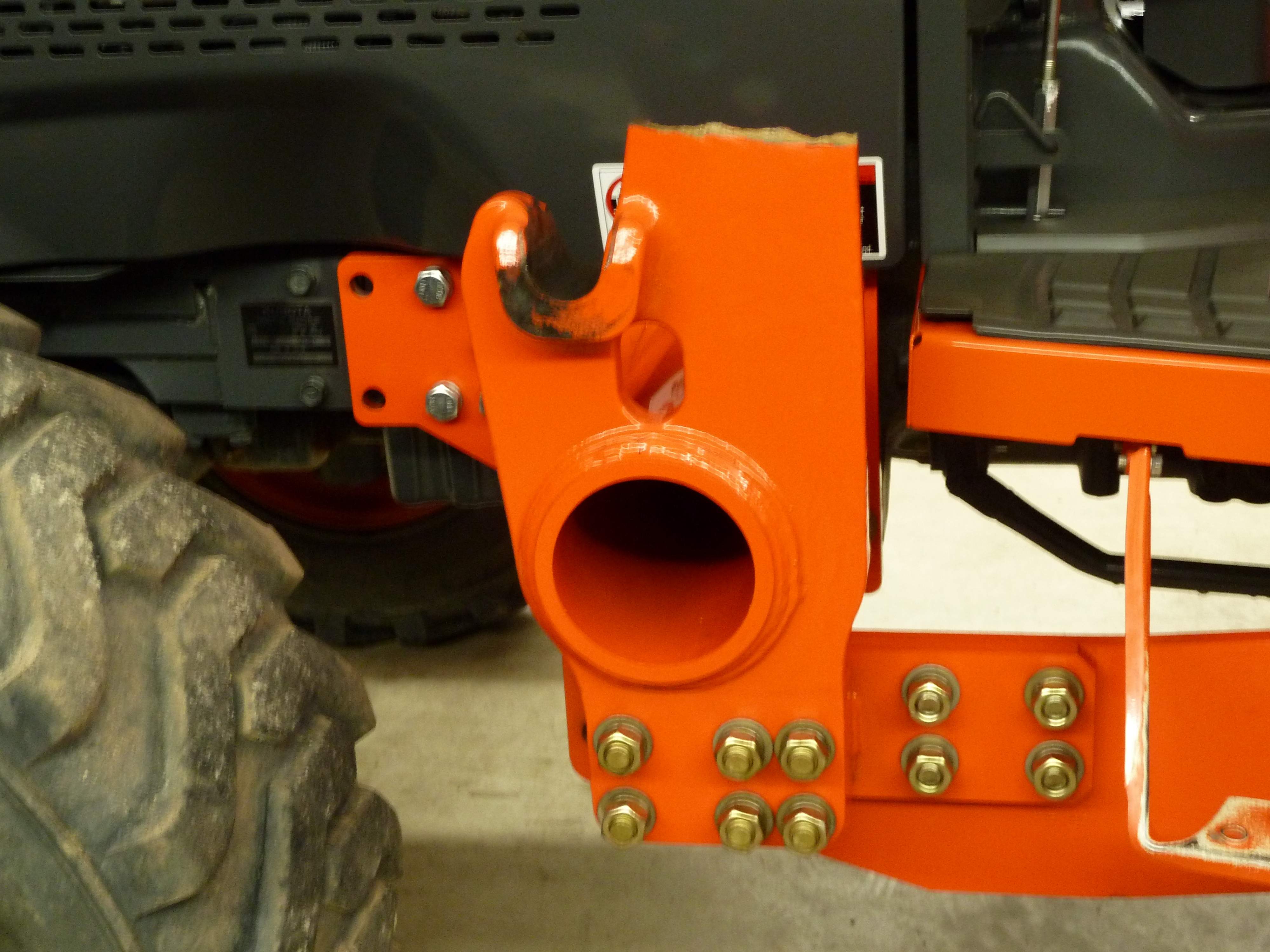

I don't have a BH myself, so not knowledgeable about moving the tractor around with it, but your 4th pic, the one showing the crack that hasn't broken yet, makes it look like there's been extreme side forces put on it ... when the bracket's real strength is +90 degrees to that.

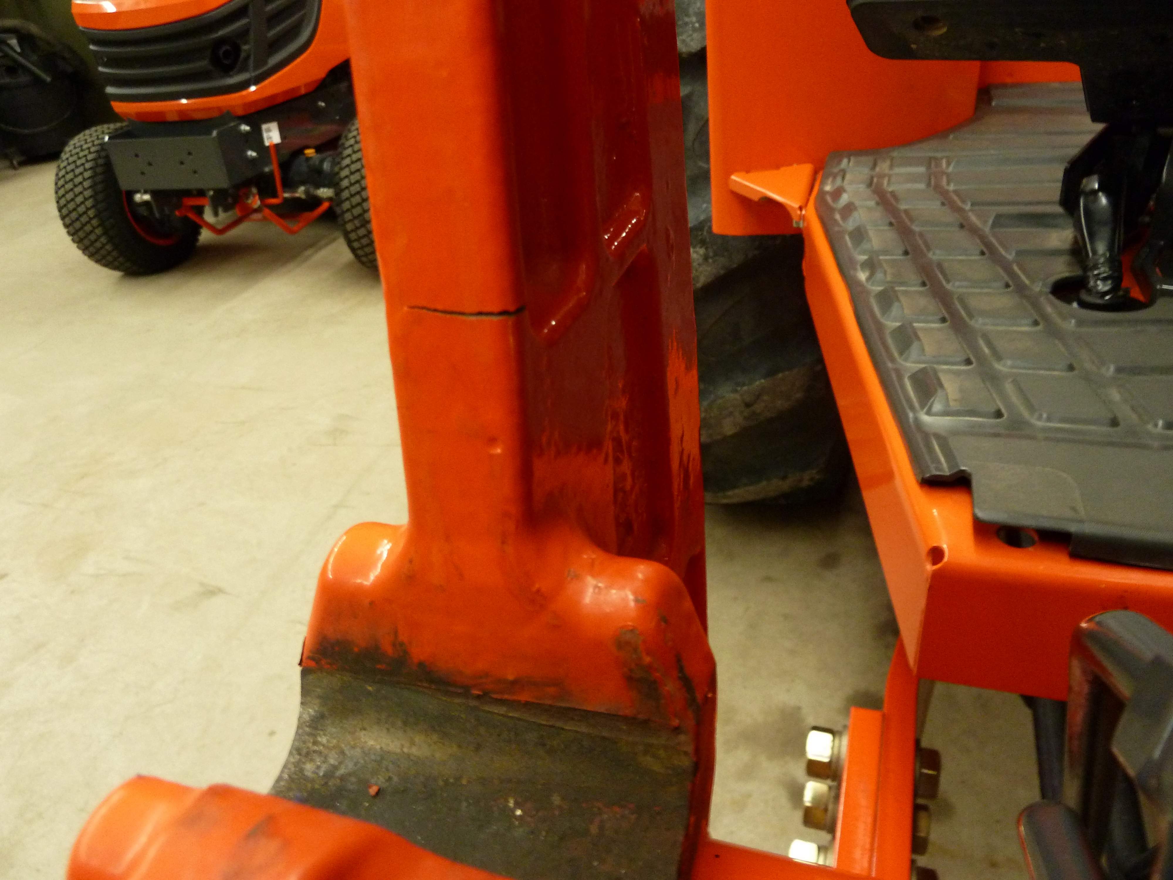

The 3rd photo showing the cross section of the failure tells an interesting story. Assuming nothing contaminated the break after failure, the rusty/dirty area indicates a hairline fracture that began some time back.
The fracture then propagated into the bracket. This propagation eventually led to total failure of the bracket. The question is what caused the initial fracture. Either the part had a stress concentration in this area, the material tensile strength is below normal, or the bracket was subjected to an overload condition.
Have you ever applied shock loading (impact loading) to the loader when driving forward? A good example would be ramming a stump or large rock.
Good luck with your repairs. A good welding shop could fix this failure by welding back together and then adding scab plates on either side of the failure. However it won't look pretty. A new bracket maybe the best solution.

Is that bracket steel plate that's laser cut or is it a ductile iron casting? Almost looks like a casting but I can't tell for sure.

Absolutely. The rusted area is evidence of an earlier crack so it was just a matter of time.

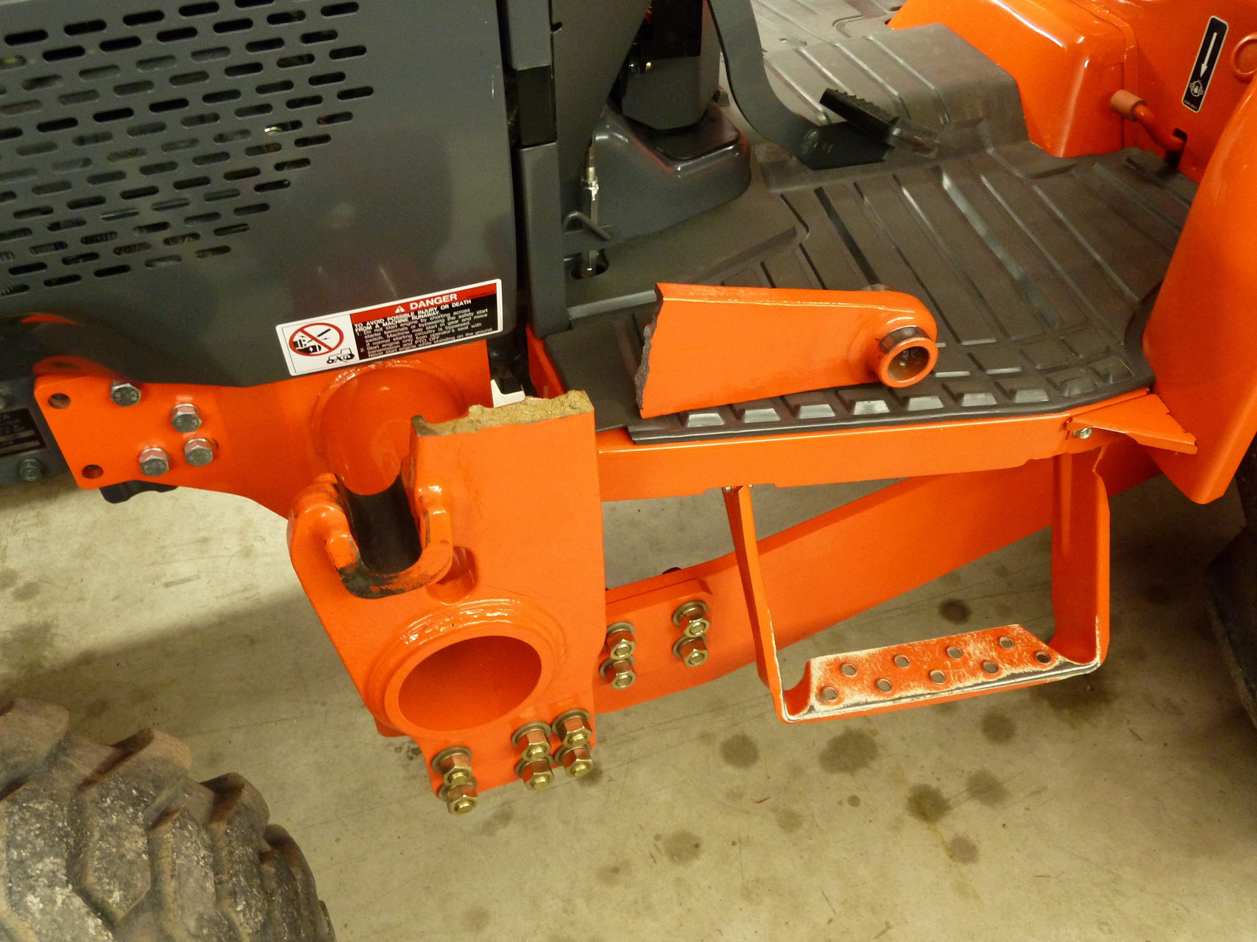

Looks to be cast - have a peek at the inside of the remaining upright that is not broken off in picture no. 5 ..... see the indentations from the mold in the casting ?

The material is cast steel that is weldable similar to regular low carbon steel.The only difference is that I would preheat it to about 100 degrees before welding and wrap it in fire cloth after welding to let it cool slowly.It has been welded from Kubota with a wire feeder process,probably flux core but I would have to use 7018 stick which is just as strong but slower to apply.I will also add some 1/4 inch plate to the inside making sure there are no straight horizontal seams.I really don't want to start a discussion on welding as these are never ending.As far as the tractor goes I think most of us try to do too much with them at some time or another.I put this on here as a matter of interest for viewers,not to complain.I was using the tractor too hard obviously and this is what happened.It will get fixed and life goes on.It just reinforces my belief that in hindsight I should have spent my money on an actual backhoe or at least a TLB but I guess this is how we learn.Hindsight is 20/20:cool:
