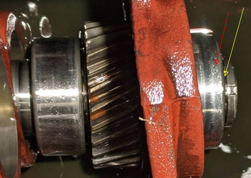

There's a groove at the yellow arrow, but we can't see inside the piece marked with the red arrow to see if there's one there also.

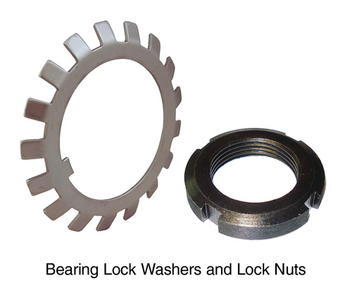

The yellow arrow is not a groove. Just a bearing retainer/lock nut with a locking tab washer. The red arrow is the bearing.
   / broken pto, need advice #29
The part with the red arrow pointing to it looks like the outside of the outer race of a ball bearing. Assuming that's what it is, there needs to be something to retain that in the cases so it does not get pushed out again. It'd be an inside clrclip that fits into a groove in the case. It's hard to tell from the pics but the web that the bearing goes in looks just thick enough to hold the bearing and a clrclip groove.

Yes, the web hasa groove in it. I couldn't see it until I drove the shaft and bearing all the way in. I will see about getting my camera down into there and get a photo tomorrow.
