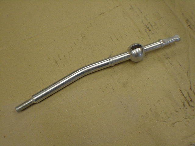

Should there be an o-clip or a c-clip that hold the spring in place? When I took it apart the bottom of the shifter was broken right below the ball.
The clip that holds the spring in place looks like a c-clip ..... Is this right? Or should this be a full circle?
Should I try to get the Tractor shifted in neutral before I put everything back together?

"C" clip is correct, you should be able to work/pop it out with a screwdriver and some needle nose pliars. There should be a dome or washer under the c clip, with a spring under that? You may need to put a little pressure down on this to compress the spring a little which will free up the c clip in it's groove to allow you to remove and re-install the c clip.
You don't have to shift it back into neutral to re-install the top cover and new lever. You do need to make sure the new shifter end goes into the proper position to engage the proper shift dog. IE: the shift lever is in the position for the gear that the tractor is currently stuck in.
Glad it was something simple.

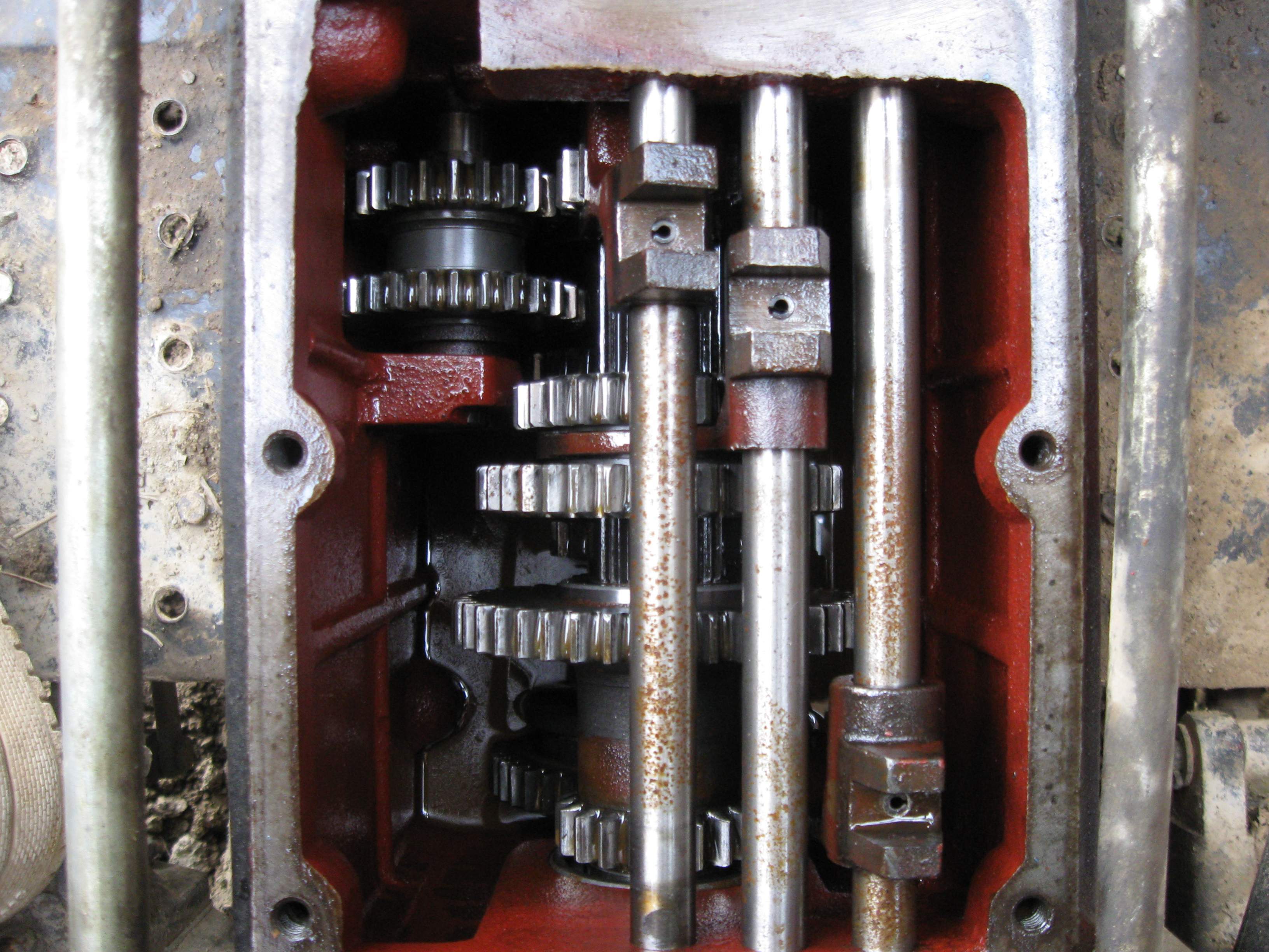

Ok, so I put everything back together and the c clip keeps comming out of place.. Does the c clip have to face a certain way? I am having a problem getting everything to line up right. Can anyone tell by the picture if this is in first gear or 3rd? I think it was first gear that I was in but I may have been changing from 3rd to first when it broke.

Well looking at that pic, that transmission is either in reverse or third gear. IE: if the stick was pushed to the right and rear(reverse), that would cause the short end of the shift lever to engage the left shift rod and push it forward. Conversely if the stick was pushed to the left and forward(3rdgear), that would cause the short end of the shift lever to engage the right side rod and push it to the rear. If it was in neutral, the two dogs would be side by side. If you were in 3rd, you should be able to push in the clutch and push forward on the right rod and get back into neutral(dogs side by side).
Could be the clip deformed a little bit when removed. You could try bending/expanding it and see if it stays put, but i agree with Chris, try finding a replacement at the hardware store. It will probably have better spring characteristics than the original...

The 1st/Reverse slider is in the 1st gear position. However I can稚 tell from the angle of the picture whether the 2nd/3rd Slider is in Neutral.
Here is a picture of the transmission in Neutral. I suggest that you move that 1st/Reverse slider back so that the gear it moves is between the 2 gears below it as shown. Then adjust the 2nd/3rd slider if necessary so the they are next to each other as you can see. This should put your transmission in Neutral so there is no dilemma when installing the gearshift and cover.

Thanks everyone for your answers and support. Gotter up and moving again! Shifting the tractor in neutral was the best way I found to get the job done, as I was unsure on what gear I was in. I may take in all apart again as I ripped the gasket in the process and want to get replacement parts and do it right next time.

Oops, RonJ has it correct, I got first and reverse backwards:(.
