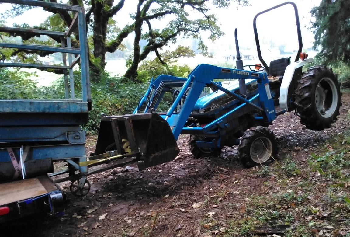

Dang, I wish the hydraulics on my Kubota 3301 were strong enough to do that. Even with no rear ballast like in this pic mine would never raise the rear wheels off the ground. I guess in a way that's a good thing because you stand a much better chance of not bending or breaking something.
The hydraulics are the only disappointment I have with this tractor. When I bought it I told that salesman I wanted something I could at the very least pick up 1000lbs. This thing has a hard time lifting 500lbs off the ground, never mind doing with it once off the ground.
The bucket hydraulics seem to be rated for the tractor weight. Fortunately the actual loader seems to be much stronger than what the hydraulics can handle, although some people have managed to bend loaders in one method or another.
Many tractors seem to be able to barely lift enough to hit the tipping point with no rear ballast (or only tire ballast).
In the picture with the Ford, I was pulling a scissor lift off of a trailer, and had forgotten to add ballast back on the tractor after putting the draw bar on earlier. So, when I pulled the lift past the end of the trailer, I got a lot more weight added to the bucket and wheels came up.
I have modified the front axle stops to keep it from rolling to the side. Inconvenient for some things, but safer when using the bucket.
I am surprised your tractor has a hard time lifting 500 lbs. off the ground. According to TractorData.com Kubota L3301 tractor attachments information it should be well over a 1000 lbs. I have a Kubota L3010 (abt 2002 vintage) that picks up over a 1000 lbs. with no problem. In fact I have lifted many things that heavy with it, just have to be careful because accidents can happen way too fast.
