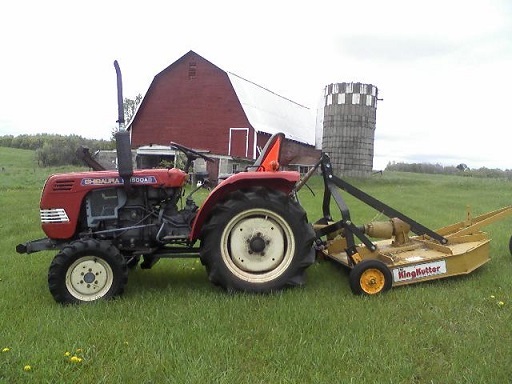

If he could mow 80%-90% of his needs with a 4' or 5' mower, then do that and use the DR walk behind for the rest.
He could get a 48" cutter for his Deere 4310 which is 50" wide.
I had a 15hp Shibaura with a 48" cutter and it did amazing work, but I will admit to puckers on side hills!

Have him buy one of these lol, fit it with knobby tires
