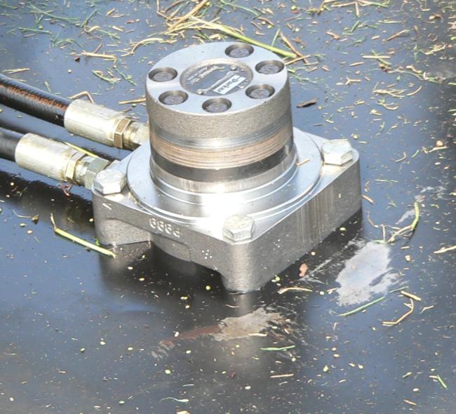

About a month ago, my 48" brush cutter seized up. It was running fine, squealed for about two seconds, then locked solid.
I have always thought the design of this model with the motor bolted directly to the deck was suspect. Unlike the older variety, there is no Lovejoy coupler to temper the impact shocks from the cutter. On the model I have, they are absorbed directly by the motor. The cutter only had a couple of hundred hours on it. Most of those were cutting tall grass. It only had about five hours of brush cutting. This was a failure that shouldn't have happened.
The first thing I had to do was identify the motor. Power Trac had thoughtfully painted over all the identifying information on the motor. :mad:
I figured I should be able to find out who made in in a couple of hours of web time. It took me two days. It was made in Bulgaria by M+S Hydraulic and labeled for and sold by RR USA Inc. It was not comforting to find out that M+S Hydraulic was founded as a state owned enterprise back when the communists ran the country. Of course neither M+S Hydraulic nor RR USA have service information on their web sites, unlike Parker, Eaton, et al. Thank you Power Trac.
I called one of the few distributors listed by RR USA. As I expected, I got a "Yeah, we handle those, but we don't stock any of them or have any parts, but we can order some for you."
He got back to me a couple of days later. $850 for a motor and $86 for just the seal kit, plus freight. Whatever replacement parts were needed would be extra. :eek: The whole cutter only cost $900 brand new.
I called Power Trac. They wanted almost $500 for the motor. This may the first time that Power Trac has ever been cheaper on parts, but it was still too much, as far as I was concerned. I decided to try and find a name brand replacement.
After a lot of browsing PDF catalogs and much web surfing, I decided to try a Parker TJ series motor, which turned out to be a bit difficult to find. I expected to be able to order any Parker product from Precision Fluid Power, but they could not get the TJ series for some reason. Nor could a couple of other suppliers I tried. Finally, I found them at Hydraulic House in Orlando. Best of all, Hydraulic House is a discounter.
Of course, they don't actually keep them in stock. It seems that they are a build to order product with a ten or twelve business day lead time, depending on whether you want the motor painted or naked. I went with the bare metal in order to get it sooner.
The motor was built in Greeneville, TN, which is more or less right up the road, and a whole lot closer than Bulgaria, if I ever need parts. It fits perfectly. The total price including shipping was $350.56.
The full part number is TJ0050US080AAAAB.
The picture shows the motor after I came back from testing it in some really tall grass. It worked fine.

So all your bolt holes, fittings, etc... were exact size? Very good! :)
/ Brush Cutter Died -- The Search For A New Motor
Yes, it is a drop in replacement, with specs that are almost identical to the original. The mounting, fittings, and shaft are all the same.
I found another model, an Eaton if I recall correctly, that I almost ordered. At the last minute, I realized I had not checked the nose diameter. It turned out to be a 1/4 inch or so too large.
These are 50 cc wheel motors, and they appear to be a relatively rare animal. A couple of makers have motors that would physically fit, but are of a larger discplacement. That means they would turn slower, and I felt that they probably wouldn't cut as well.
BTW Moss, if you ever need a motor for your "old style" cutter, you shouldn't have any trouble. The woods are full of those, for a lot less money, too. :cool:
Alas, they won't work on the new models. Again, thank you Power Trac. :mad:

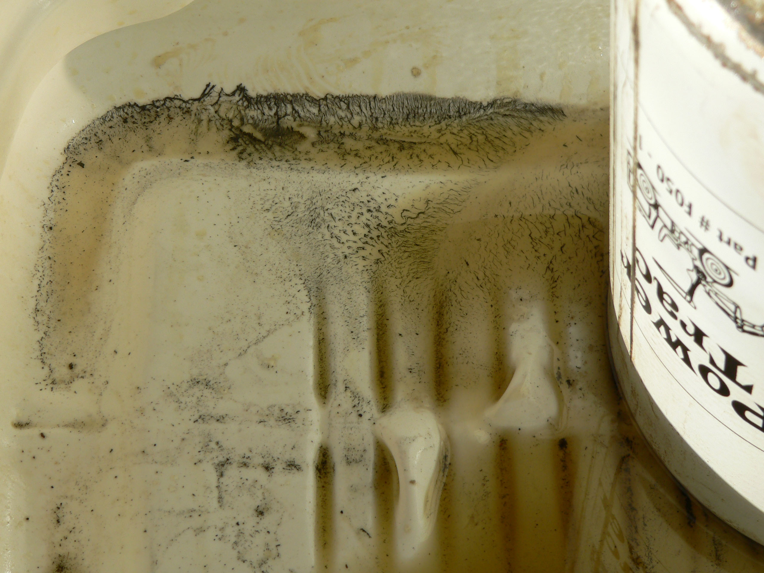

By the way, I put several strong magnets on my hydraulic filter to pick up metallic trash. An old car of mine used to have a magnet on the drain plug, which always had some debris on it, and I thought it was a good idea.
On my latest filter change (100hr), I let the filter drain into a white pan to see how much magnetic material had been retained. When the filter drained, the oil looked black, but on standing, it all settled out. All of the black bits that you see in the photo are magnetic, i.e. pieces of metal that would have been circulating through the wheel motors.
YMMV...
YMMV...

Peter -- anything unique about those magnets? Where did you get them?
/ Brush Cutter Died -- The Search For A New Motor #14
Hello Kent. Some of the guys have put hard drive magnets on the hydraulic filter. You could put them directly in the tank, or put one on the hydraulic oil drain. I think anyplace you can put a magnet is a good idea. Some people also put them on gas lines to orient the molecules so that you get better performance. I really don't believe that it works, and it sounds like a con, however someone reading this will state the scientific reason behind this concept. Reminds me of the dowsing rods thingy used to find water. If that were true, you could walk out in the water of a lake and get perpetual motion. I know somebody will say that their grandpa did it. No one to date has had good repeatability.
/ Brush Cutter Died -- The Search For A New Motor #15
Nothing special about them. I just put a couple of the HF 100lb pull retrieving magnets on. They are cheap, $5ish, and strong. On the prior filter, I had some smaller magnets on. KJmagnetics have lots of cheap neodynium magnets that are a lot more powerful.
I think the magnets in the tank is a better idea, but I don't yet have a reason to remove the fill plate and punch holes in it.
