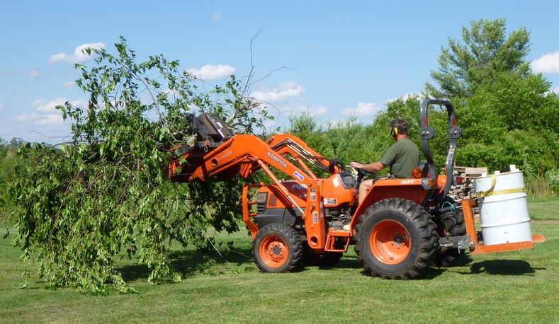

I love my bolt on grapple, I can grab enough brush to the point where I can't see where I'm driving... great for logs. Couple it with a tooth bar, you'll never need to remove them. Pin on bucket....

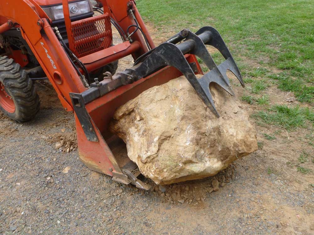

I move large rocks, chunks of pine tree trunk and backdrag, collect and move brush/small rocks with my grapple. Backdragging with the top lid does require some care. Do not want to hook the tines of the top lid on any immovable object. Such as bedrock outcropping or very large tree root. Damage to the grapple hydraulics could result.
However - I've had this grapple for twelve years - used it in this manner - never had any problems.
JMHO - a bucket grapple is going to be much more universally useful than a root rake.
I believe that would do just about any task that I might have need.

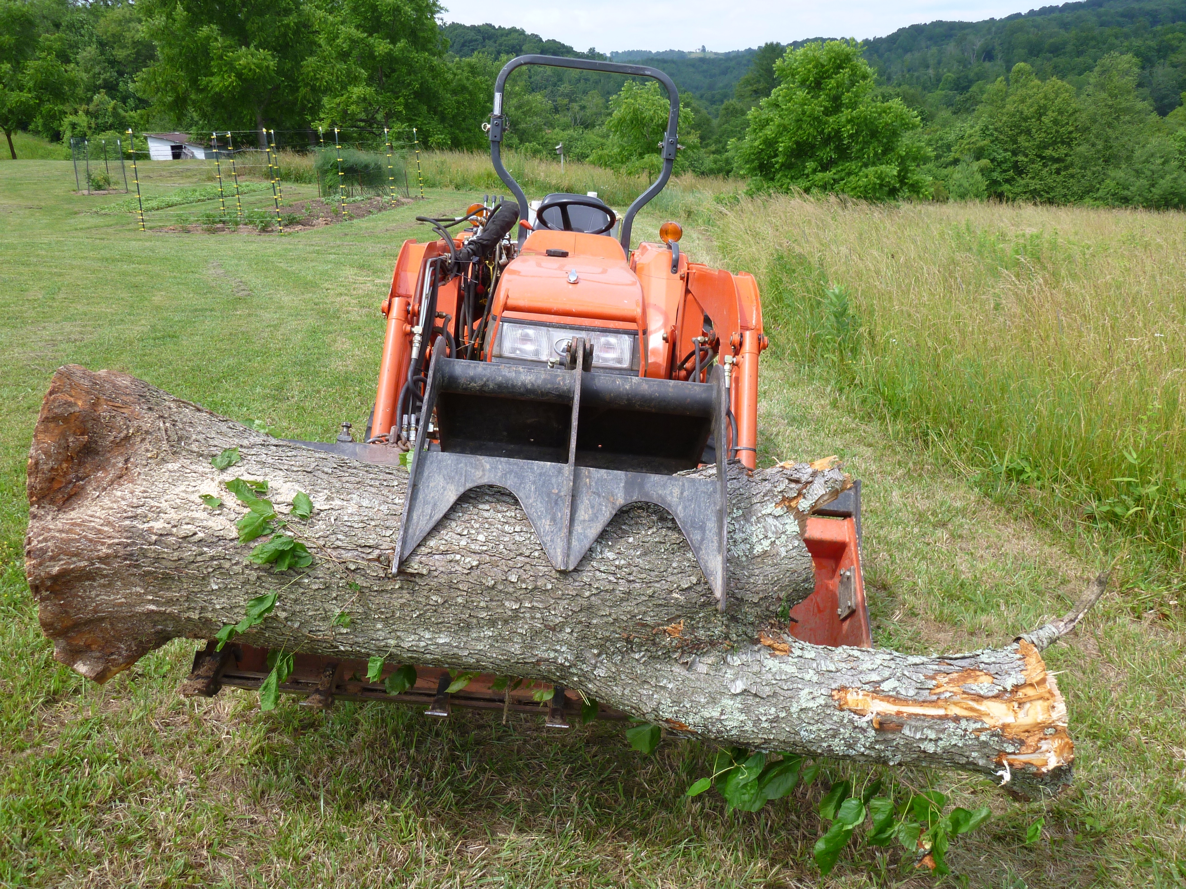

My grapple is called a root & rock style or clam shell style - CalG. Now what old & tired has pictured is a true bucket grapple.
Every style has it's - pluses and minuses. You just have to figure out how you will use the grapple and then get the type that will work best.
There are - at least - four, perhaps six, different styles.
One of the biggest factors - weight of the grapple. The weight of the grapple will reduce the weight that can be lifted.
Another factor - style. My grapple is not the best design for gathering limbs, brush and trash. If that is what you will be doing - then a grapple with long lower tines will work better.
If you still want the use of your bucket - then a bucket grapple will work better. I can still move dirt with mine but not in the traditional way you would with a bucket.
My grapple weighs 820 pounds. It's made of AR400 steel. High abrasion resistance.
I can use it to lift heavy rocks and chunks of pine tree trunk because I never lift a heavy load higher than 6 inches off the ground. It's called - "knuckle dragging". Many times I will leave drag marks in the dirt as I lift and move an exceptionally heavy load. Normally - the lower the load is lifted - the greater you will be able to lift.
