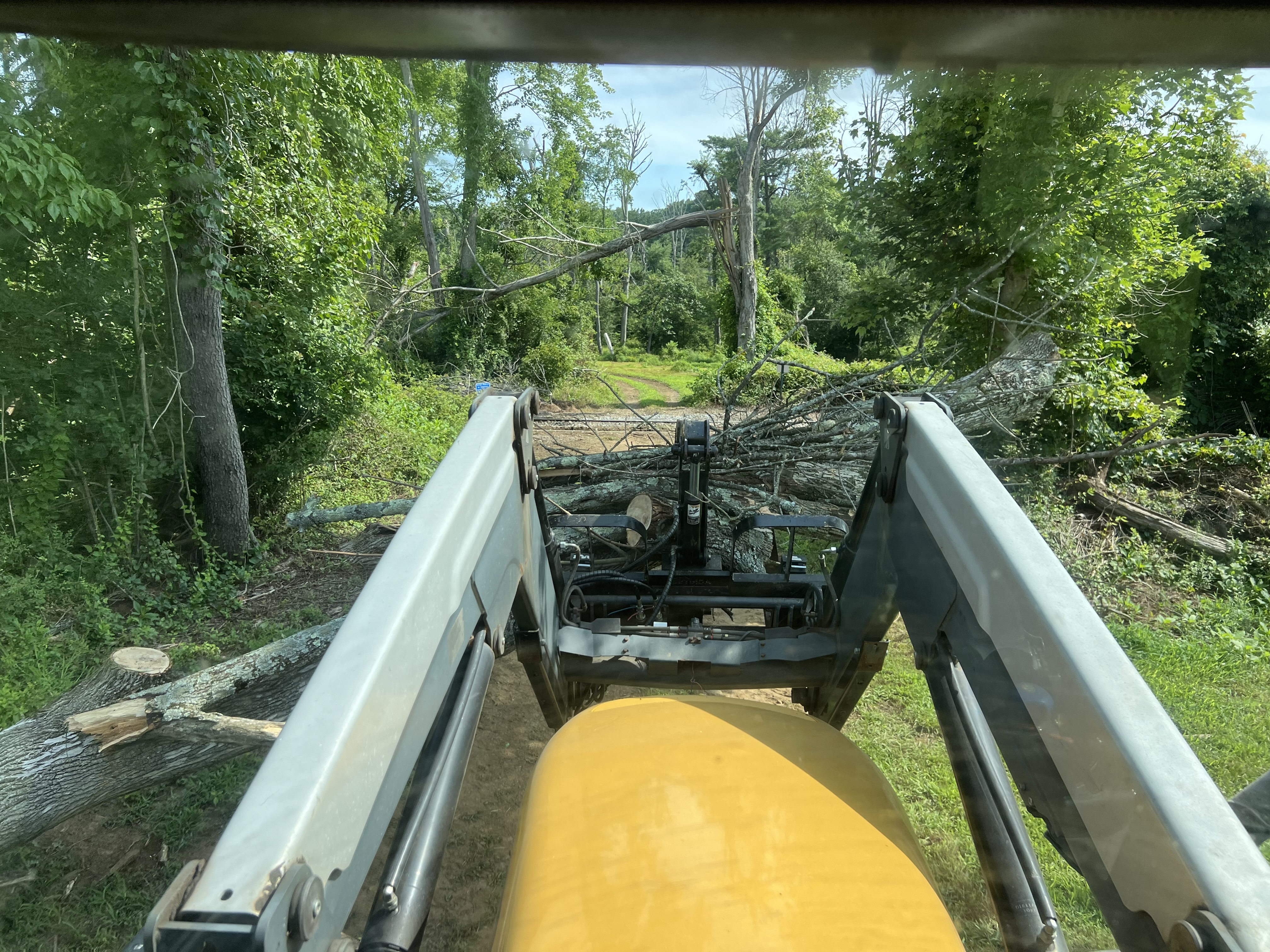

I spent the good part of the day on the Hurlimann , re-stacking walnut and hemlock logs. (they were in the middle of a clearing, and are now off to the side). Also re-stacked the stump pile. It's like turning a compost pile, only to get the dirt to fall off. It's just a bit harder on equipment. Those maple stumps are big and still heavy!
Any way, I sure could have used that "bucket thumb" grapple thingy. I bolted on the bucket tusks, but still had to get off and on the tractor a dozen times to fit the short walnut logs for carry.

Could you post photos of your machine sometime? It's so unique. Do you have a mid-mount ROPS?
   / Bucket grapple vs root rake How to decide?
#15
ROPS is on the Back, like any other US market tractor. I can't say how that came to be. I have never seen another.
There are some images in the hydraulics sub forum from when I put a dedicated loader valve on it. Quite a few years back though
A goggle search of "Hurlimann Prince 435" images sometimes shows /
I'll snap a pic or two in tomorrow's light.
(image snagged from the internet, not mine, but just like it , down to the Allied loader. Mine has a small bucket though
