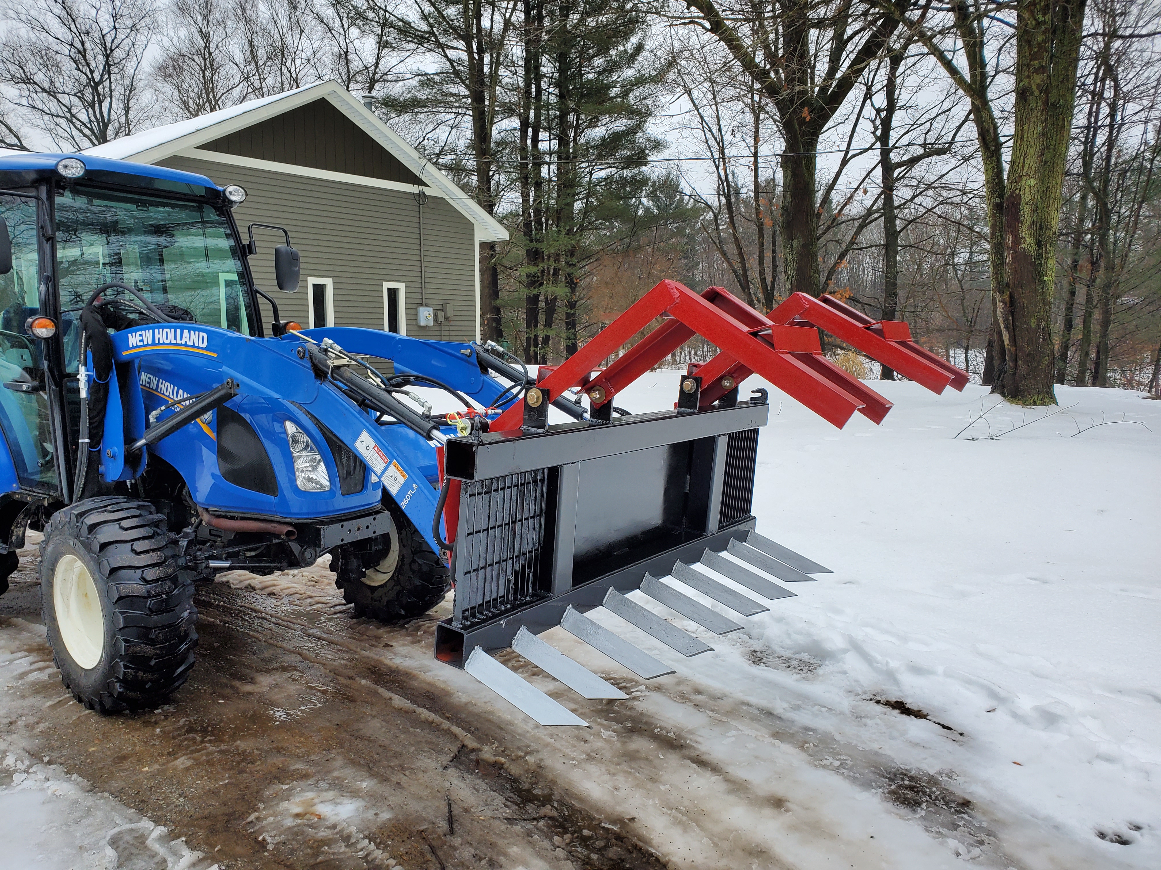

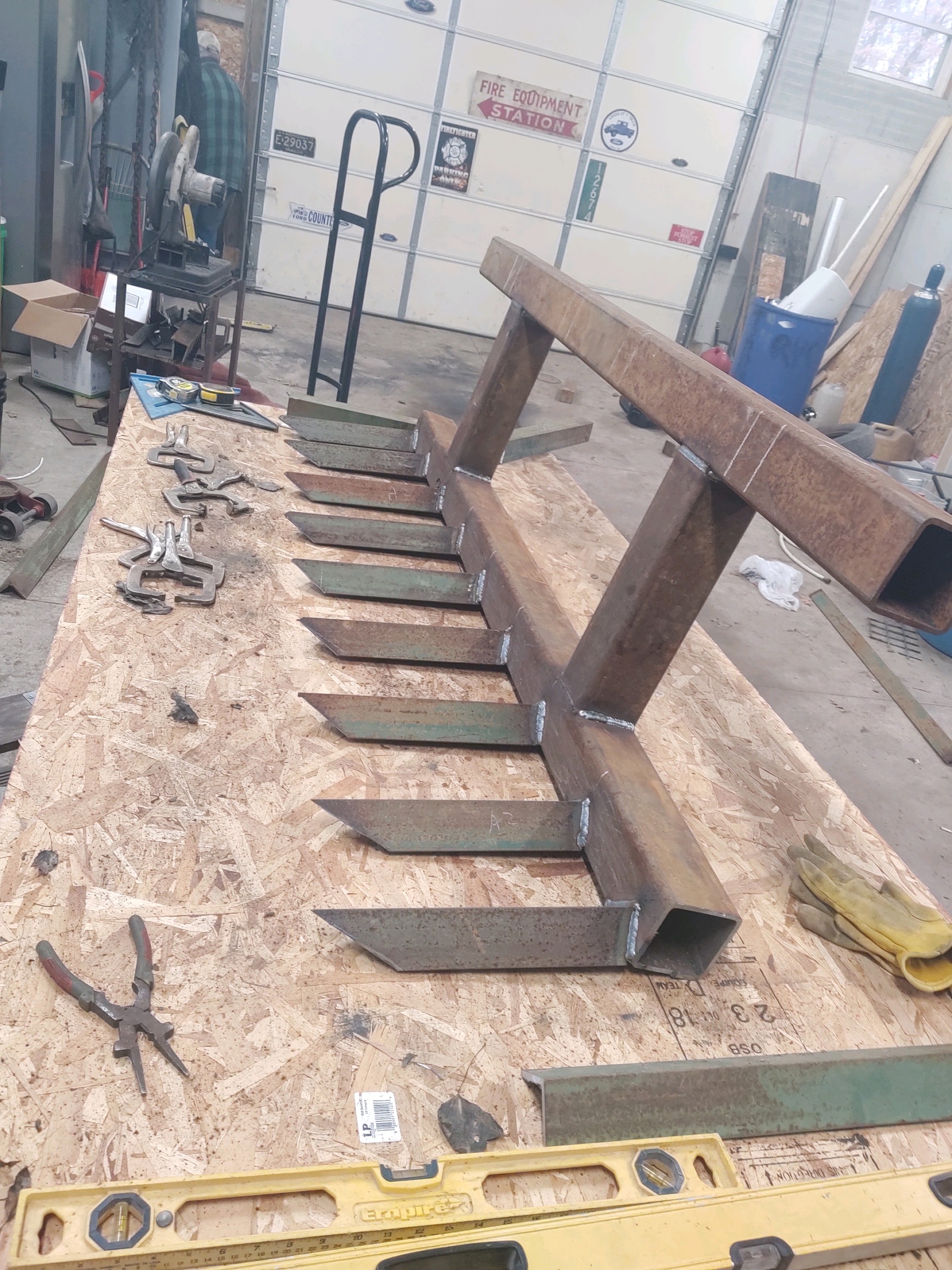

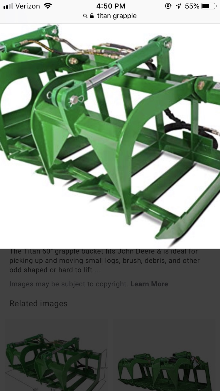

I'm trying this. Just finished it. As OVRSZD said, I might use it for bigger things than it was built for. I'm hoping it works for me though.
Your cylinders will destroy the angle iron that the top ends of them are fastened to.
I like your concept. But it has to be overwhelmingly strong at the cylinder point and at the hinge point.
/ Brush Grapple #23
I didn’t want to be the first one to be Debbie downer again but yea there’s numerous wear spots in that design. I doubt the angle iron teeth are strong enough and I give the lids close to zero chance of surviving.

I was thinking the top pin would be my weak link. First attachment made. Still learning. Not much cost into the metal. All scrap so far.

I'm not sure what angle iron you are talking about. I used tubing, flat stock. and one piece of c-channel for the mounting plate. 1/2 inch solid stock is inside the cylinder mounts to prevent deforming and to not have to drill through 1" solid steel at 1" holes.

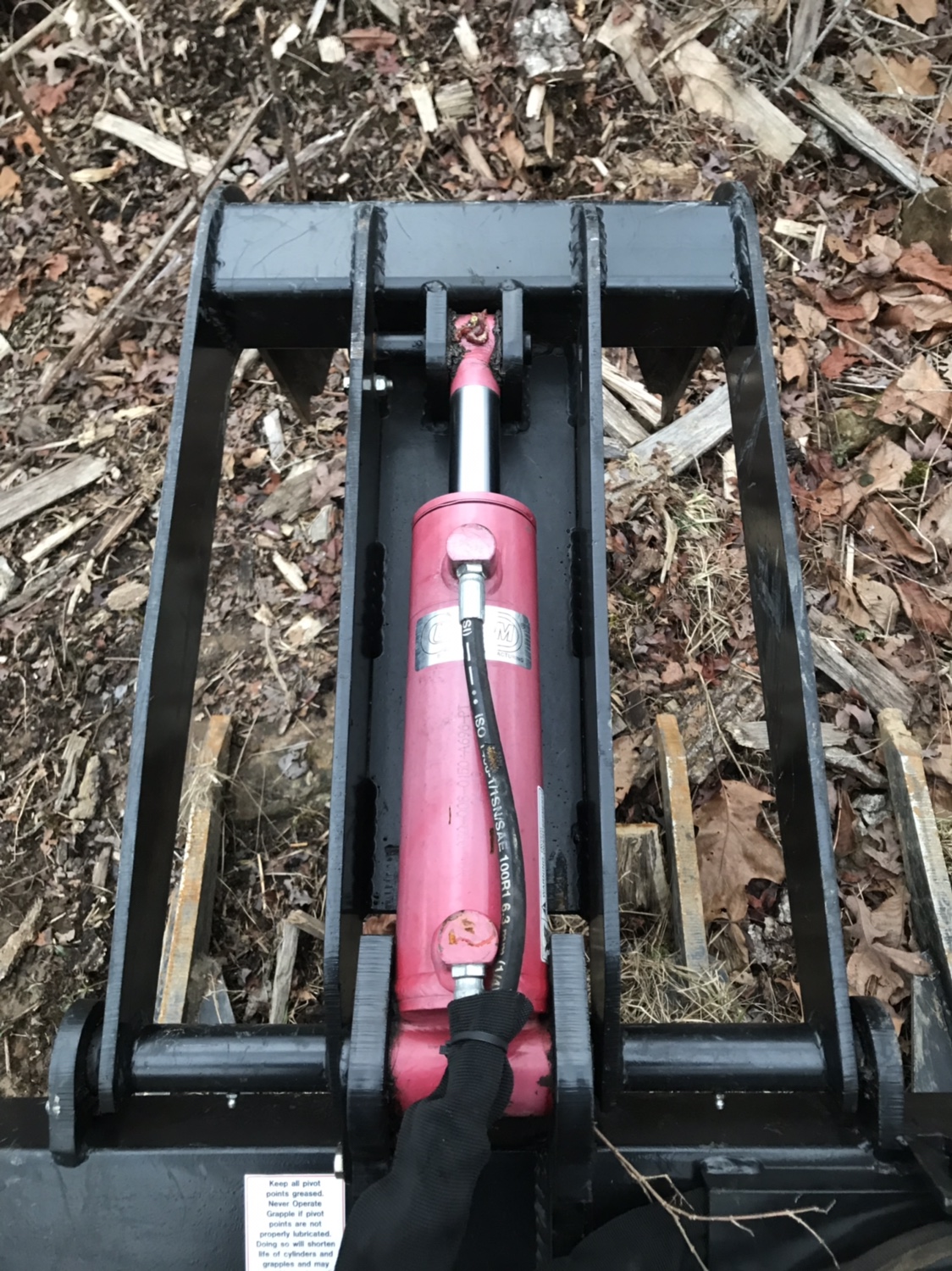

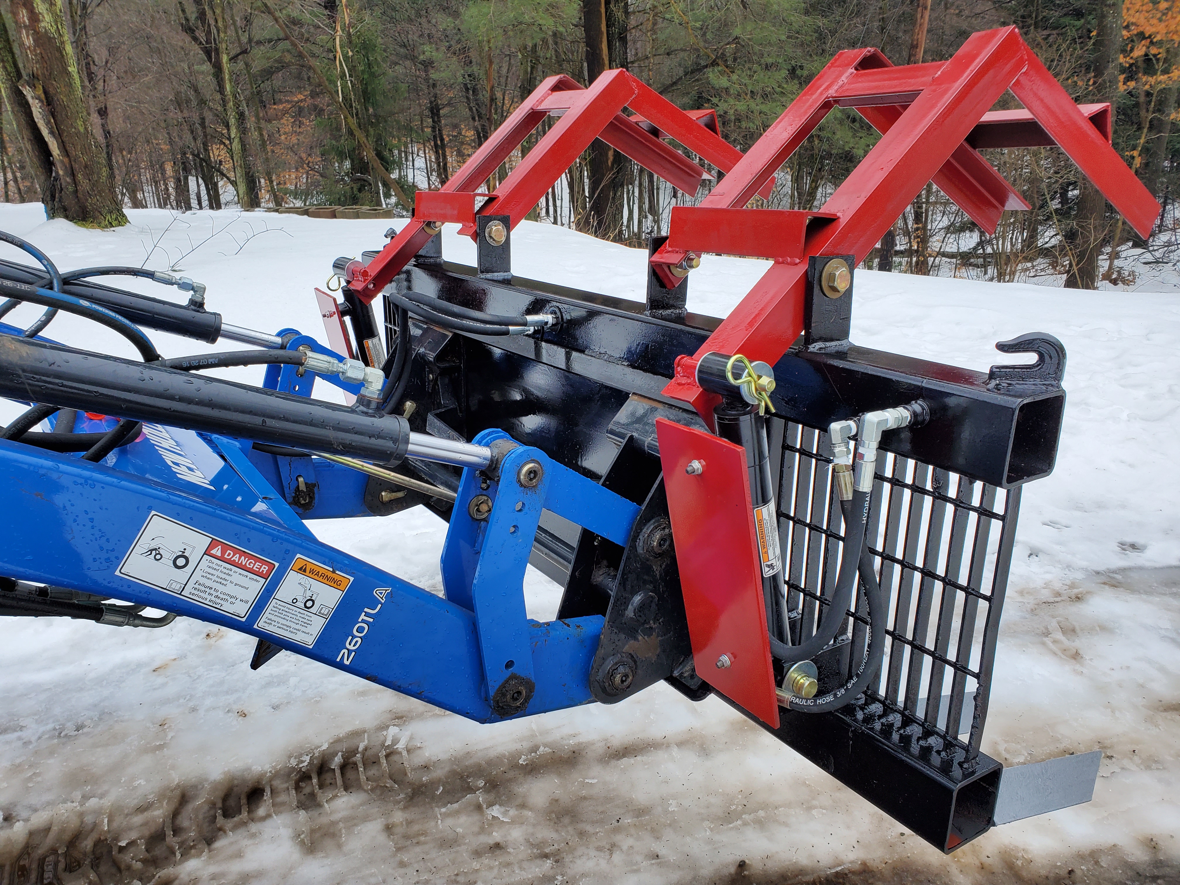

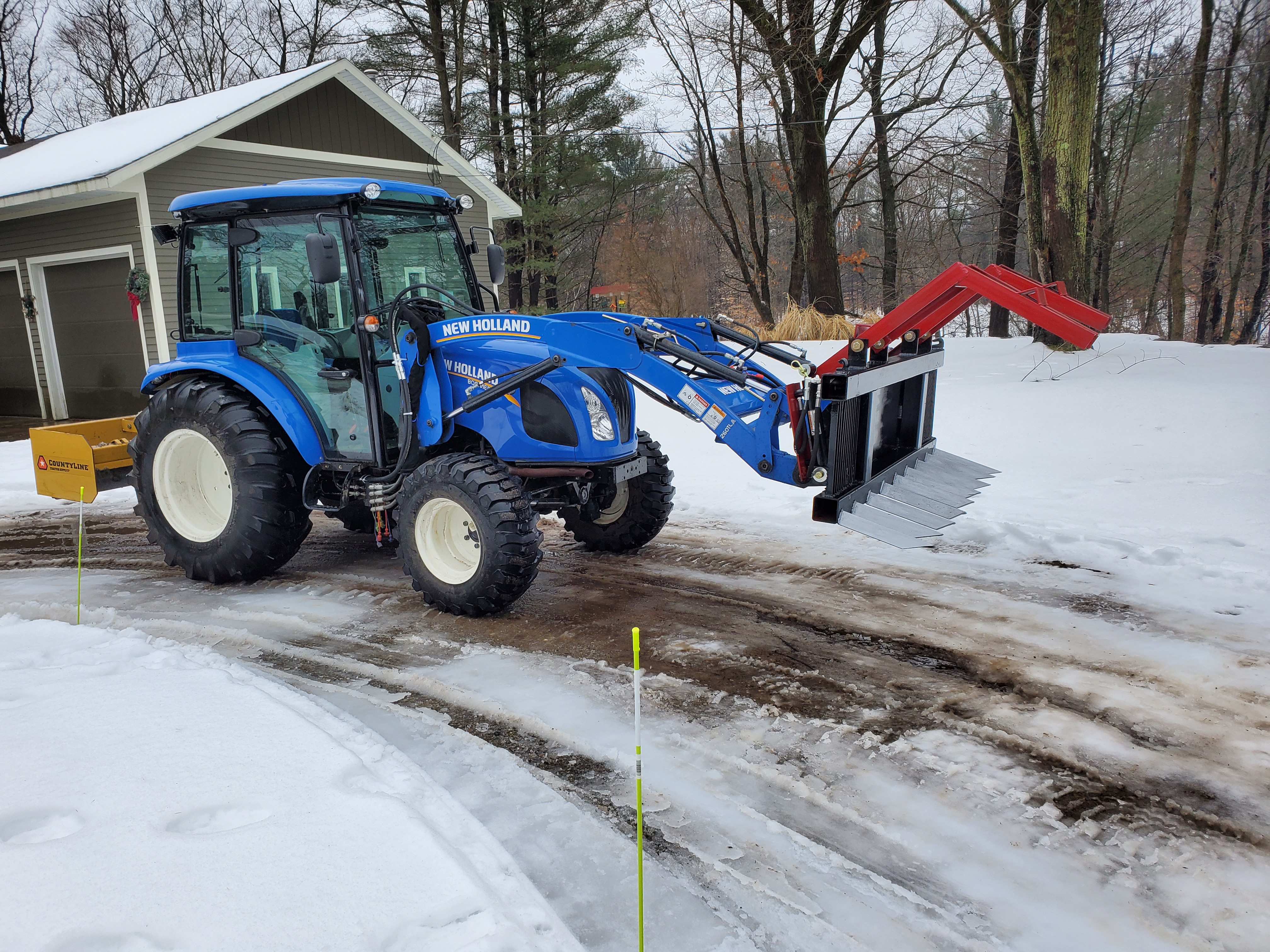

After looking at the prices and heavy weight of brush grapples, I decided to make one that slides onto a quick attach plate just like pallet forks. The entire cost with disposables is still under $300. The weight is still light enough to not effect the lift capacity of a smaller tractor. It can also scale up to two grapples for one on each side of the frame.

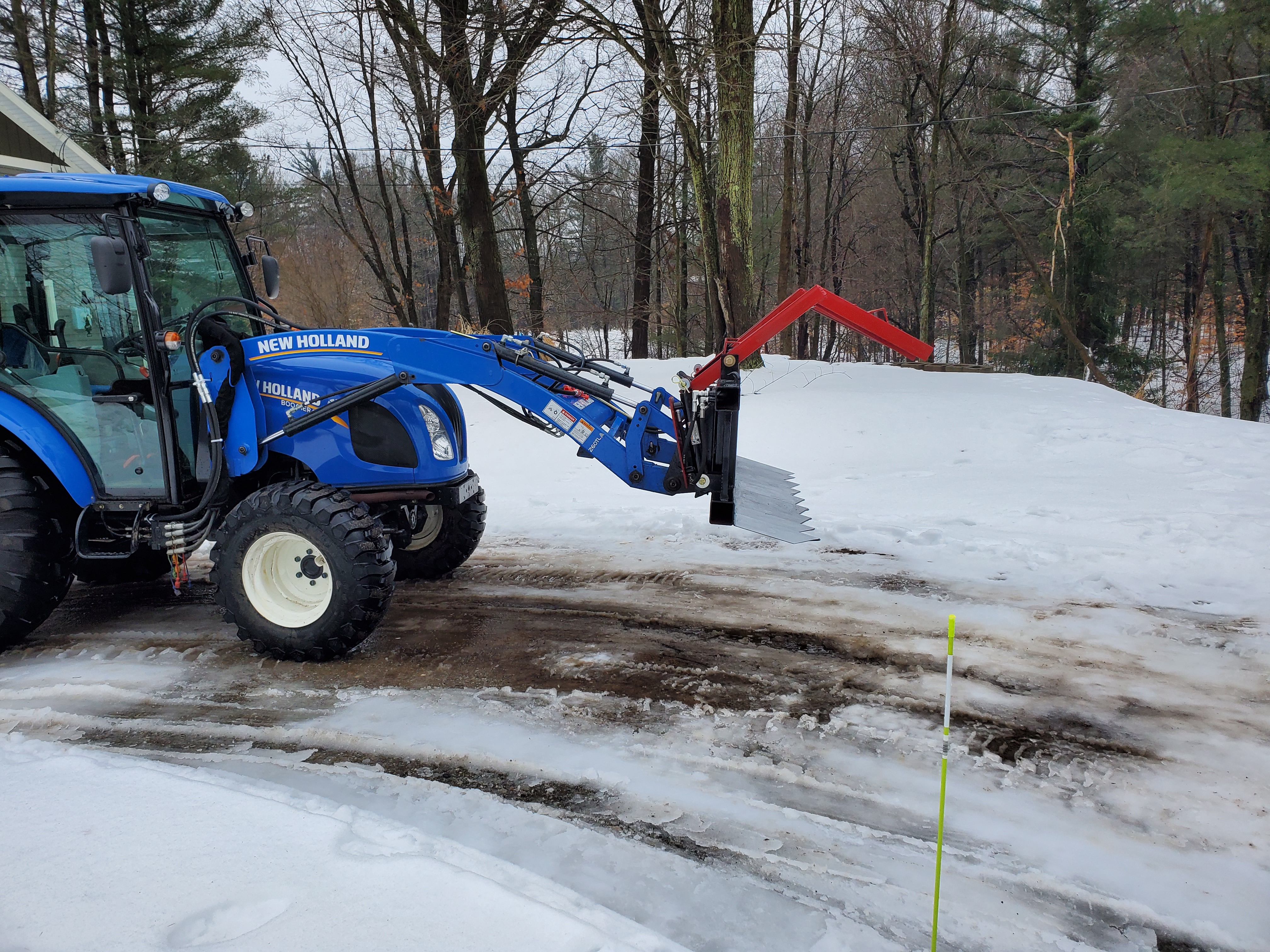

Grapple works decent for larger piles. Smaller piles fall through as expected. The only problem I had with it was getting my woman to stop playing with it so I could check the keeper pins.
I need to add another mounting point lower on the vertical mount. This will take care of the smaller piles.

Yeah, I would like to see that too. It seems like a nice option for those of us with older machines that dont want to do a full 3rd function upgrade. I also like that it is button activated instead of splitting a function, so you can curl and close the grapple at the same time.

Looks like an interesting approach. I've found that the more you use a grapple, the more abused they become. If you remember to take it slow, not try to do too much, and be extra careful, this might work for you. If not, version 2 should be even more interesting.

I think a dedicated brush grapple for round two will be designed for more abuse. Possible with crunch and compact in mind for grabbing piles that are unwieldy.

The first grapple fits it's design criteria. Lightweight to not impact overall lift capacity. Easy to install or remove. Modular to fit neighbors pallet forks. The hydraulic cylinder is easily moved to a larger grapple.
