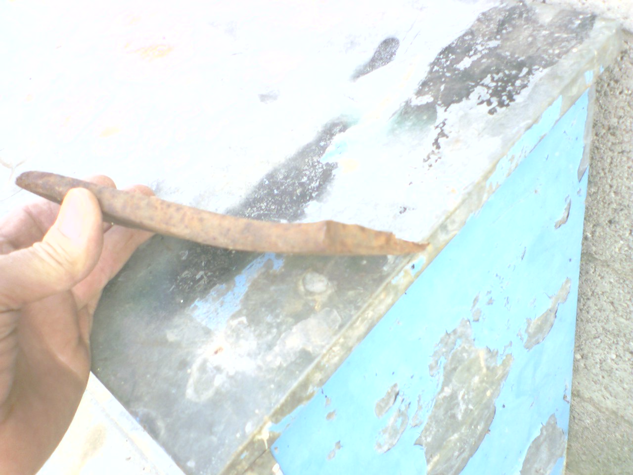

In 1992 my next door neighbor ,who is an experience responsible farmer with 160 acres stop me in my field while i was mowing and asked if I and everyone in my household was alright. he wanted me to stop at that moment and go check.. I could see the concern on his face as he explained that he snapped a 84" hog blade about 10" off the end and he thought the flight path took it towards my house 1/4 mile away . Like I said he looked very concerned and he was not the kind of follow to joke so I checked and evryone was ok.he relaxed a little and said if I noticed any damage to anything let him know so we could work some thing out .. Nice guy..I, over the nexk year or so kept an eye out for the piece and never found it..and forgot all about it untill this past spring... I was rototilling a "new" food plot/garden area behind my house and KADANG:shocked:did not sound like a rock for sure .After picking the peice up and looking at it I was like damb he was right ... it flew about 485 feet landing about 70 feet from the house WOW!!! be very careful out there!! here is a pic of the piece

That blade looks worn thin, and probably some fatigue plays its parts here.

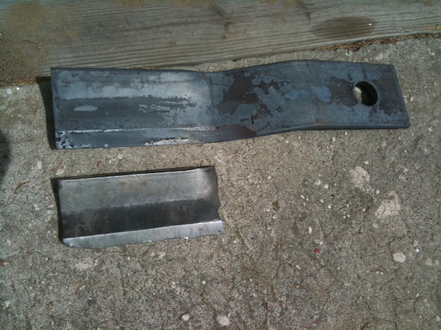

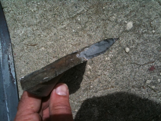

I was bush hogging by backing into brush yesterday when I heard a "wham" and then lots of vibration from my Woods 600 Brush Bull. I stopped and checked under the mower (and saw the rock I'd hit). A six inch piece of the blade had broken off. Luckily it was sitting about four feet away rather than shooting off towards nearby houses.
When I checked the piece I noted that the fresh fracture was actually only about an inch of the 4 inch by half inch blade. The blade must have been fractured some other time in the past.
I have another set of blades so will install those and then double check the slip clutch (which was reset this spring). I suspect the combination of the previously partially fractured blade and the sudden shock of hitting a fair sized rock (forty pounds or so) simply completed the fracture so the slip clutch was not at fault.
Photo shows the broken surface of the blade tip and the other shows the recovered piece next to the new replacement blade.
Questions:
1) Do any of you check blades for cracks regularly? If so how?
2) Do you guys always replace blades as pairs? Is there any benefit to holding on to the unbroken older partner blade to use as a spare down the road or are "mismatched" blades a risk. Both original and replacement are Woods brand.

If you replace one blade then you replace both of them. If not you could get it off balance and end up damaging the gearbox.
