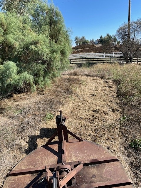

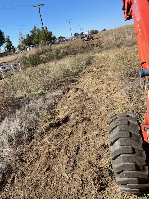

Chain mower test.
Before and after

#137
It cut weeds, small trees, and broke rocks. Seemed to run best about 480-500 rpms ( I'm guessing) There was some unwanted vibration at full 540 rpm per my rpm indicator. So backing off a bit gave the same cut and mulch without so much vibration. The good news is there are no leaks! That seal was a biotch to replace.
She is a very solid tool. I dare the weeds to grow :LOL:
I'm using 70 grade 3/8th chain which did not show alot of wear in our little test. I think the harder the better on the chain. Nothing flew out the front so the curtain is working as designed. I may have had the mower a little low.
All in all we're happy so far.
