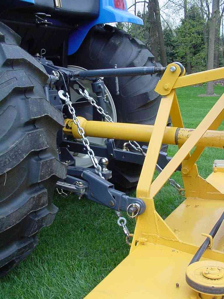

Check chains are the ultimate way to provide consistant trailing at a constant level. As set up, the top link floats and the front of the deck rides with the rear wheels of the tractor - much steadier than any little 10-12 inch wheels. The pic attached is of a rear deck, but a brush hog would be set up exactly the same as far as the chains are concerned.

/ Brush Hog Positioning #15
I can see they would provide less up and down movement than the lower drag links since the connection to the tractor is closer/ahead of rear the wheels vs the being far out back like the drag link connection is. Especially if your land is nice and flat as shown in the background.
However, here's my take on that. If you have rough land and are mowing over swales like where the tractor was pointing down one side and the brush hog going up the other side, I'll bet you would still scalp the top of the swale somewhat. Maybe not so much a gentle swale, but sharper ones for sure. Not only that, but as the cutter passes over the top, the center of it gets closer to the ground. The only way to keep the cut constant height is to move the cutter up, using the front or rear or both...or get rid of the swales of course.

I also like the idea that you can use the check chains to quickly set the cutter back down to the elevation you intend - my 3pt height mechanism is kind of sticky for some reason that I'm not sure of yet.
djradz, your check chain assembly actually does not look bulky enough for my tractor/terrain/cutter weight. But it is a good setup that would not be difficult to fabricate. Easy to see how I would simply use a larger chain and beefier attachment hardware. I pictured this not set onto the base of the cutter though, but up on the 3ph pin attachment, on the cutter.
