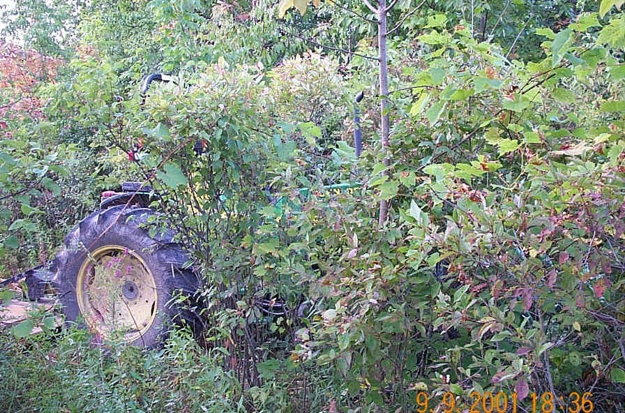

Brush hogging about a month ago and going home (Twilight time-all the tractor lights are OFF)...
(I used my flash on the camera and it picked up the reflective material on the tractor...)
{see attachment}

Hey, John, cool picture.
Three questions:
1. Are you still using that 39 cent camera or have you gotten an new one? What kind?
2. What kind of cutter is that with two back wheels? I think I need that for my near-Oozama cutting. It would halve the down pressure on each wheel track.
3. Are you a III or a 3, for goodness sake?

Hi Glenn...
My youngest daughter is now the current owner of my "el cheapo" digital camera... after the bug bite me... I bought a Kodak on my way to the ultimate digital (whichever that may be.... I'm sure it will end up being an Olympus... with min. 10x optical zoom and must be fast for sports action shots {my girls' basketball}-like successor to the E-100RS...?)
The rotary cutter is a Brown 7' with dual tailwheels... I believe adds greatly to the deck strength/structure durability for cutting the heavy duty stuff...
Lastly... I think on my birth certificate it says 3rd... but that's a long time ago... when God was a kid.... /w3tcompact/icons/wink.gif
