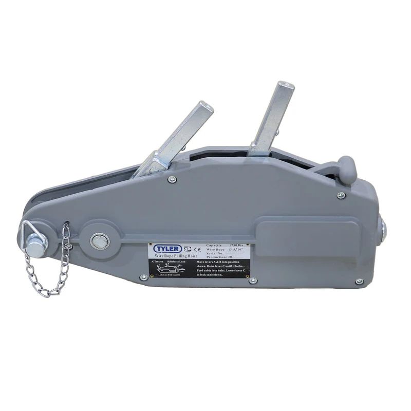

Stretch is room for variance... I've brought down several 60-80 ft trees with 1500lb lever chain hosts and chains. Most land within 5 ft of where I've anchored the hoist as long as there's enough tension that the change stops moving. Sleeping just a little bit of slack, either way can increase the distance where it would go left or right.
Pre loading a tree is asking for a barber's chair.
Not my idea of fun.
