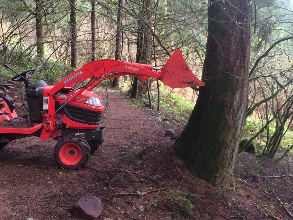

I've seen some videos where people say that they use their compact or scut tractor to push over trees. The base of trees can hop up as they fall, so I'm wondering about peoples experiences with doing this with a smaller tractor.
For an 8 or 10 inch diameter tree, maybe 60 feet or more tall,
Would it be safe to:
- notch the tree in the direction that I want it to fall
- start a back cut
- then use the front end loader to encourage the tree to fall in the desired direction
No, the proper tool is the chainsaw. Not worth putting more expensive equipment in the mix when proper cuts with the chainsaw is all you need.
Use the tractor for cleanup after.

There was an 80' fir tree next door, about 14" in diameter, that swayed a lot in the wind disturbing my satellite reception and I was concerned that it might come down on my house is a windstorm. I used a 40' ladder to loop a 3/8x60' chain around it, anchored to a larger tree base with a 2000 lb. come-along. I tracked down the owner of the vacant lot and got permission to remove it at my risk. I had planned to cut it with a chain saw, but when I started putting serious pressure on it I noticed the ground swelling on the back side. I kept pulling until it was laying on the ground. There were other large trees near by that made me comfortable knowing it could only go sideways so far.

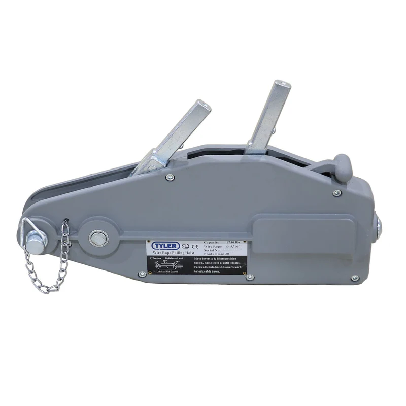

Don't think you are going to "pull down" or even direct the fall of any real tree with a typical hardware store come-along. They don't have the reach to do much more than take the slack out of the line.
A pair of those devices and good use of Prusiks can do the job. Much better is a cable "Cable Pull" or the like, as there is no spool capacity limit.
Good point, I did use two of them.

The maasadam rope puller usually has a 1500# line, because you're typically not trying to pull a tree out by its roots and don't want to be carrying around a ship hawser.
The rope puller gets a good pull in, puts a load on a tree, and has plenty of stretch so that when the tree starts moving, the rope is still pulling for quite a while - if you've got 100' of rope with a decent tension on it, it's got a good pull for easily 5-6'. A steel cable or winch line would go slack as soon as the tree starts moving and wouldn't any help at all beyond that point.
