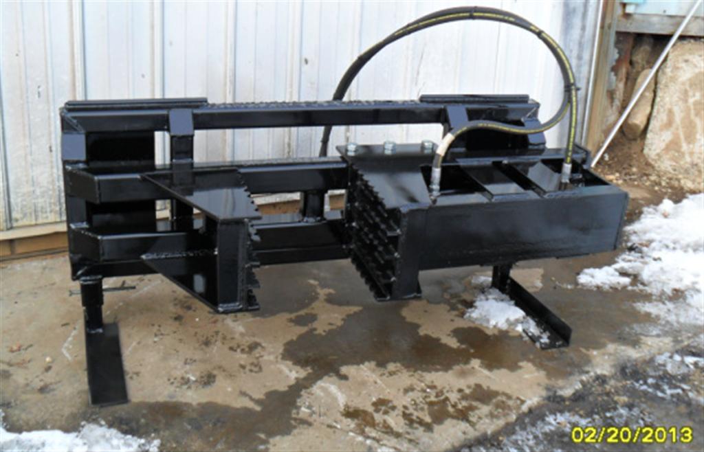

Try this one: Buckthorn Puller - Custom built Skid Steer attachments to fit almost any need you may have.

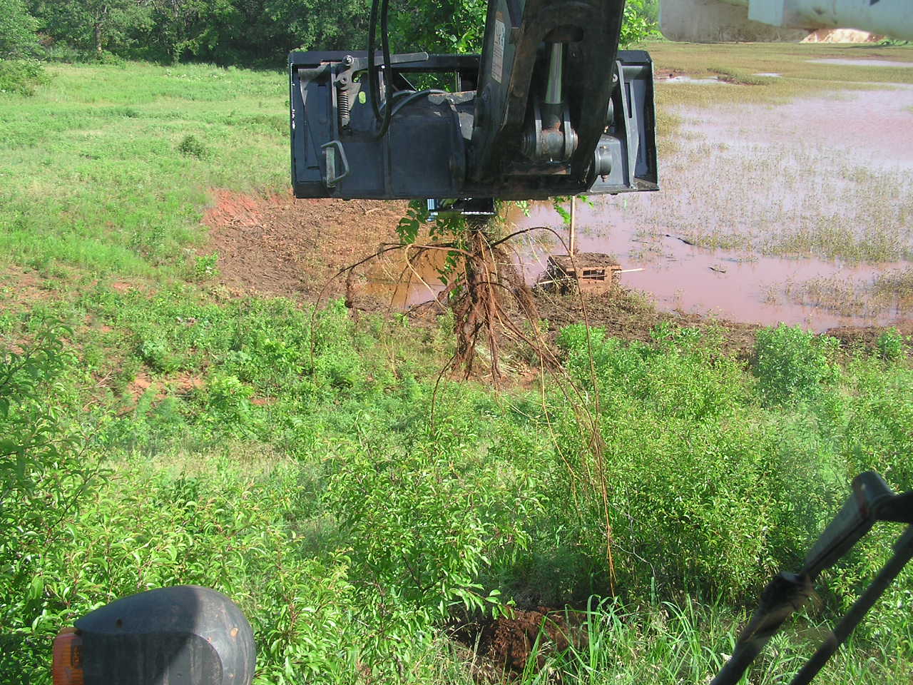

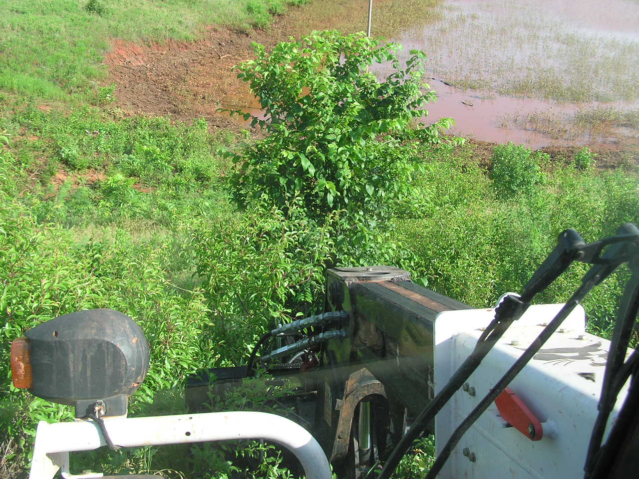

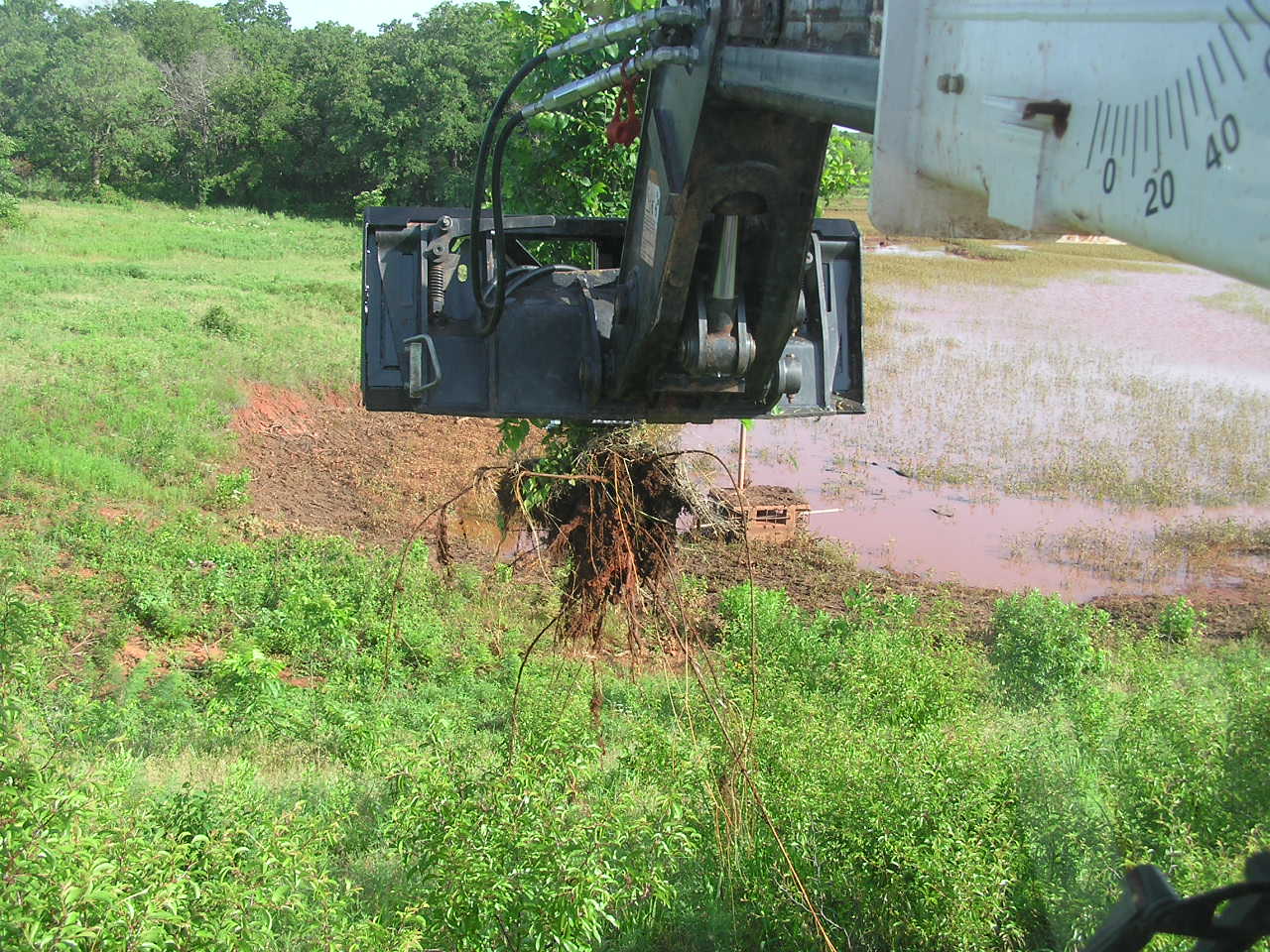

I was thinking of making something like that for the backhoe. Do you have one? How well do they work on small stuff ie. under 1 inch diameter?
Works great on small stuff. Mine is the Long Arm version:
Here is the view from the seat of it clamped on a small tree:
Pulled and shook the dirt off of the roots:
