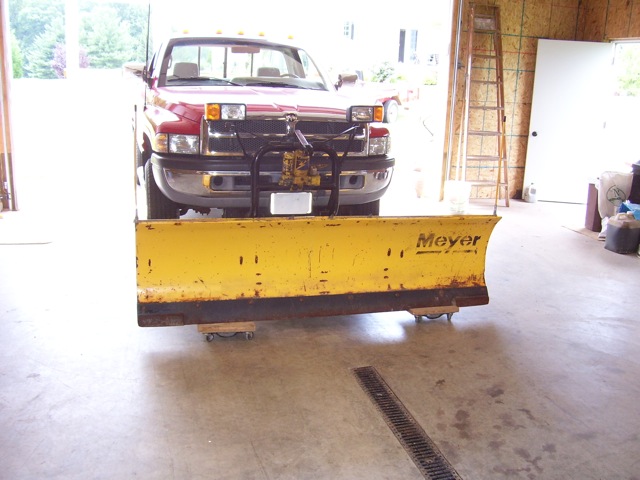

I'm pissed I'm wearing out my bucket edge plowing the snow in my driveway with my new tractor.
WaxMan, could you weld some 1/4", 3/8", or 1/2" thick strips of metal on each CORNER of your bucket, bottom side of course, to act as a sacrificial piece to protect the edge when plowing? It would only have to be maybe 1 1/2" or 2" wide. You would not be able to scrap completely down to the blacktop with these strips added but it would only leave a very small amount of snow on the driveway.
I did this to my Meyer snow plow when I had it on my truck. Welded a 3/4" thick piece on the front of the plow edge and it took the brunt of the abuse and my plow edge lasted forever. Just a thought. Stanley

WaxMan, here is a picture of the added pieces of steel to my Meyer plow in each corner. You need to look closely to see them. Like I said in my previous post yours would go on the bottom at each corner and wouldn't need to be as large.

Wear edges AND a channel drain in the garage...That's a thinkin' man right there. :thumbsup:
I see what you mean, I'll take a picture of what mine looks like and post it later.
You got me thinking though, what about a "one bolt" on disposable skid plate on each corner. Just a three inch disk with one bolt up though.
But on second thought it will probably leave gouges in the pavement, same with welding just on the edges. I think it would have to go across the full bottom.
