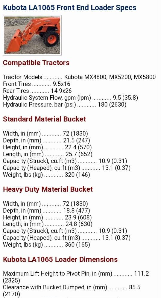

Depends on which bucket you have, here is a list for an earlier model, but the buckets should be the same.
Sent from my SM-G715U1 using TractorByNet mobile app

Two different numbers - struck vs heaped. About 1/3 yard for heaped.

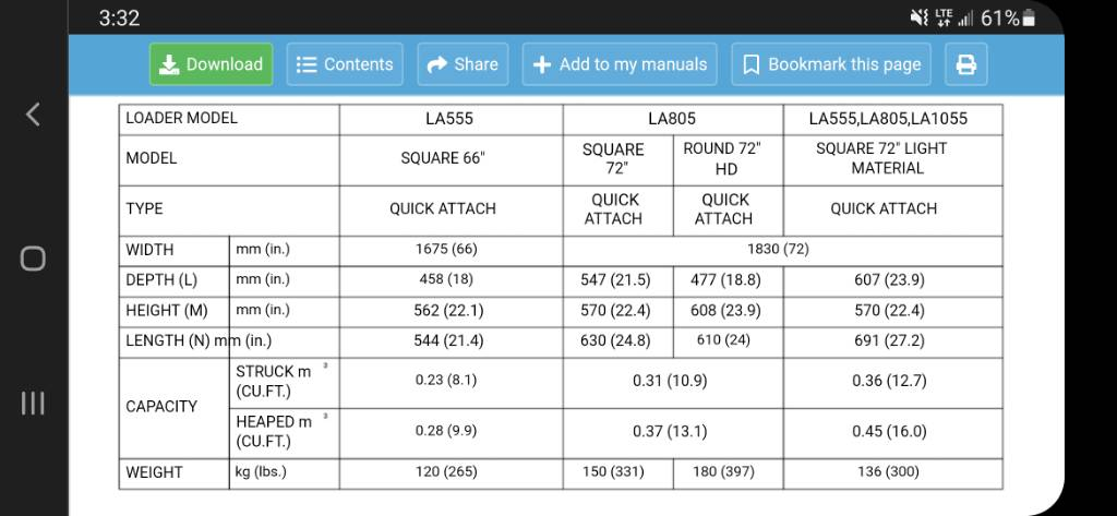

Do you have the loader manual? It will have the info in it, what bucket model do you have?

O-Tay. . . Great Info. Thanks a bunch. I’ve got to move a bunch of dirt. I’m gonna rent a small dump truck that says 2.5 to 3 yard capacity. So I needed to know for that.
