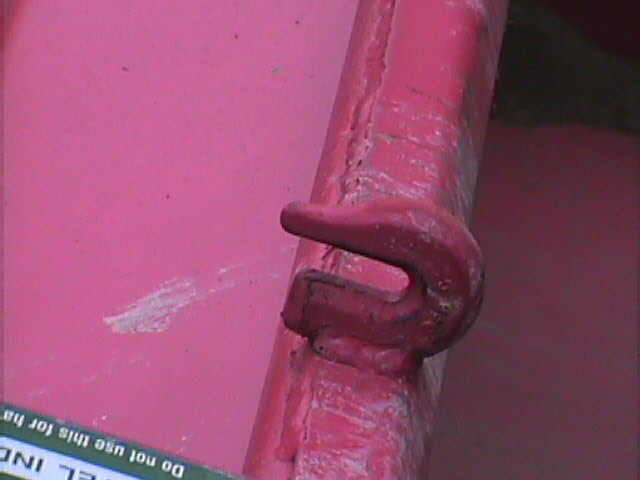

Anybody out there got pictures of how their bucket grab hooks are mounted? I'm getting ready to weld hooks but I'm not sure of the best location on the bucket to mount them.

Here is a photo of the hooks I just welded to my B2710. I used 5/16 hooks, as my loader can only pick up 880 lbs. Hope this helps you.

Von -- That's a really nice setup. Did you do it yourself? I don't weld, but am thinking of putting the bucket on the trailer and hauling it to a local shop to have something similar done. Before I do, is there anything you would have done differently?

I think that with the loader only being able to lift 880 lbs what I have will be perfect. I use a short piece of chain to run between the two hooks and then hang a chain in the center as needed. I just welded the hooks on with my mig welder. It took me all of 10 min.

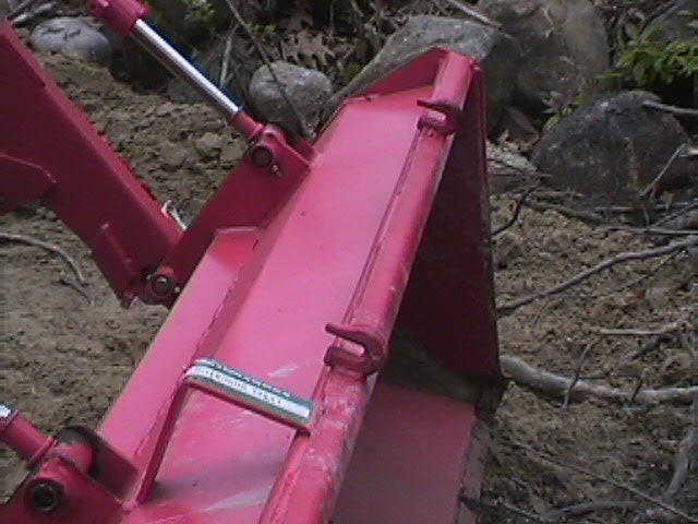

I have hooks on Jezebel. I had the dealership put them on. They welded a 3/4 inch thick piece of steel on top of the bucket for strengh and then welded the two hooks on. There about 1 foot in from the edge on each side. I will send you a picture when I get home.

Sorry for the delay.Here they are!
Jason
