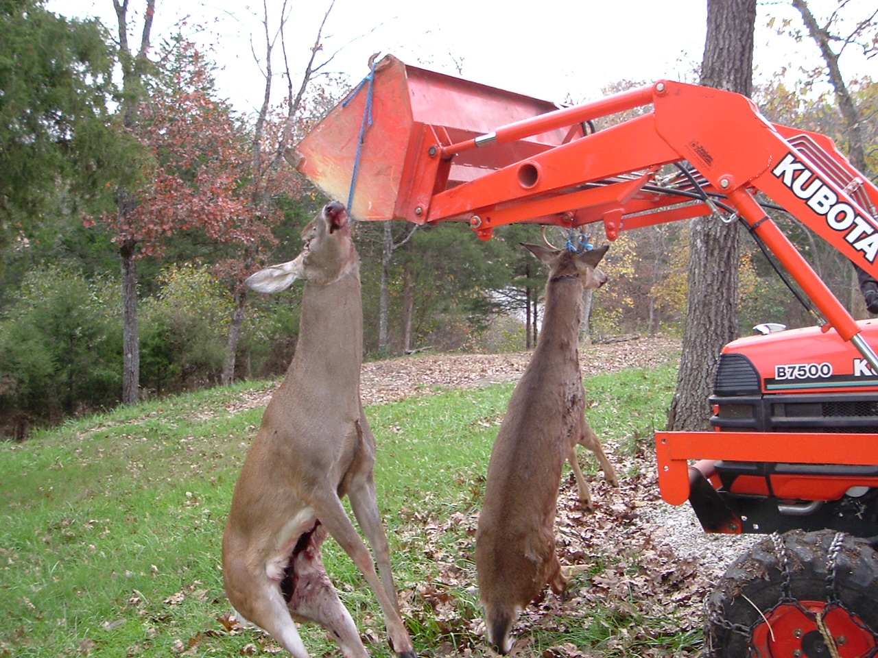

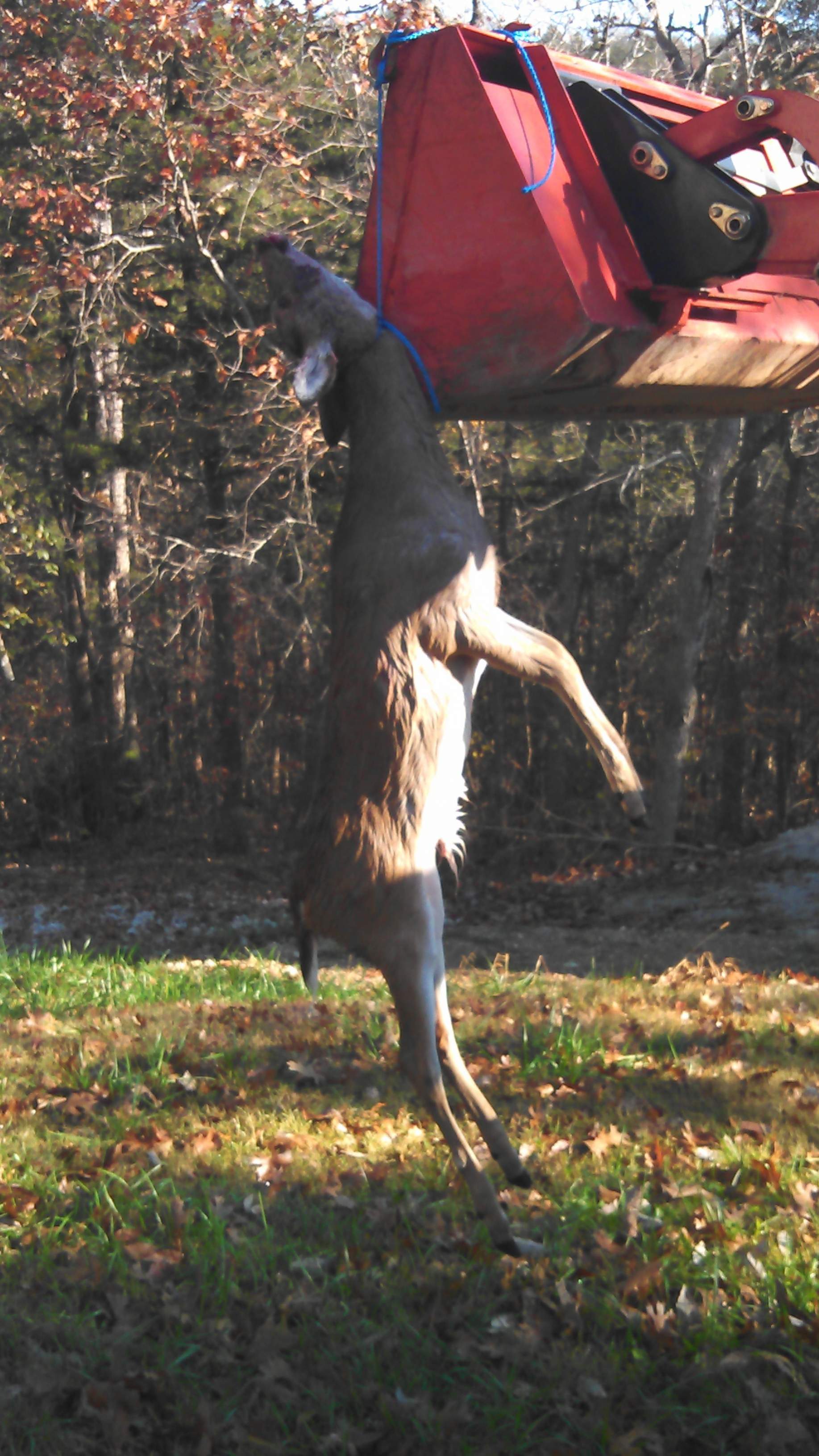

/ Bucket Hooks negatives #12
If you don't get hooks, this is what your bucket will look like.
Bruce

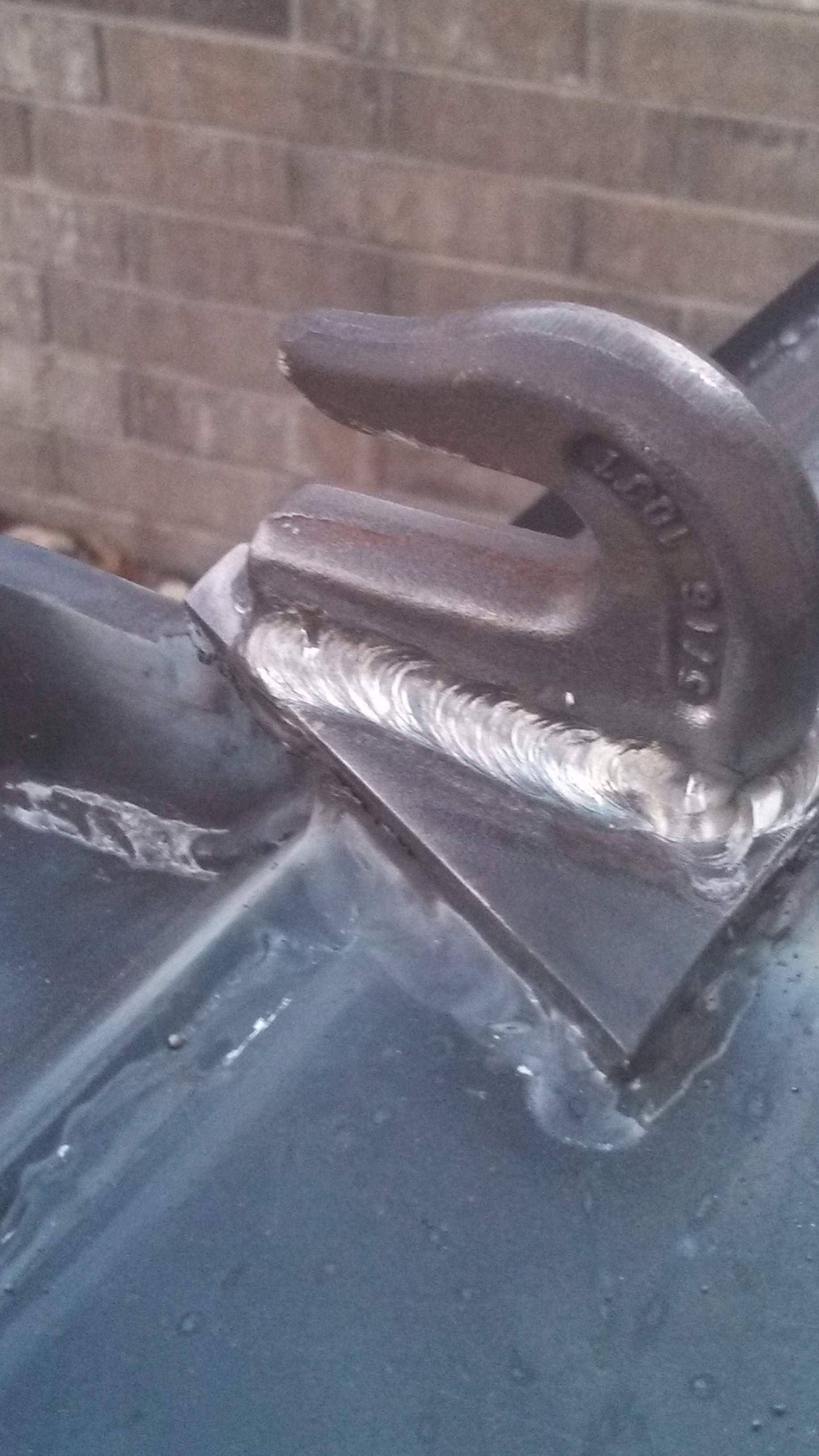

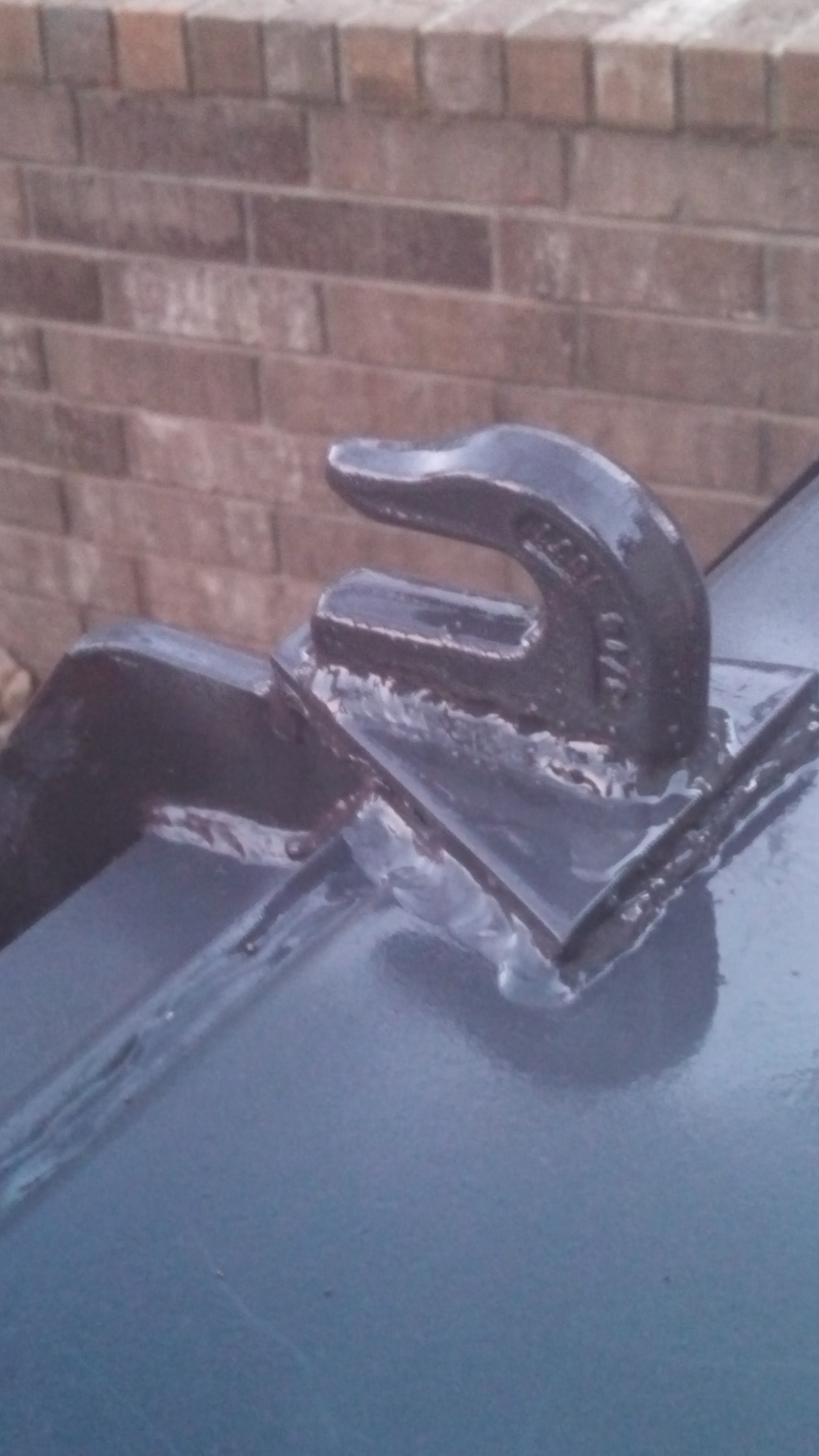

You do have to evaluate where the hook is to be placed and decide if you need to weld in some extra metal to reinforce that area. A simple L shaped piece going down to the bucket body will often suffice to reinforce the top edge to prevent bending that edge. Many buckets don't need any reinforcement but some do.
Yes the hooks in line with your loader arms is a good idea and use both hooks to center the weight of the load. Or the center of the bucket to prevent twisting of the bucket when lifting very heavy loads. Just use common sense in the placement and usage of hooks or rings. But then again you must really use common sense for everything you do with a tractor now don't you?:)

Try to line your hooks up with the FEL loader arms to reduce bending on the top of the bucket.
Something I learned - to avoid a potential negative:
Before you weld or drill holes, temporarily attach the hooks where you intend them to go with magnets, duct tape, whatever you have on hand.
Cycle the bucket through it's full curl range and check that the bolts don't interfere with anything.
On our L3240 I got very lucky after not doing this check.
I discovering about 3/8" clearance between the top of the hook & the cylinder rod at full rollback after everything was drilled and bolted together. Dodged a bullet - maybe more like a pellet - the point is, it would have been painful, had things been 1/2" different.
"Measure twice, drill once".

If you fear distorting your bucket from a center only hook it must be made of tin.
I welded my hook to a 3" X 4" X 1/4" scrap and then that to the backside of the top behind the upper lip.
Now I have tried lift heavy enough things to raise my loader rear clear off of the ground and my upper bucket edge is not distorted.
The hook backer plate was intended to avoid tear out and spread the load.
Another point that I considered was that centered between cylinders would evenly distribute the work load between the cylinders as well as deter any bucket distortion.
OK, occasionally I do lift from a corner from pure necessity but it can get scary real fast at times.
