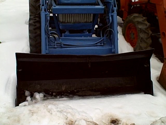

Here's another version of some serious bucket melt down due to a center hook.
