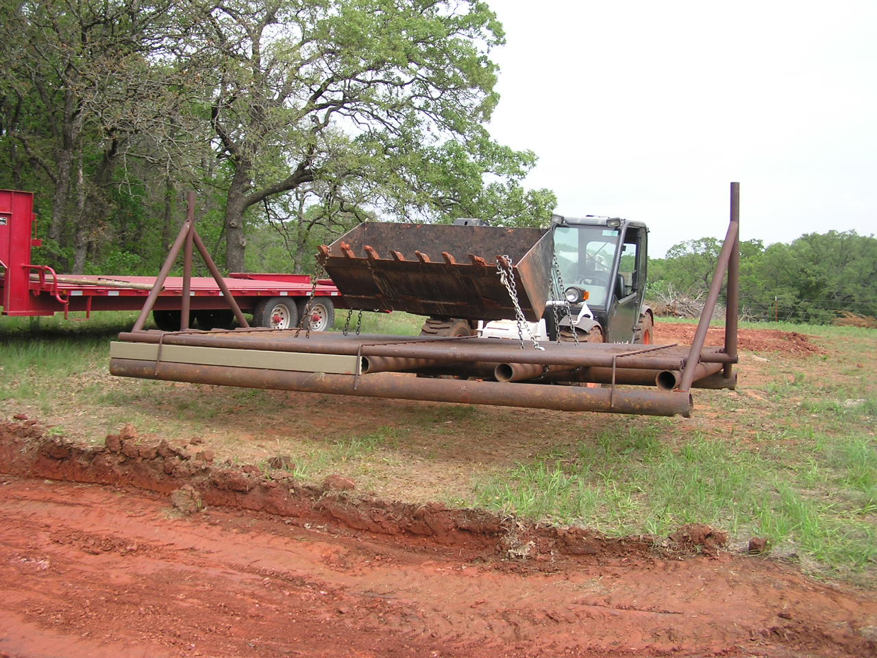

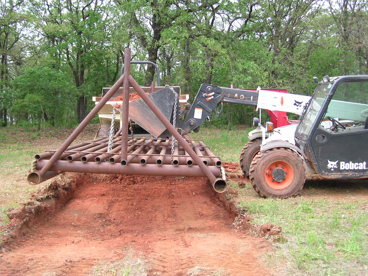

I don't have hooks on my bucket and don't have to worry about front clearance. I hook to the top and go down the back. Hook to the teeth for out front.
Setting a 16' pipe cattle guard.

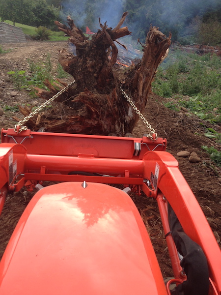

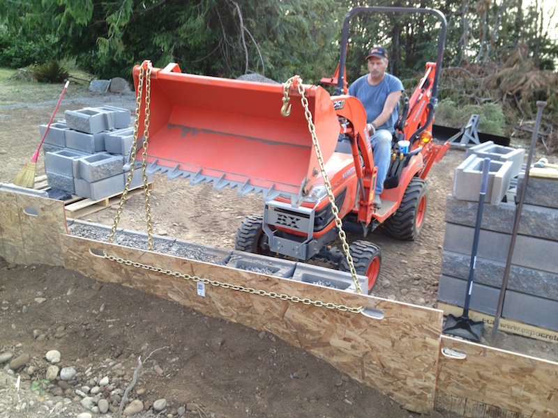

Personally, I am a fan of the BXpanded snap on hooks for my little guy. Adjustable placement in seconds. Remove them if they are ever in the way (never for me). Great for moving small stumps and other odd jobs. Second pic... I built some temp 2ft by 8ft plywood 'barriers' with handles to allow gravel fill behind retaining wall and back fill with dirt for the rest at about 1.5ft height at a time... lifting the forms up with the chain as I built the wall.
