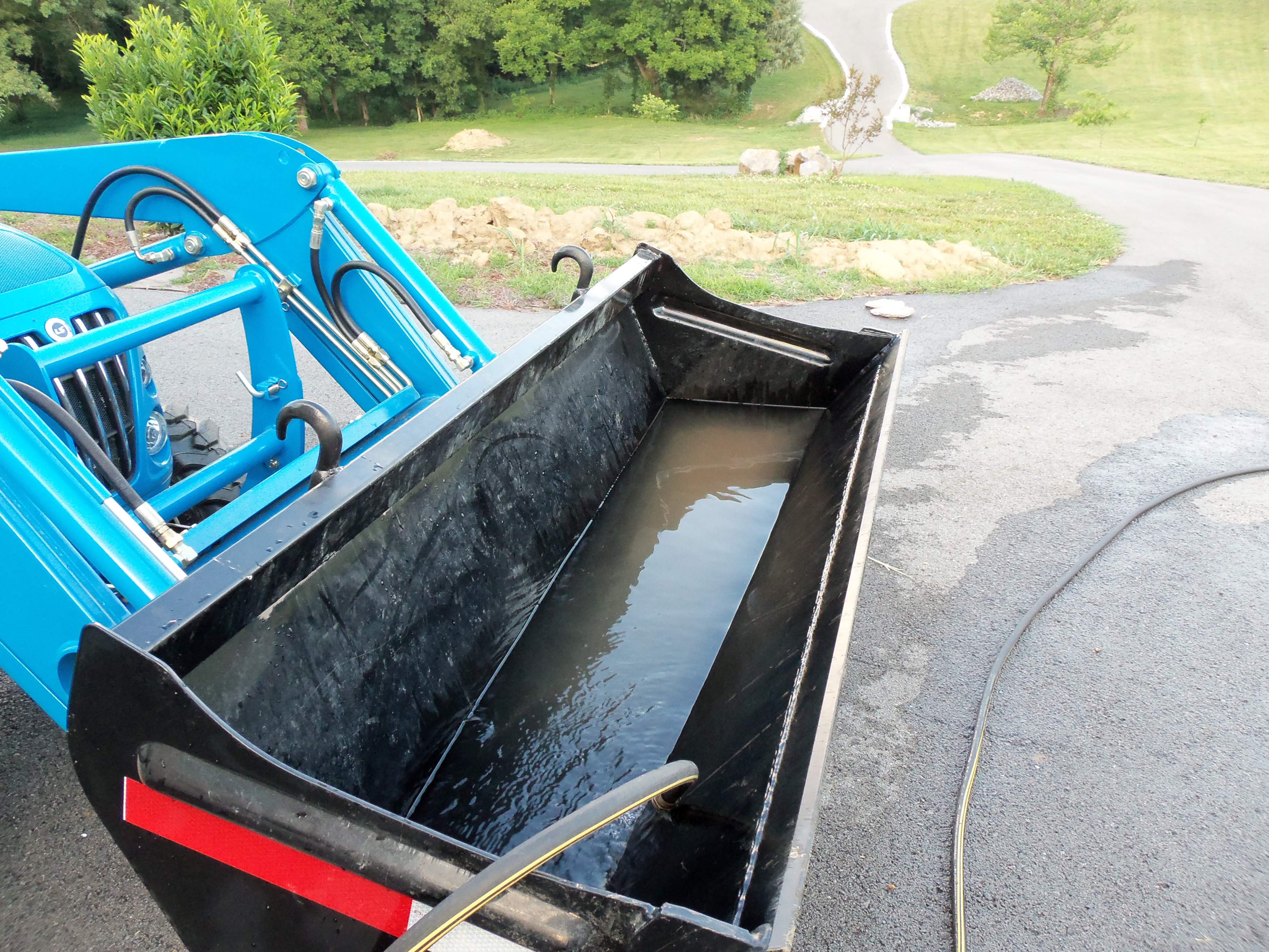

Randy, I had 2 hooks welded on the top of my bucket. The dealer did it for me, he said the top is thick enough to support them.

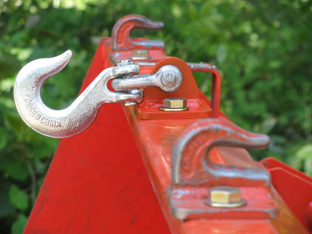

I have used Ken's bolt on grab hooks on bucket of my Kubota B3300SU (33-hp / 1,800 pounds) five days per week, just short of a year.
No issues. Excellent product.
Ken's hooks grab 1/4", 5/16" and 3/8" chain equally well. Ken sells backers as a service to his customers, even though he makes the case they are not necessary. I do not have the backers, just the washer sets provided. Hooks have been absolutely immobile, and zero deformation of the bucket. The man knows bucket hooks and how to make a quality product in Maryland, USA.
