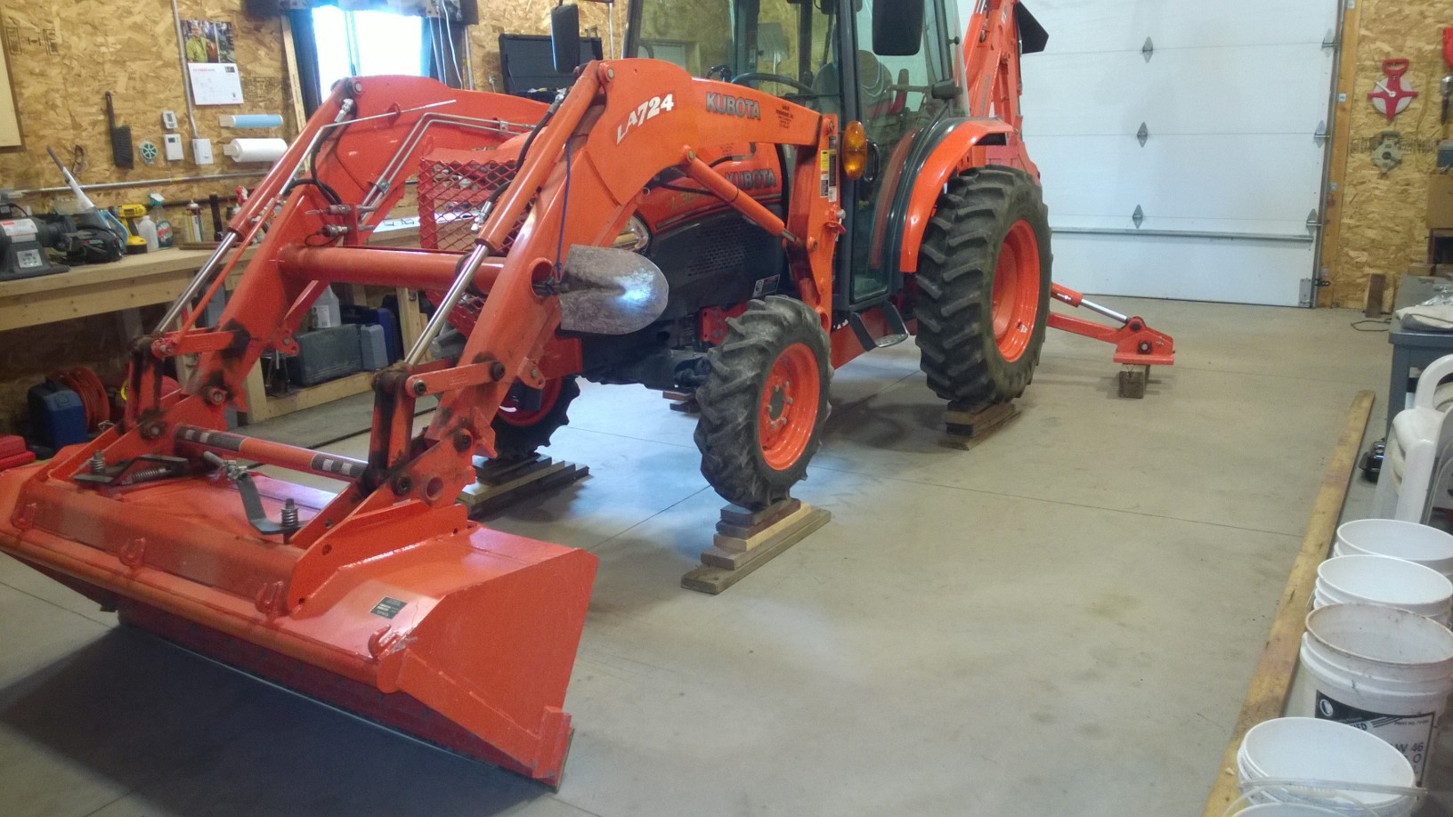

Attaching bucket hooks to a Kubota MX5400 with L2236 bucket

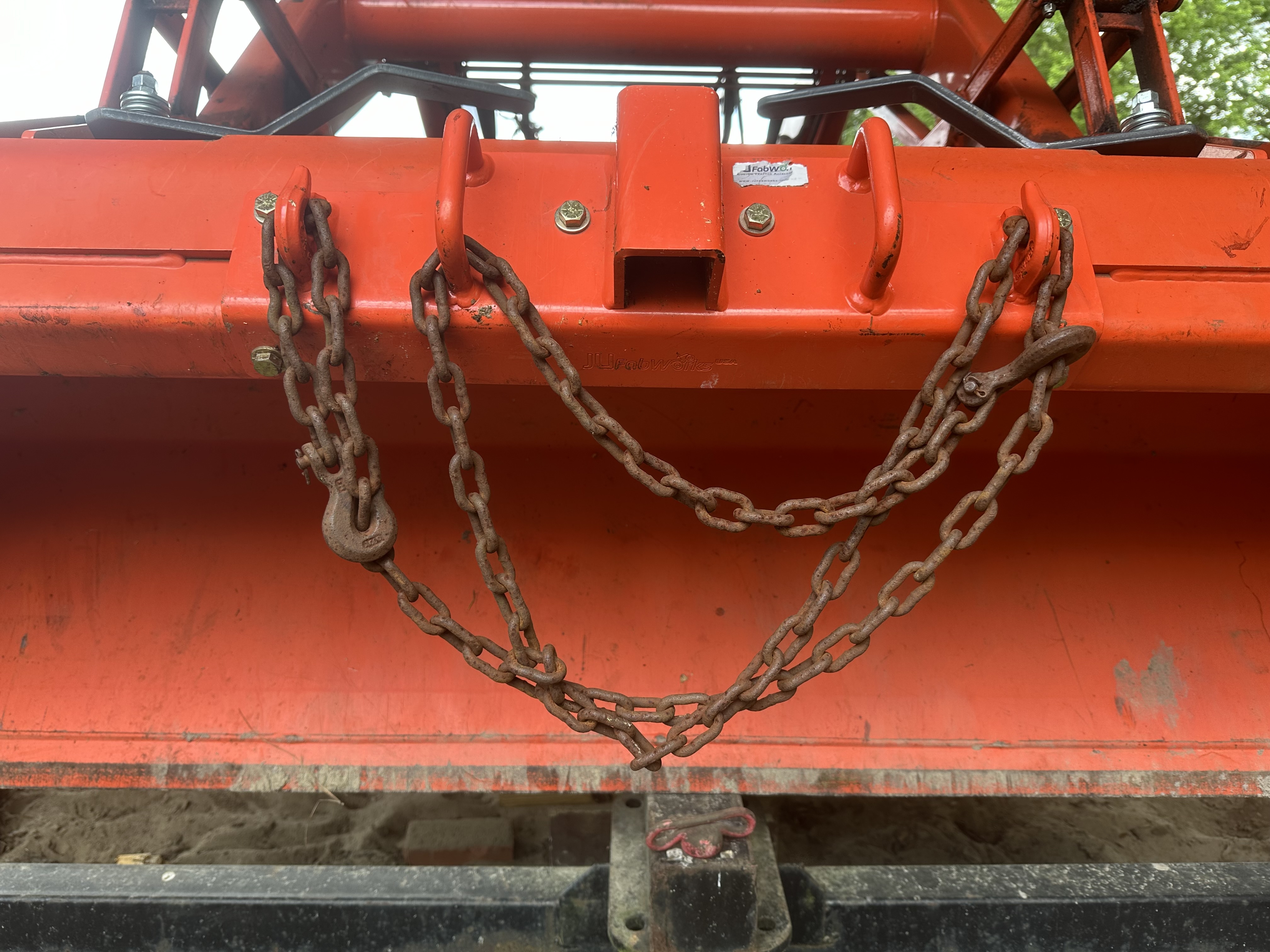

1st mod on my MX5200 was welding on bucket hooks. Bought em on Amazon.
That the best idea I’ve seen. I welded mine to the bucket
   / Attaching bucket hooks to a Kubota MX5400 with L2236 bucket #13
That looks like nice work. What do you do when the job nees ropes or straps instead of chains?
   / Attaching bucket hooks to a Kubota MX5400 with L2236 bucket #14
I have welded hooks in the same location. What I do is connect a short piece of chain to the two hooks, then attach some axle straps to the center of the chain. I can hook any strap to the D rings on the axle strap.

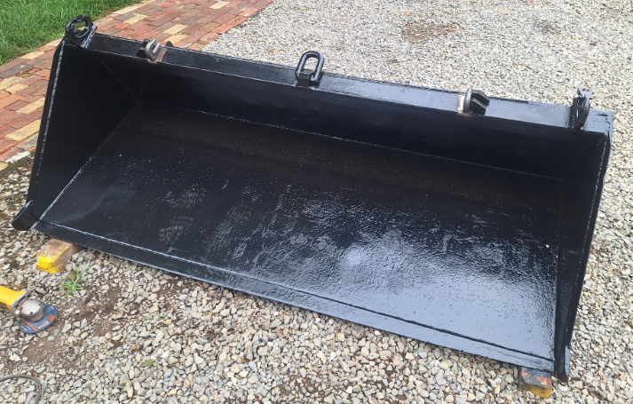

Agreed, and I've got some chain grab hooks with clevises for lifting & pulling. We use what fits the job. Sometimes chain, straps, or ropes. Being an old sailor, I probably use ropes more than most. So this last time I put some rope tie points onto the bucket as well. Much better for tying things in. Gotta say that after handling chains all day, handling rope is a pleasure.

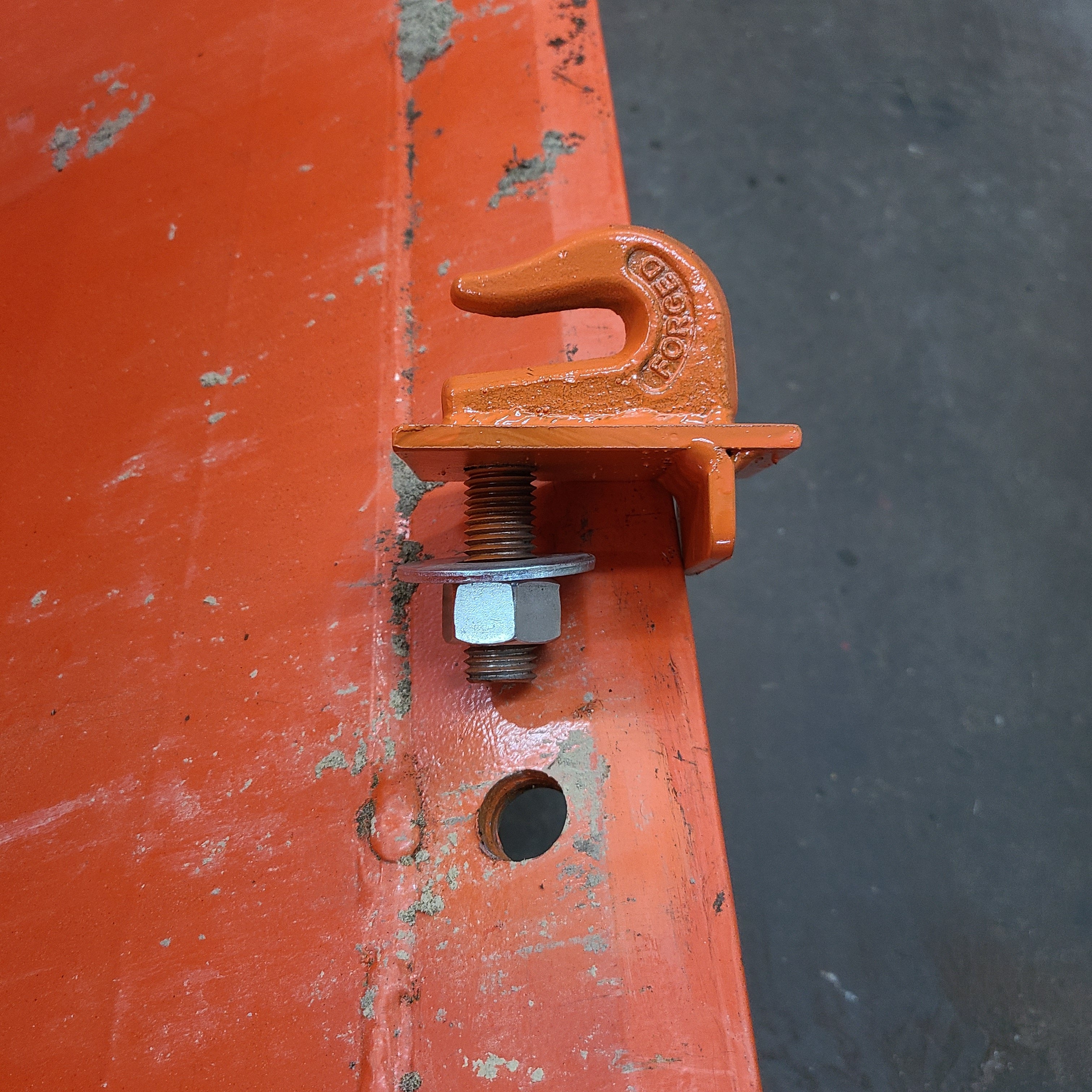

I'm not sure how/where to attach these. It is a curved back bucket but has a plate mounted on top between the loader connections. How are others with this bucket adding bucket hooks like Ken's bolt ons?

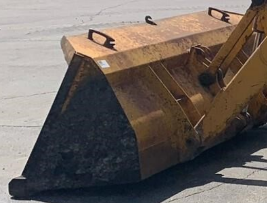

I welded on safety hooks 6" from the end. This is where the factory hooks on the Massey 20C bucket are. I then welded in 3/8" grab hooks in line with the outer edge of the skid steer quick attach plate. The prior owner had welded on the center ring. This is a Gehl skidsteer bucket with a heavy boxed upper lip so its strong enough to handle the loads. Below is a photo of me prepping to weld the grab hooks on.
These are the safety hooks I use.
I wish I could have found weldon hooks like these. MF and JD used them, this is on a 410C. They are a combined loop and on the back have a nice hook.

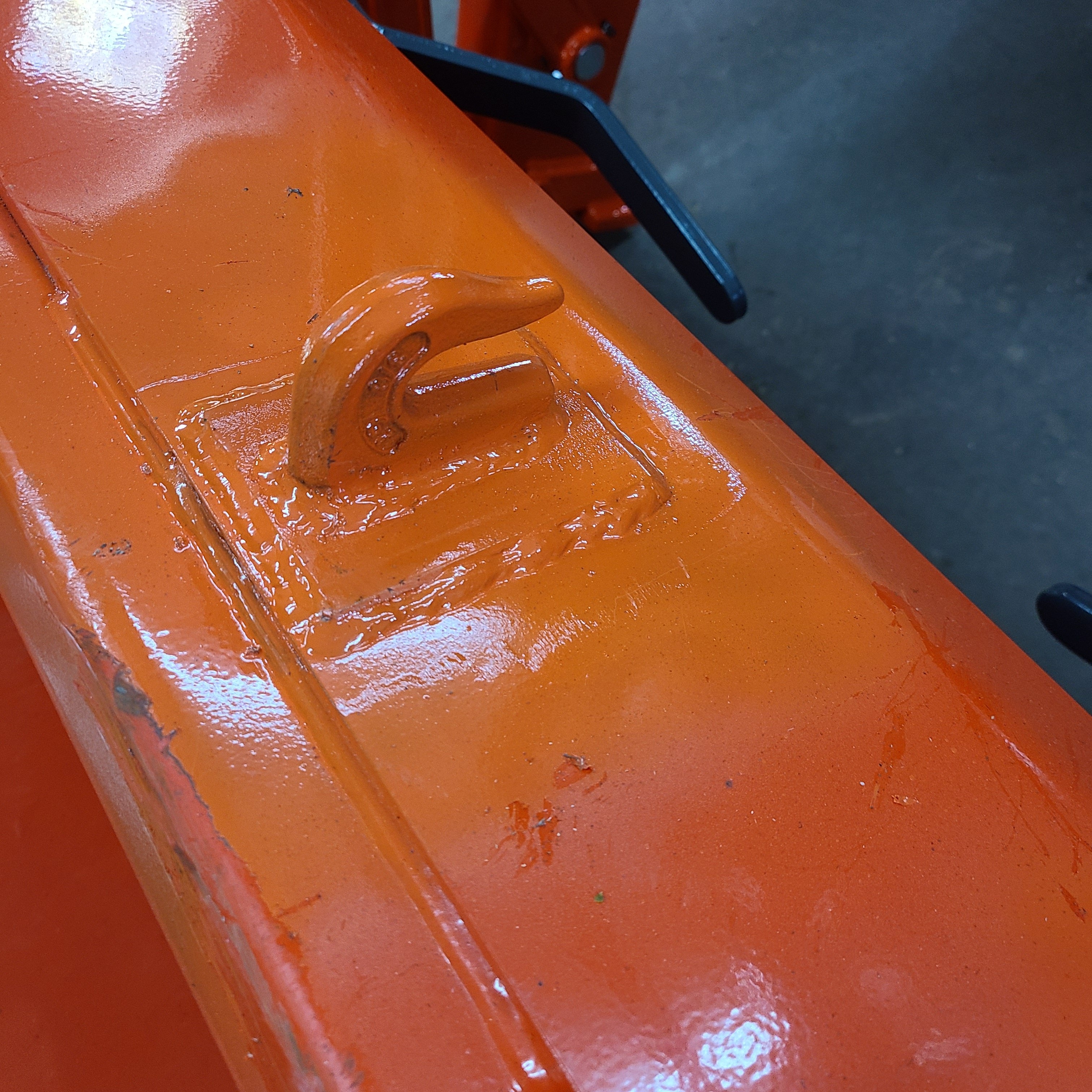

Here is what I did on my MX5400 bucket. Used weld on hooks on top. Welded to plate then plate welded to bucket. Also drilled hole in center of cutting edge and fabbed a hook that can be mounted there. I also can mount a hitch ball there to very easily move trailers around.

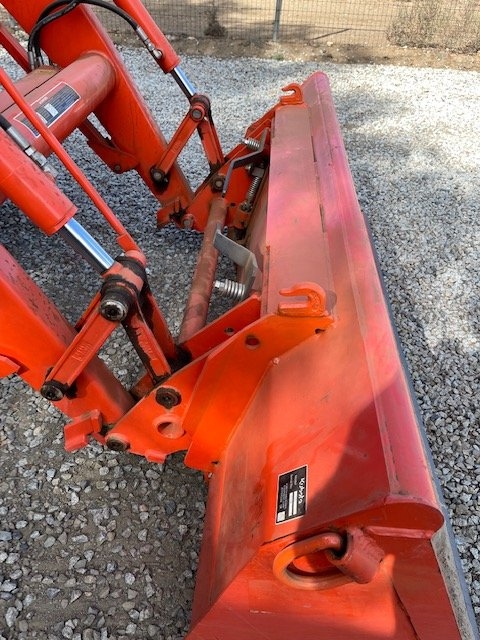

I put hooks on the bucket too MX5200
