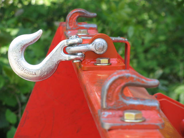

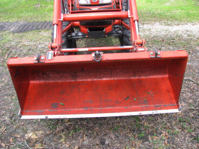

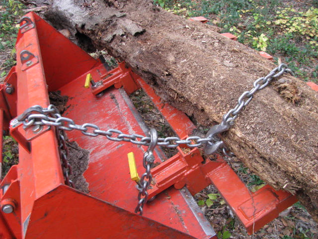

Get some Weld on hooks, put them in line with the loader arms, and reinforce the top lip of the bucket if needed with an L shaped bracket to keep if from being compressed or extended. On the Kubota bucket shown, I put a piece of steel that goes the entire length. but on the Kioti bucket it was already supported, and a pad was already provided to weld the hooks too.

Ok thanks guys. Some say to add 3. Two in line with the arms and 1 in the middle. Agree?
Thats good, or what some do is add a 2 inch receiver and then you can put a hook, a ring or the anchor for a boom pole, or any number of other things in the center. Anything you can think of that will fit a 2 inch receiver can be put on in a few seconds.

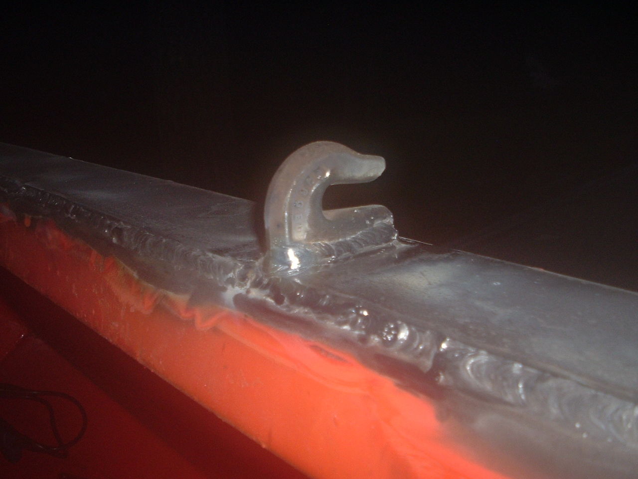

I agree with k0ua. Put a 2 inch receiver tube in the middle. I keep a GN hitch ball mount in mine. A boom pole can also go in that spot for hanging trusses. Or you can leave a hook in the tube. When am lifting a really heavy object, I just wrap the chain around the 2 inch receiver tube and ball mount.
This AFTER I welded a 3/8th inch thick angle iron across the whole span of the top lip.
