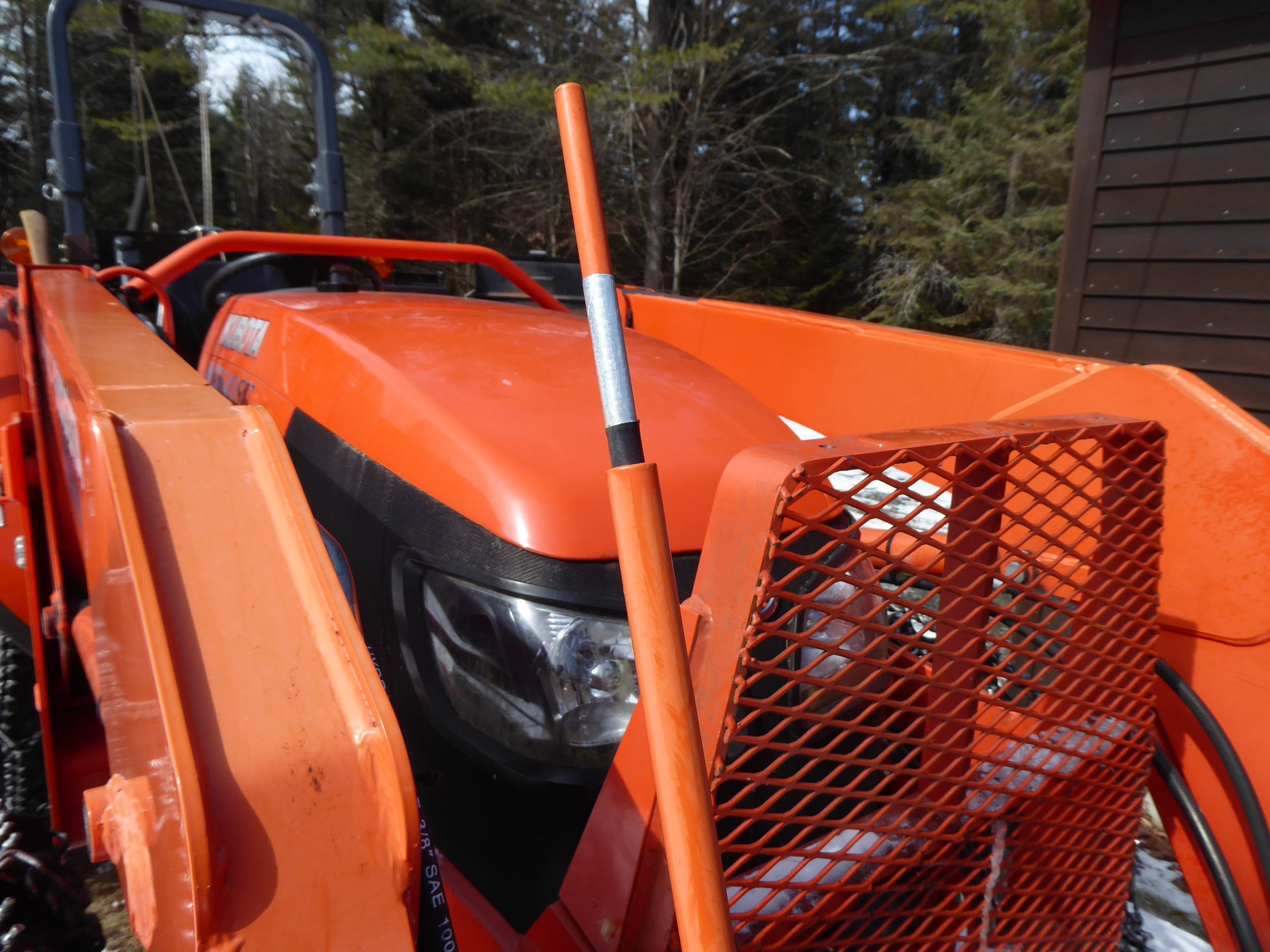

I use mine too. Especially setting my snow plow so that the plow frame is level. That way when I angle the blade the cutting edge stays flat on the road. I use it with the grapple too. I put a band of aluminum tape on it that marks the range that I can open/close the log grapple w/o digging up the ground and getting a bunch of dirt or sod. The bucket and snow plow are level at the blk/slvr line. The black heat shrink holds the rod away enough so that the aluminum tape does not get scraped off by the tube edge and is tough enough to stand the rubbing.
gg
Heavy Duty! Like it!

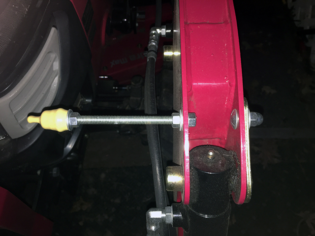

Yep, often. My little Mahindra Max 24 has no kit that will work like the greens and blues, so I made my own. Using a 1/4" round steel threaded rod (from Menards), I cut and bracketed one on the back of the loader (see pics) and one on the upper hydraulic operating arm (see pics), adjustments made by red nuts and yellow caps.
All I have to do is visually align both yellow caps or both red nuts (depending on if the bucket is on the ground or vertical), and my bucket is level. I use it often

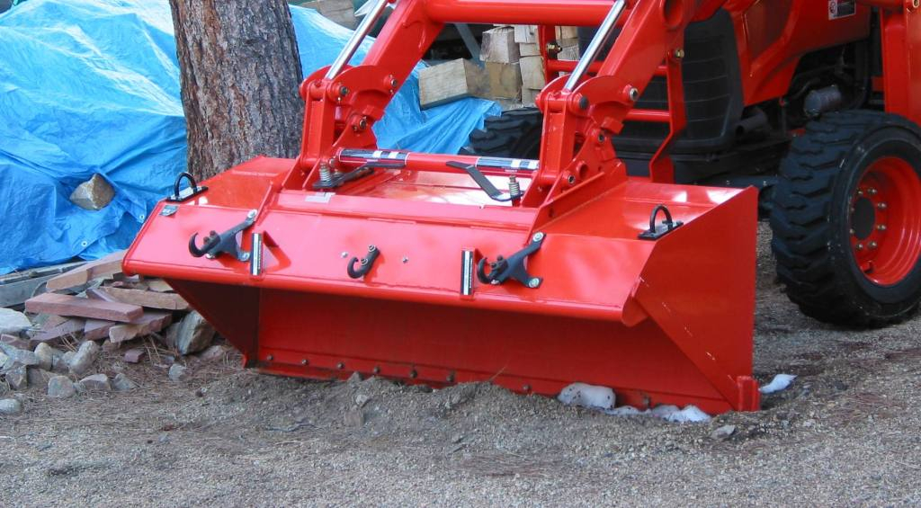

Our Kubota FEL bucket came from the factory with two 4x1" pieces of metal welded to the top of the bucket and covered with black & white reflective tape.
You can see them in the photo
I wondered what in the heck they were. They were strong enough to stand on, but not really strong enough to act as a chain hook. Then one day I realized that they wereset at exactly the same angle as the bottom of the bucket and situated so that one or the two can always be seen.
I will just be damned. Just shoot me. I am going to admit something here. I did notice they were even with the bucket. But I did not notice they were even with the bucket and to freaking use them, you idiot. Geesh. I even put a bucket level indicator on mine too. What an idiot. No wonder I climbed up on the back of the backhoe to avoid getting stung by a wasp. I am an idiot. Wait. Now I realize even that has been obvious and plain to see the whole time and yet I have not noticed it, the I am an idiot part. Why did no one think to tell me? Could have saved me a lot of pain. I would never have trusted me had I known that.......
