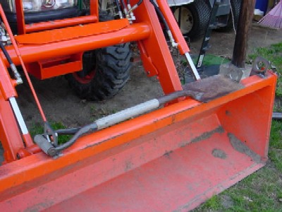

For you, Bob. Use optional "BS" to secure in place /forums/images/graemlins/grin.gif /forums/images/graemlins/grin.gif /forums/images/graemlins/grin.gif
It's kind of funny how my only D handle shovel fit right in there, though... Sometimes things work out without trying...
Actually, I like tossing my shovel and two rakes into the round cross-member between the FEL arms, but then I never have anyplace "skinny" I need to get into and the ones I use the most don't have D handles.

Where I am, I hit rocks when driving T posts, thus can't use an off bucket center driver. I do use a sleeve of pipe over a T post centered under the bucket... takes a buddy to hold it in position... and the length is set so that when the bottom of the sleeve hits the ground the post is at the right depth. The full length sleeve prevents bending/breaking when a rock is encountered (usually) and allows a little "pounding" on the T post with the bucket bottom. I put extra weight either in bucket or on front to assist in down pressure before front wheels come off the ground... and they WILL come off the ground when solid rock is hit.
