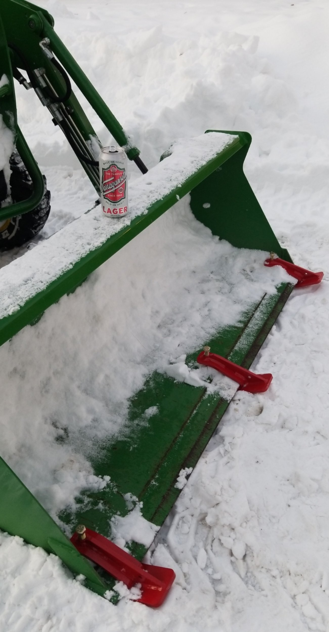

/ Bucket Shoes #28
Tractor Bucket Protector(Upgraded Version), 2Pcs Ski Edge Protector, Turf Tamer Skid Protector with Grade8.8 Double Lock Nuts and Bolts, Heavy Duty Steel for Snow Removal Spreading Gravel,Orange https://a.co/d/6k20ec2
4” wide, 10mm (0.39”) thick plate steel, 11.625” long. M10 1.5mm grade 8 bolts.
Going to weld some blocks to catch the back of the bucket cutting edges to help lock the ski in place.
Not as high quality at Edge Tamers might be but less than half the cost.

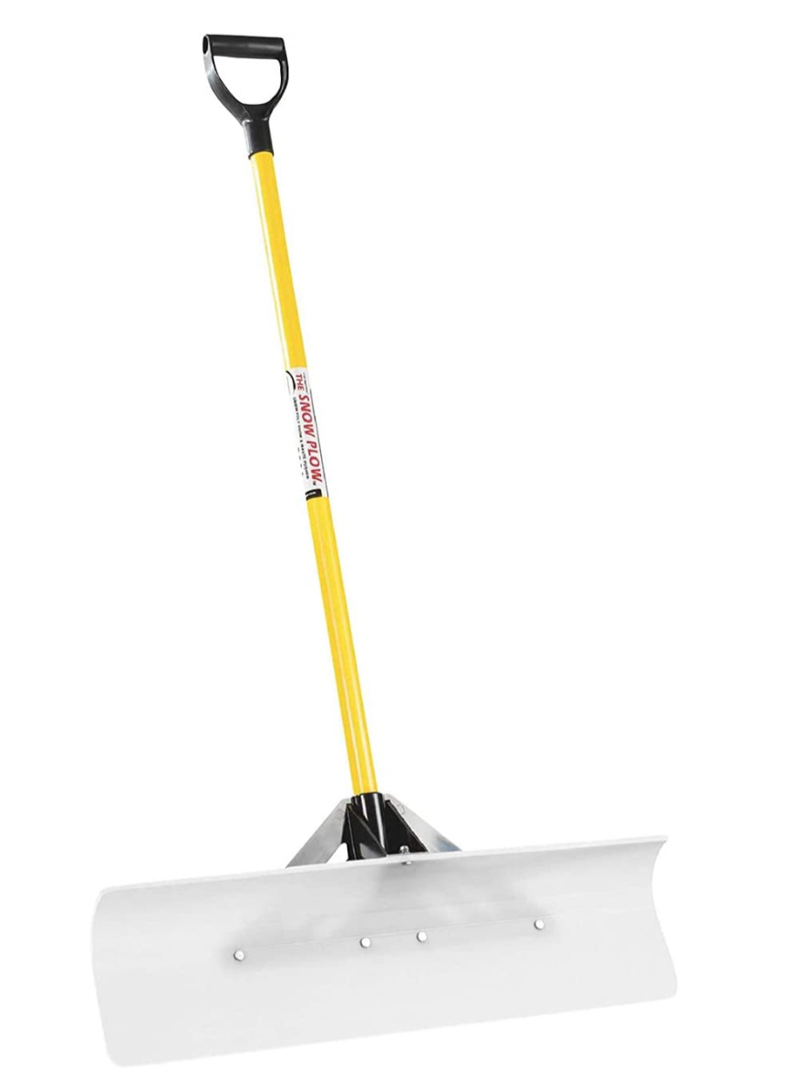

I plow 20 or so rural driveways and like to have options. The Edge Tamers are a great option for the occasional gravel drive I may be asked to do (none contracted), and after the rare deep snow that I would be pushing back piles or relocating snow.
My current options are:
Bucket with Edge Tamers
SSQA plow with polyethylene edge (steel available)
Rear plow with polyethylene edge (SAA)
Rear blower
Plow truck with steel edge
Ariens 30" blower
I'm also going to be testing a polyethylene hand shovel / plow that I've seen commercial guys using. I have a new elderly client that I don't want to see out shoveling her sidewalk and between cars.
As a hand snow pusher, that thing is awesome I could attest (2nd year with mine). Doesn't work great as a traditional shovel though, but that's not it's purpose.
/ Bucket Shoes #31
Actually I only paid $44.95 and what you
have looks just like the ones I purchased
from Vevor think they were on sale
willy
The ones I got are the improved two jam bolt per ski. Wrench included. They are pretty well made.
Saw a pair of Vevor single bolt with plastic knob skis for $36.37 amazon warehouse used (paint scratches) and bought to see the difference. Improving the bolt hardware a simple modification.
